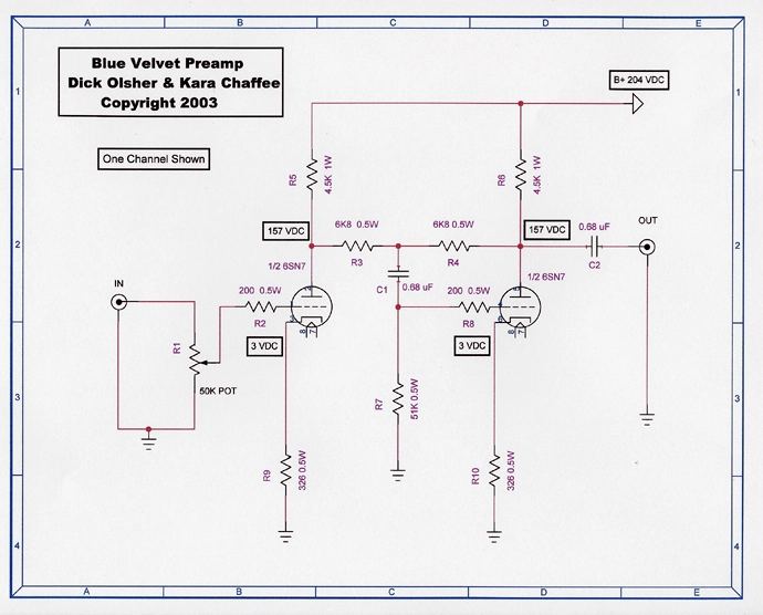

I need tube buffer or something like preamp with ECC82.
Thank you!
