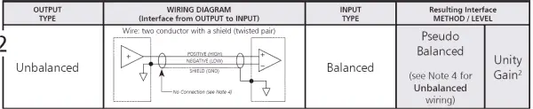

As far as I can tell, pseudo balanced is basically feeding an unbalanced signal into a balanced input through a balanced cable - i.e. from a TS to TRS connector connecting send T - receive T, send S - receive R and the shield to receive S only.
This illustration is lifted out of an Aphex manual:

Thanks for the diagram, Arjoll. Pretty helpful.
