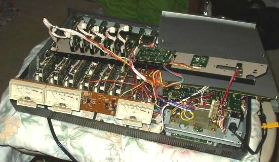

Success!
All meters are working now. It wasn't a big deal once I got to the meter, but getting this machine apart is a wonder. Anyway, everything is back together and no screws left over. :D
I’ll have to break down and get a service manual, as this thing is getting on in years.
I replaced the insides of the meter (needle, magnet) with one taken from a different, but similar TEAC meter. Very delicate stuff… I should have been a surgeon. ;)
