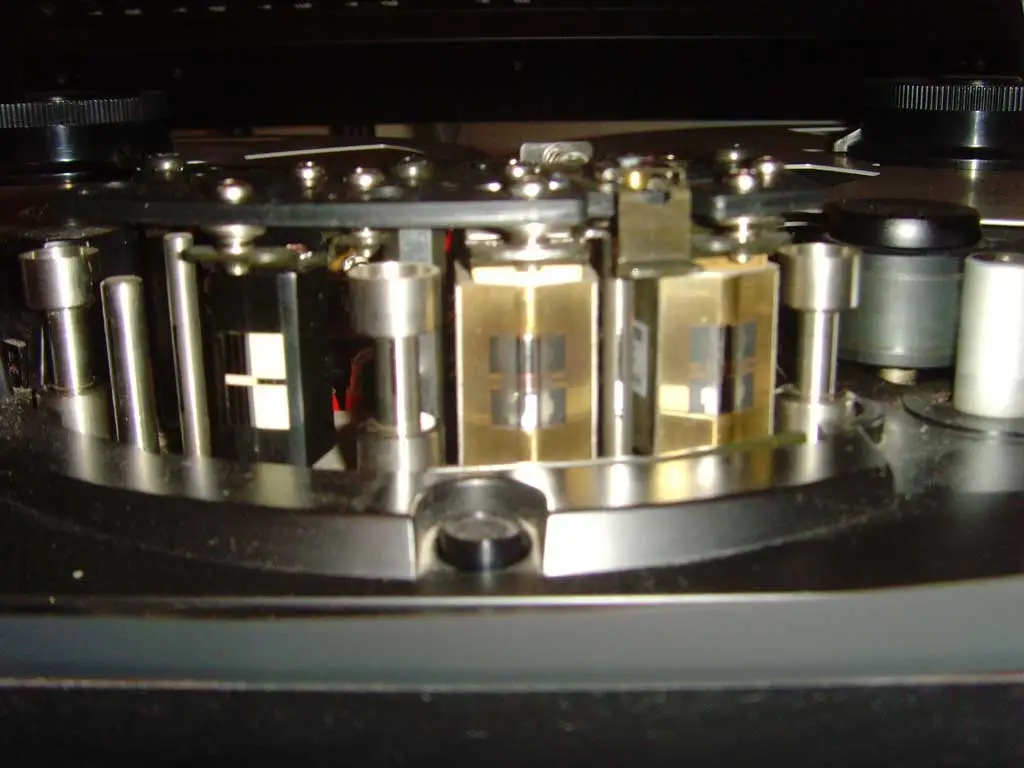

Thanks, Tim. Here is a picture of what I am talking about. You can see the trapezoid in the center of the head on the right. It seems as though the heads have never been adjusted since leaving the factory because the screws are still marked in their original positions. (with wax or glue or whatever that stuff is they put on at the factory)

To me, it looks like the capstan rubber idler needs cleaned. Glazed at the bottom, which would cause an uneven pull. Could just be my eyes?
Hard to tell much from the photo. I think you need a macro or a close up lens.
Yes I've seen a number of machines with keystoned wear pattern and apparently set like that from the factory. But then what a job for some poor sucker to do all day every day...
