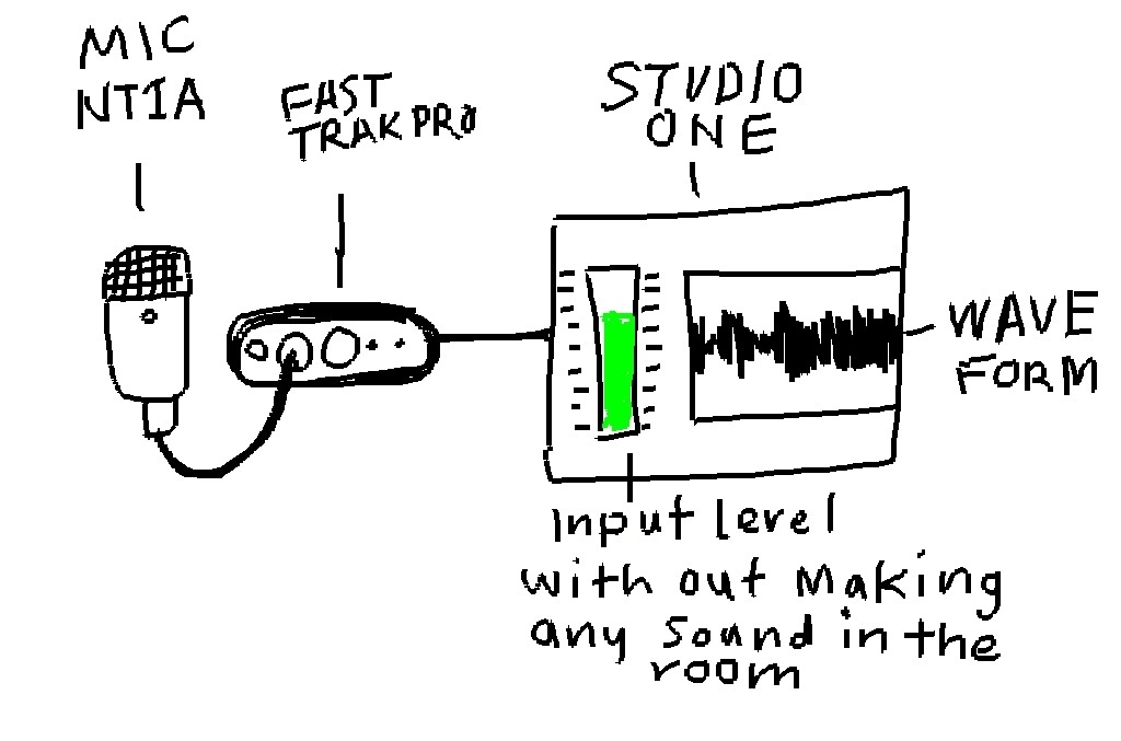

Hi! I use Studio One as my daw,
the NT1A condenser mic is connected to the
M-audio fastrack pro usb interface with phantom power on.
When i assign an audio track to record vocals,
input signal reaches over the mid level without any sound going in the microphone.
When record without making any sound near the mic,
the waveform of the track also shows something is being recorded.
When i still sing in the microphone, the recording is full of hums, wind and low in vocal parts.
Hv tried everything adjusting the knobs on fastrack pro, trying another mic input, upgrading the drivers, nothing is helping to make a clean recording.
Pls help.

Nice illustration.
Have you tried a different XLR cable or different USB port? What's your OS?

Can you try the mic with any other device?
You don't mention whether or not the sound is there without the mic plugged in.
Start removing gear. First unplug the mic.... is the noise still there... if yes, then remove the cable. Is it gone now? No? Unplug Fast Trak

I think you have the fast track input gain turned up too high. Your vocal should be peaking at about -18dBFS to about -12dBFS and no higher. There is no need to record hotter than that.
Telling us that the meter is going over halfway isn't helpful. We have no idea what the scaling is for your metering. If your room is fairly quiet you should register between -55dbFS to -60dBFS with the mic turned on and set at a reasonable level. How your vocal turns out after that depends on your technique and your room and a bunch of other factors.
