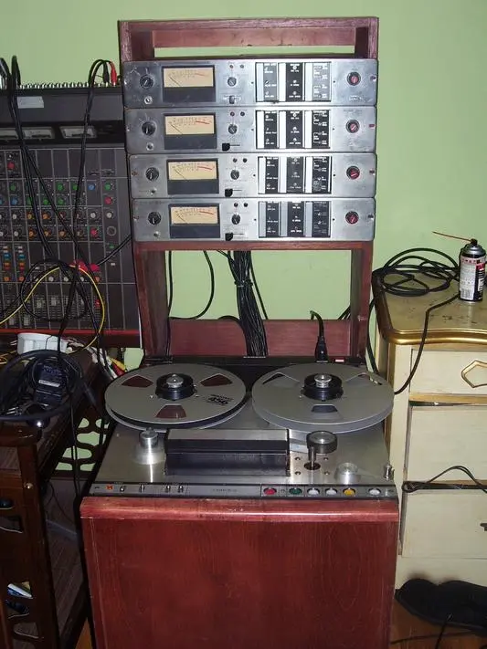

SteveM
SteveM
An Ampex Ag 440-B 1/2" 4 track...

That's a nice deck. But why no tape counter? Kind of makes no sense to me.

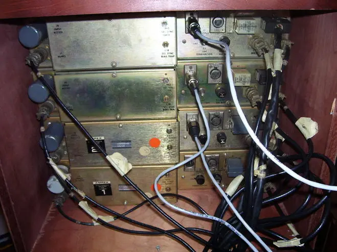

Steve, again, if you can get a shot of the back of the electronics modules I'll know for sure, but all the knobs on the modules are 'A' type. A lot of people put the 'B' type on the 'A' electronics...haven't run into the opposite yet, but it certainly is possible. Post up a pic of the back and we'll know for sure.

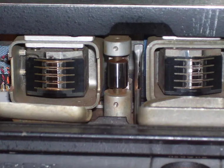

The tape is off the play head by at least a 1/4". Not sure if it can go out much further. I'll have to try and get some more pics up. It's at such an angle though it's hard to see with the eye. Lifters are not sluggish at all.

Lifters: yes, pics would help. There is no way I can fathom that the reproduce head would be able to pick up the tape from 1/4" away...maybe I'm not understanding something. Again, on the 'A' transport there is no lifter delay circuit (unless it has been added) so the lifters retract as soon as PLAY is pushed, and the tape may still be moving from shuttling when PLAY is engaged which is why you always hit STOP first (and wait for the transport to come to a complete stop) and then hit PLAY. Sorry I can't be of more help yet.

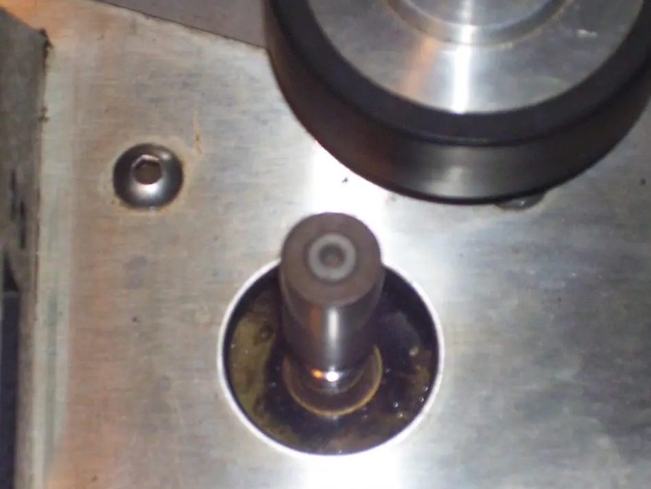

Steve, if you are taking pictures, can you take a shot of the capstan shaft and the hole through the deck plate? It looks like your shaft has a sleeve on it...:confused: And you are missing the dust cover over the hole in the transport plate...I might have one.
Yes, will take some overall pictures of everything. I knew I was missing the dust cover.
By "hole through the shaft" do you mean, on the capstan from the top? You're right, it looks like I have an adapter on the capstan.
Re-read my request...it says hole through the deck plate.

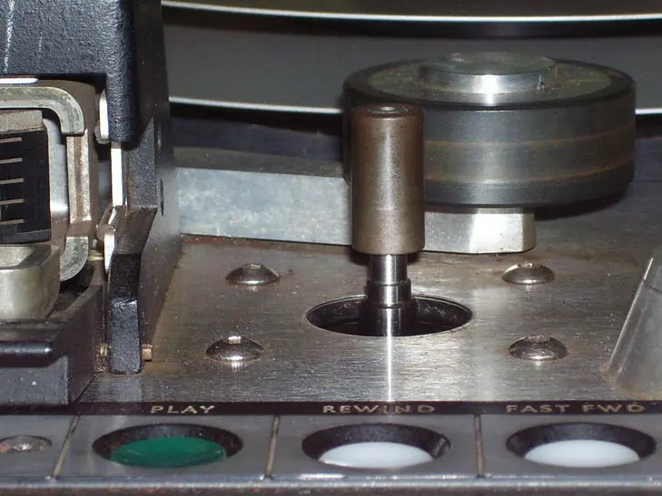

Adapter on the capstan...hm...that's interesting...well, that will indeed keep the tape closer to the heads when the lifters are extended. I wanna see that adapter. Does it seem like the capstan runs at 15ips when in high speed?
Yes, lifters should be up or retracted by default and extend when shuttling, retract in STOP or PLAY mode.
I think you've figured it out about the capstan sleeve. I don't think it belongs there. Looking at pictures of others I don't see that. But how to get it off? It won't just pull off.
This camera I'm using is pretty bad. It's impossible to get a good shot of the heads. Never mind the tape in front of the heads. Here's a few shots. I'm going to get a better one of the capstan from the front.

yup, you figure it out Cory. That thing needs to come off. How do I get it off? :confused:
I managed to get a couple better pictures.
The "hole in the deck plate" :o The one around the capstan that's pictured above right?
Those capstan sleeves are usually used for different speeds. Thing is I don't know if it's for the higher or lower speed. I want to think it's probably for the 71/2 speed.

Okay...definitely 'A' electronics.
What a PITA...I can't believe it...looks like somebody pressed a sleeve onto the capstan shaft to get a higher tape speed and of course the shaft would no longer fit through the dust cap so they just left it off. ARG. See those four cap screws on the deck plate around the capstan shaft? Loosen/remove those and the capstan motor is free, and it plugs into the transport control box into a socket that is even labeled capstan motor. Then if you want you send it to me and I pull that sleeve and send it back to you...if your reel table ends up being wobbly you put that in the box too and I straighten the motor shaft and send it back to you. PM me if needed. If you dn't want to do that I can try to help and walk you through the procedures.
The sleeve will increase the tape speed regardless of the speed the deck is set to. In other words, if the sleeve doubles the circumference of the shaft it'll turn 7.5ips into 15ips even though the deck is set to slow speed, and it'll turn 15ips into 30ips.
The other option is to just leave it on and leave the deck set to slow speed and and it'll be at 15ips. But I don't know about tension settings and all that. If the deck is set to 7.5ips and the sleeve drives tape at 15ips then the tension settings would need to be redone and whether or not they did that I don't know...:confused:
