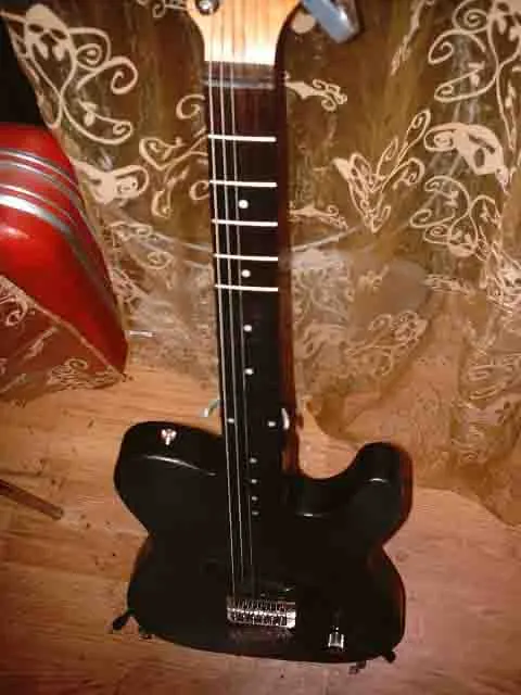

i've been playing this baby for a while now, fretless from the fifth fret up. lets me combine strumming chords and playing fretless. the only 'problem' is that because of the frets the action on the fretless part of the neck is relatively high.

awesome man, yeah the action thing is too bad. But after awhile, you just get accustomed. Thanks for posting a pic man.
