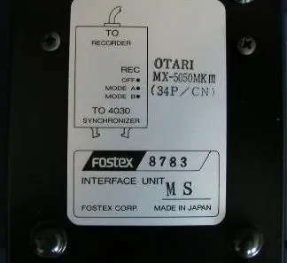

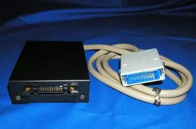

The short answer is that it can be done provided you can locate a suitable interface unit that Fostex made for Tascam decks. It doesn’t look like it can be done with custom cables alone. Unfortunately there’s not really a standard that makes it as simple as getting different connecters and figuring out which pin corresponds to the pin on the other side, since sometimes there is no direct Tascam conterpart to a Fostex function and vice versa. So Fostex made several converter/cable assemblies (Interface units) for different machines. But even then some features beyond basic transport and sync might not work.
See pics below of the interface unit, #8783 for the Otari MX5050 MK III.
