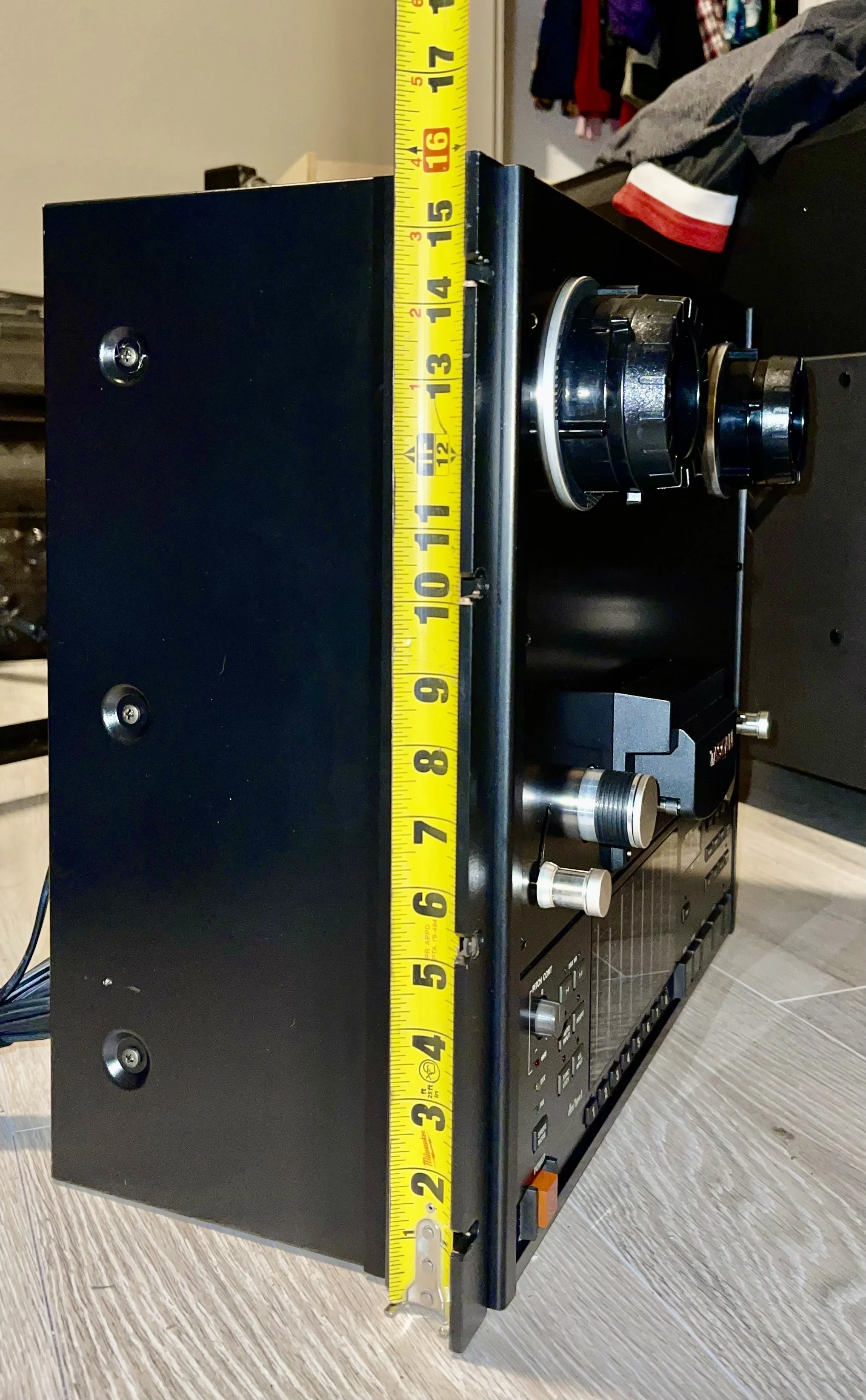

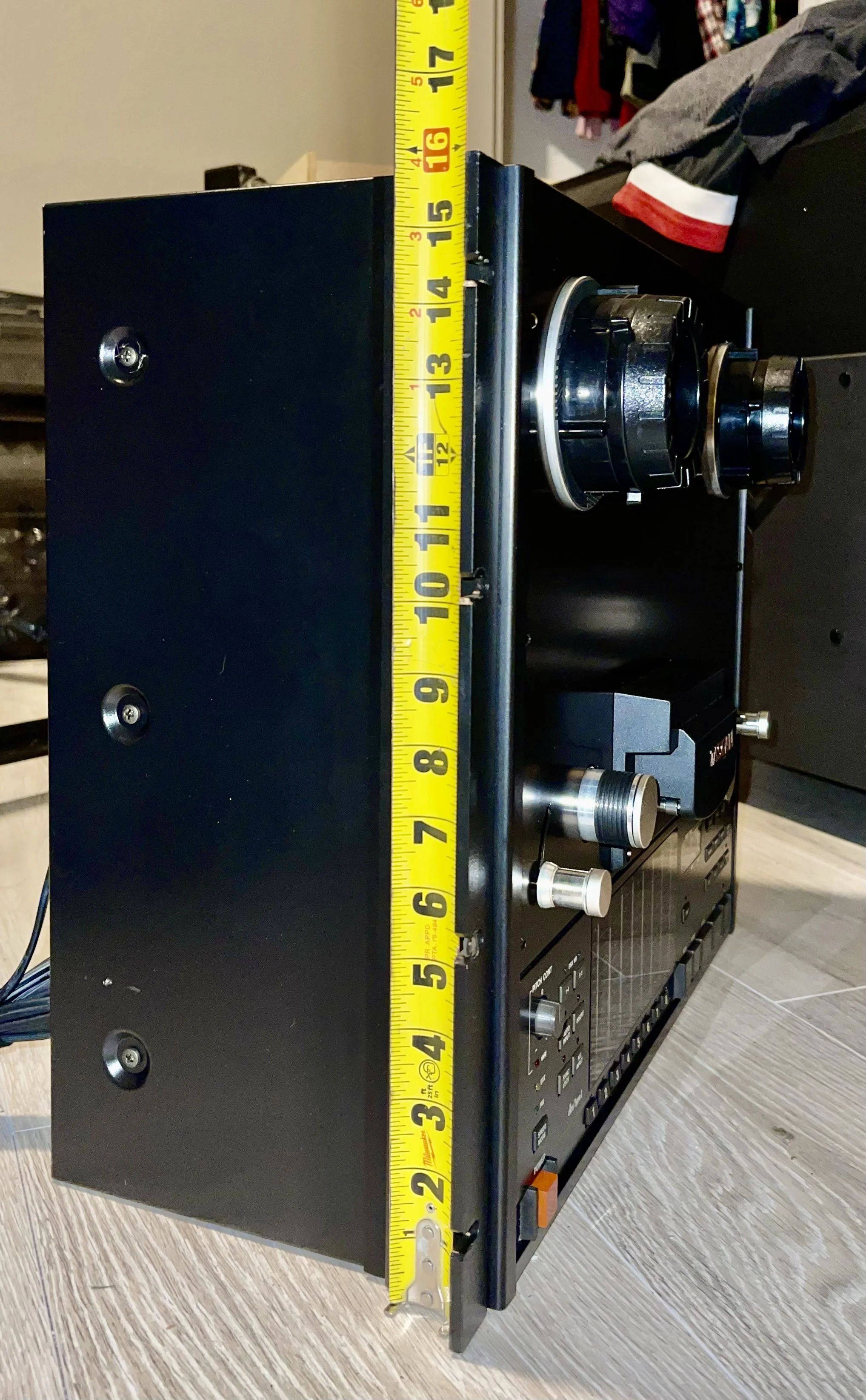

Hi, I've got some tsr-8 rack ears.. I'll send some measurements if you want, but you can measure the machine itself, that plastic piece that has 3 screws that go on both sides of the machine has the same measurements as the rack ears, as the rack ears screw into the same holes and are the same height (exact height of the machine) and once you get the machine side holes drilled into your homemade ears, attach them to machine, put cart/stand level so you lay machine on to and its laying flat with reels facing the ceiling, then get underneath and mark holes for stand/cart side of the ears, but if you want measurements I can send them.. oh and not sure if there still up but last week someone had some on ebay for 75 bucks

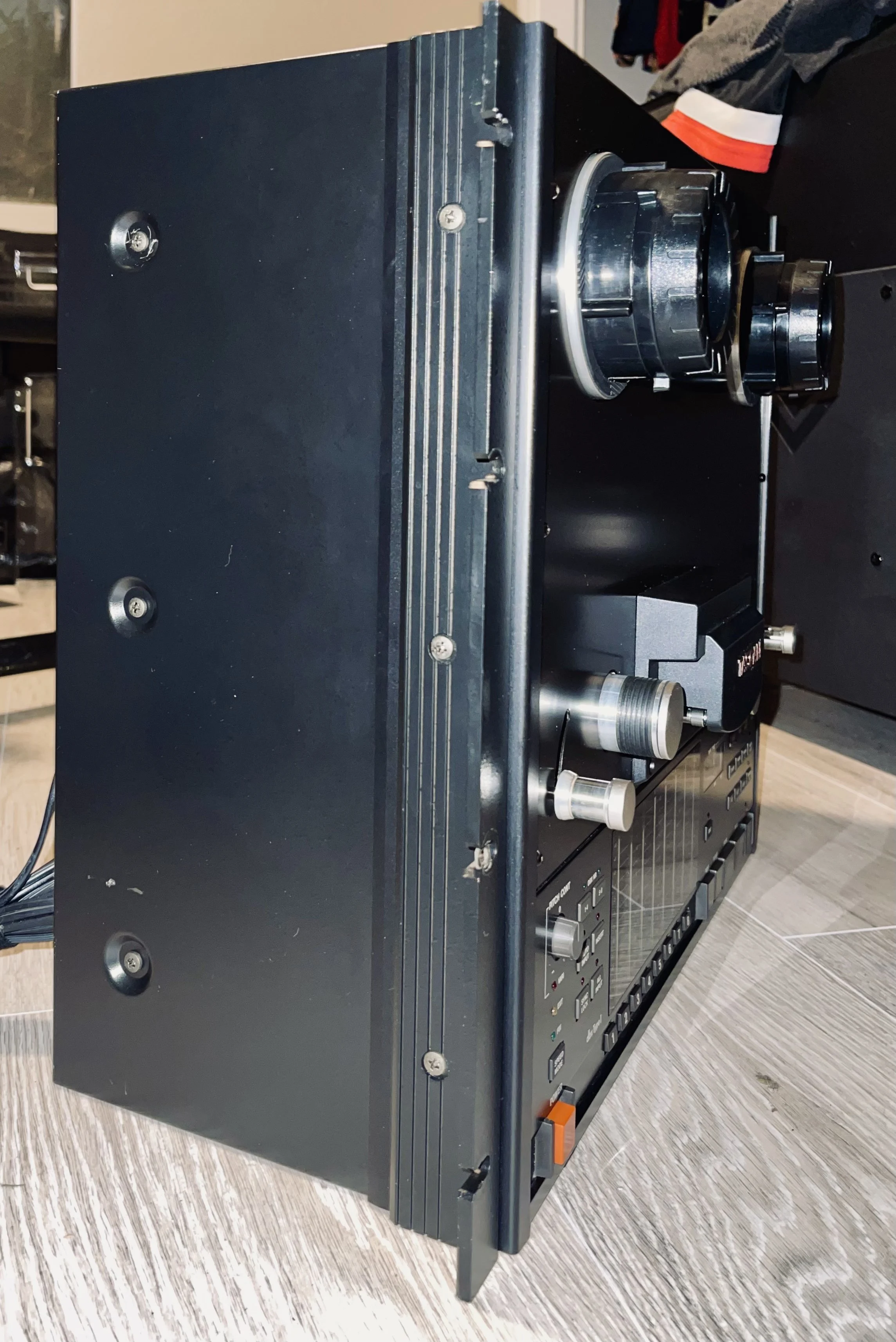

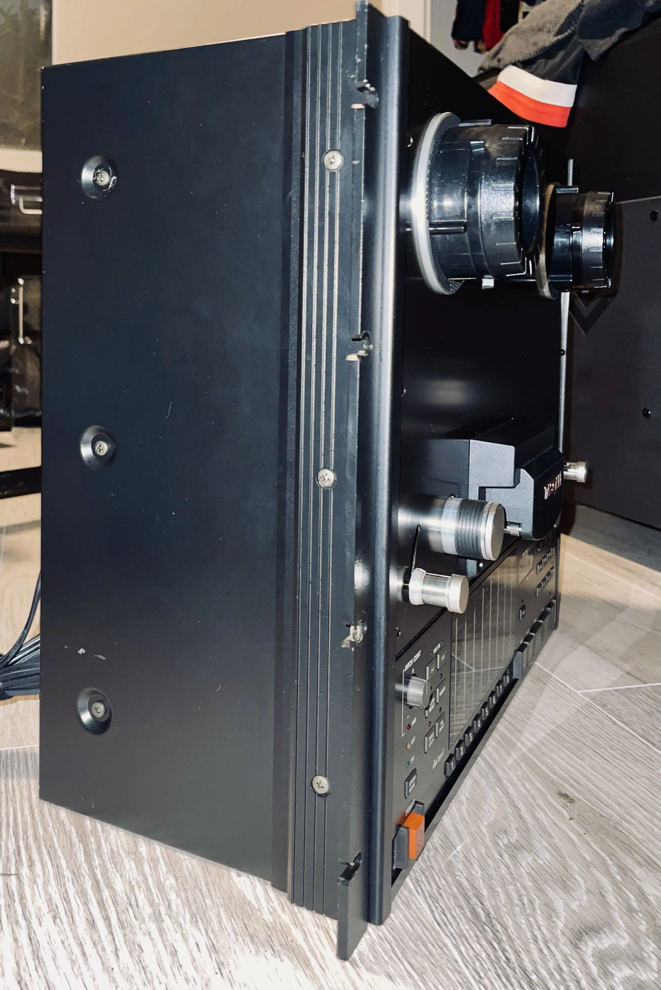

Ok I've got the measurements, hope there accurate enough.. for the machine side of the ears if your machine has those two plastic pieces that screw on both sides of machine, you can use those holes to stencil the machine side of the ears
Machine side. .... 15.75 inches X 1.5 inches
1st hole is 1/4 inch in diameter between 2.25" and 2.50" inches from the bottom
2nd hole is between 7.75" and 8 inches from the bottom
3rd hole is slightly under 13.25 and 13.5 inches from the bottom
Cart side..... 15.75 inches X 1 inch
1st hole 1.5 inches from bottom
2nd hole. 5.5 inches from bottom
3rd hole 10.25 inches from bottom
4th hole. 14.5 inches from bottom
Hope this helps, by the way are you John in Greece?
