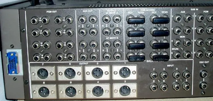

Again, I'm using the M520's onboard 8-channel -10 TO +4balance amp (picture below), but I need something to convert the signal back to -10 coming back from the 58.
Even though pointless, you can go into the 58 balanced and come out unbalanced with no problems. The info on the tape is the same either way. Neither your board or machine performs any better @ +4.
