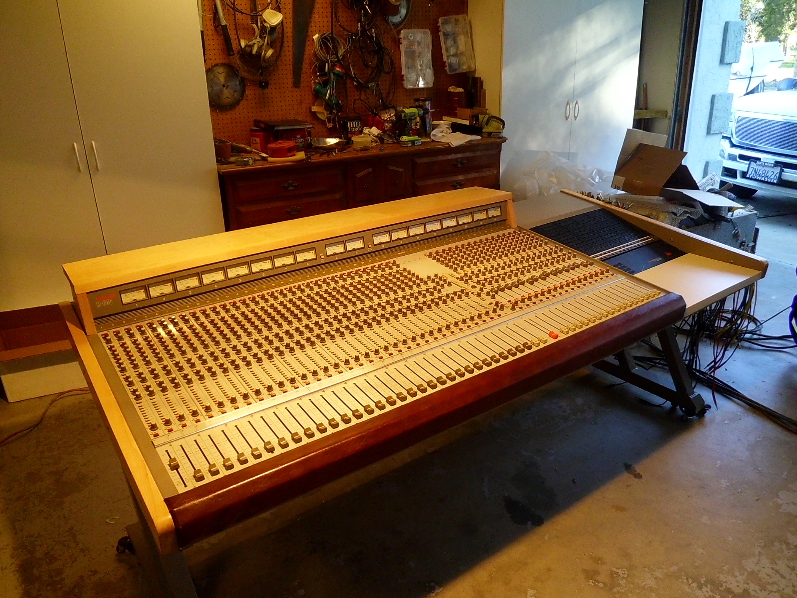

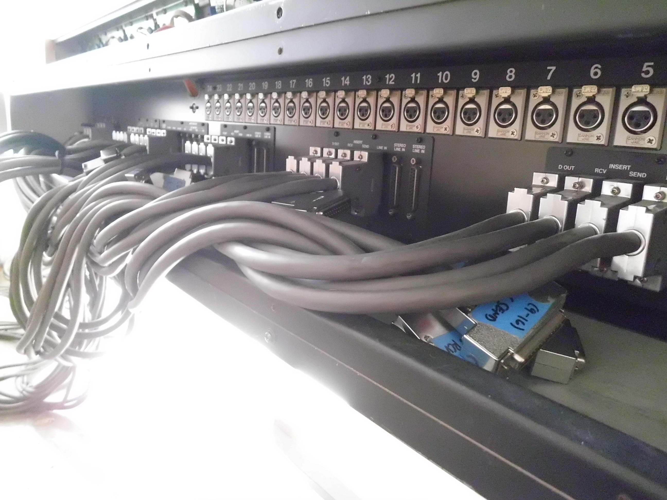

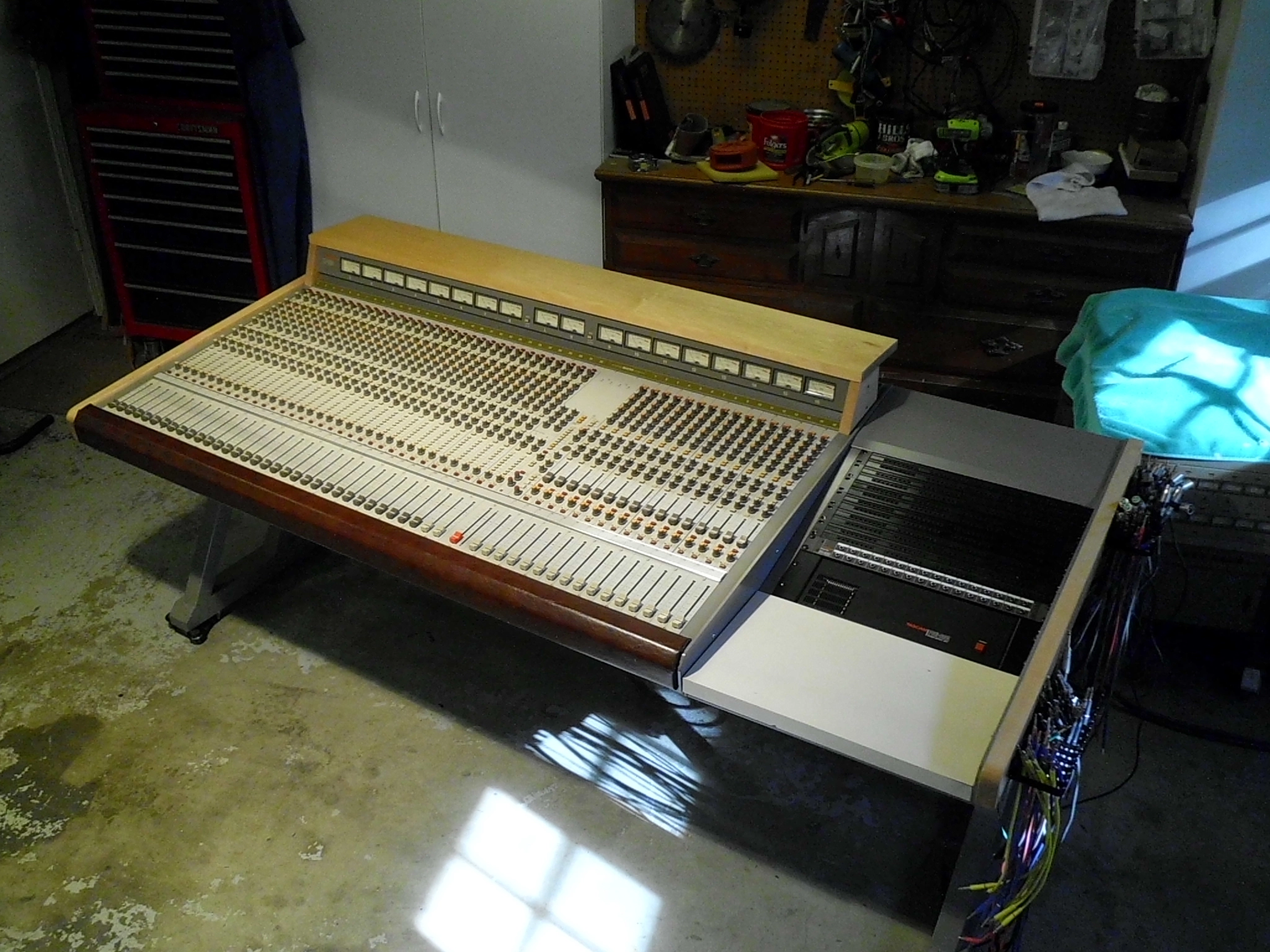

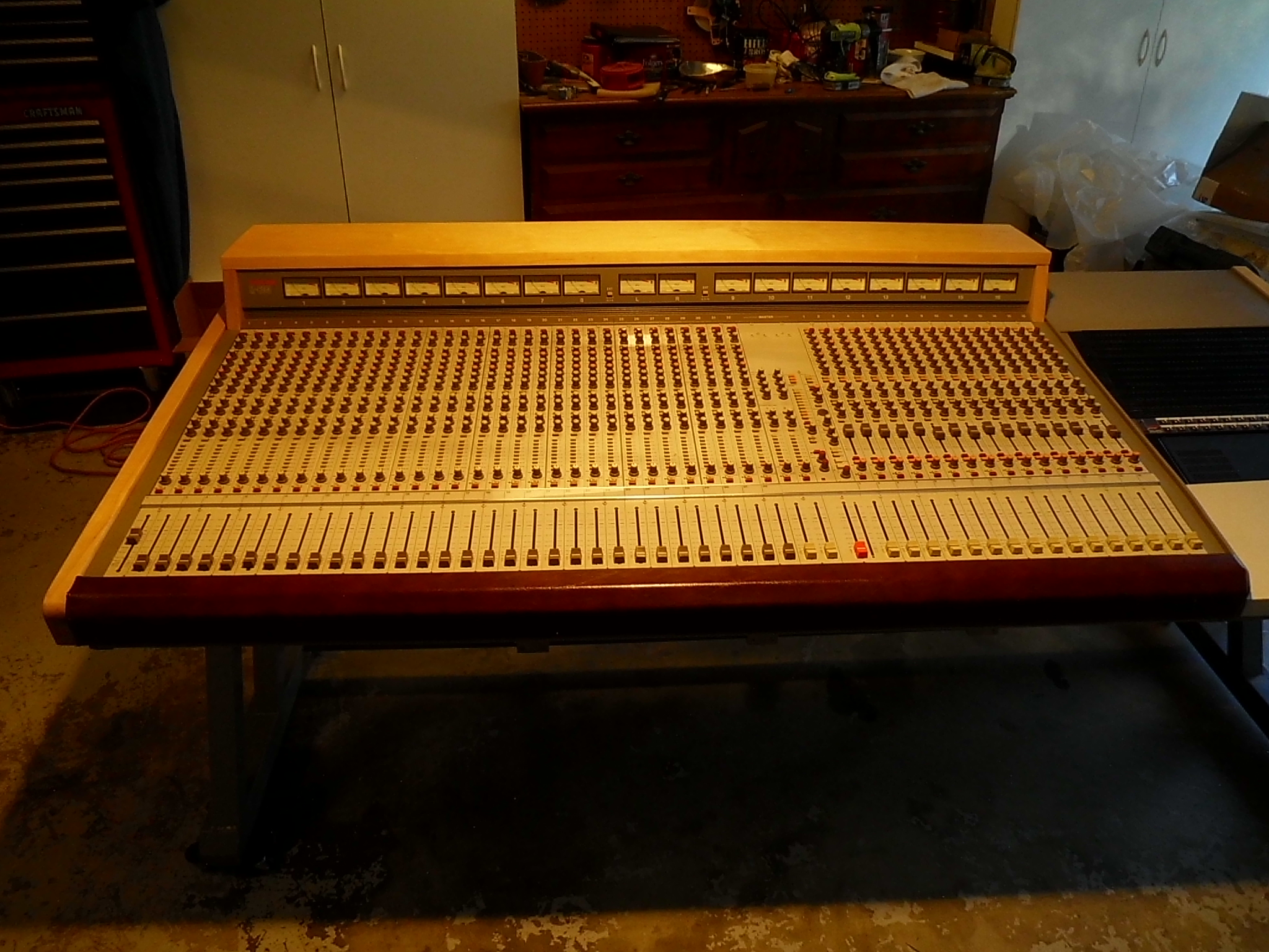

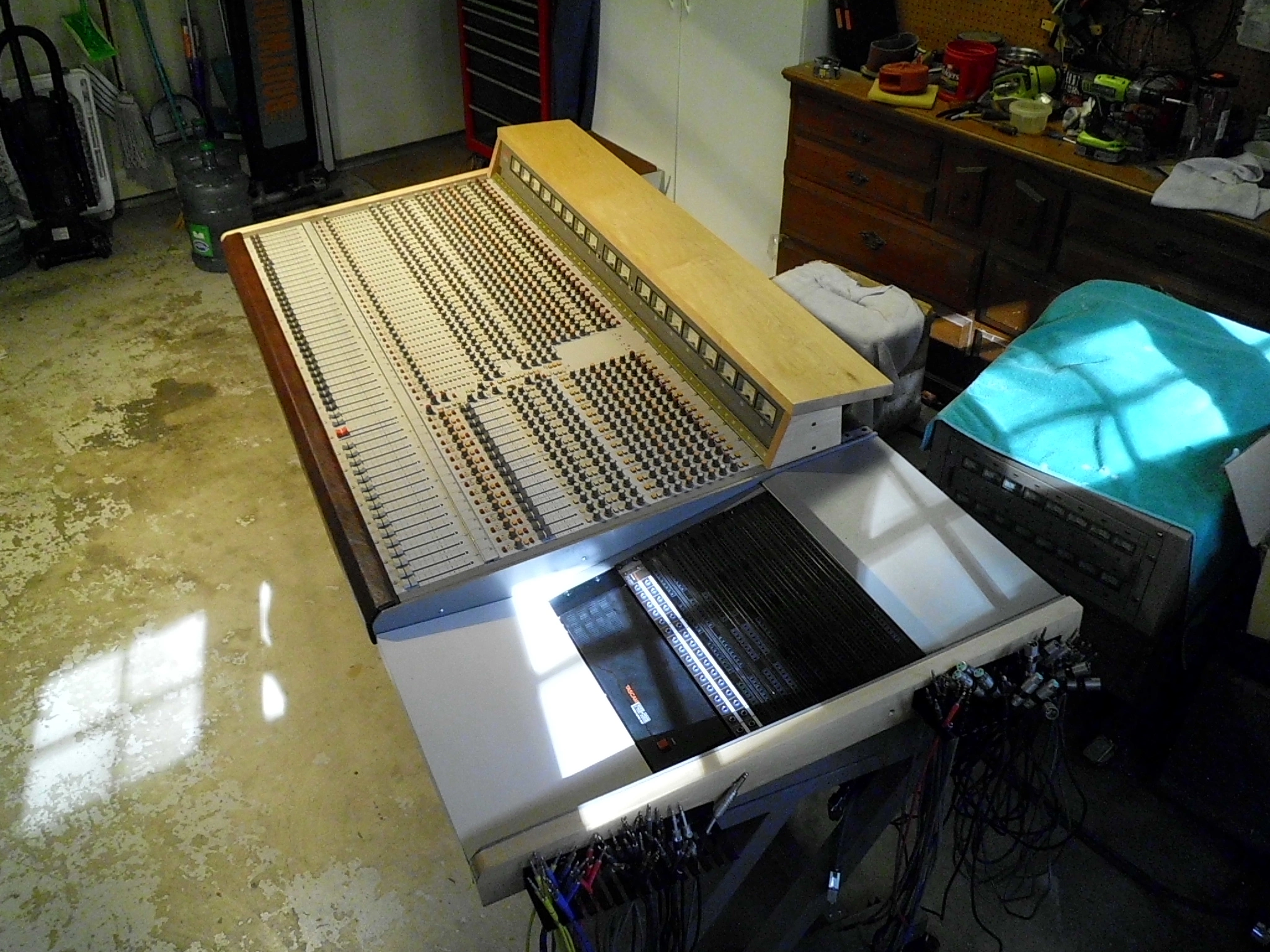

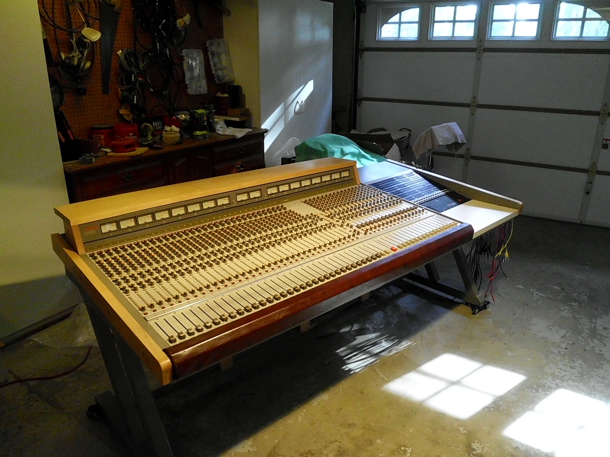

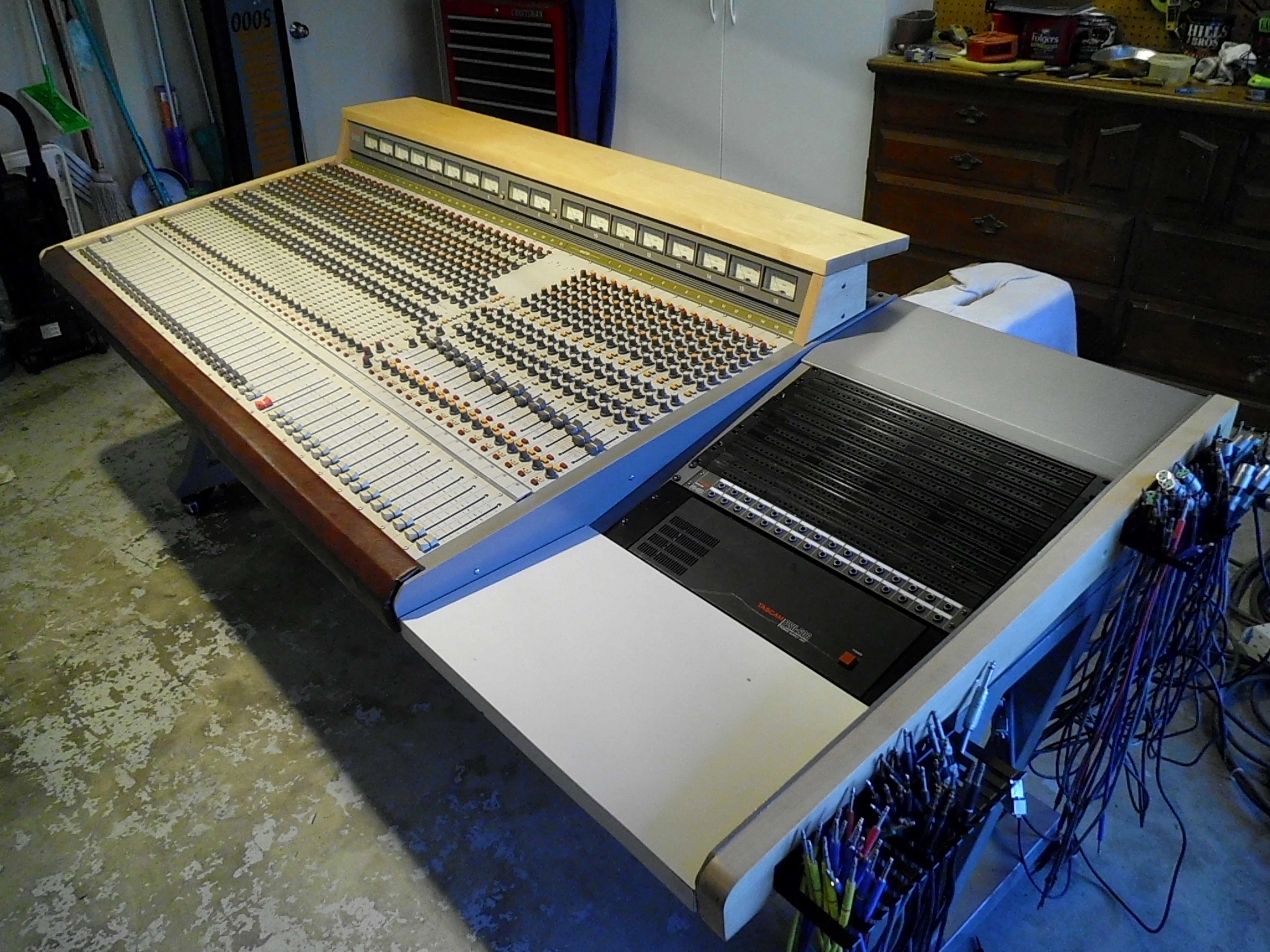

Here's a few pics.
Nice pics, Ron!
Mind if I make use of them for the wallpaper thread?
Cheers! :)
Not at all. I could supply some better one's if needed. I have the maple, meter penthouse cover removed in these.
Excellent!
If you've got additional images or want to take some more with the top dress panel, go for it! And post them here in this thread.
Also, if you are going to take additional pics, try to get the entire mixer into the shot without any cut off corners. Your first shot was a nice angle and nicely lit but the right front corner of the desk was clipped out of the shot. If not, that's not a problem as I can rebuild the missing corner in Photoshop.
Cheers! :)

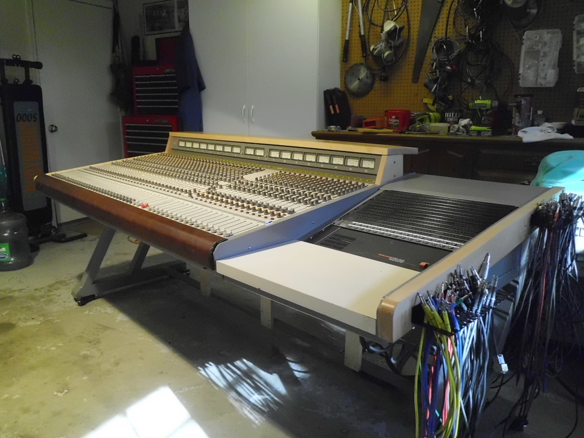

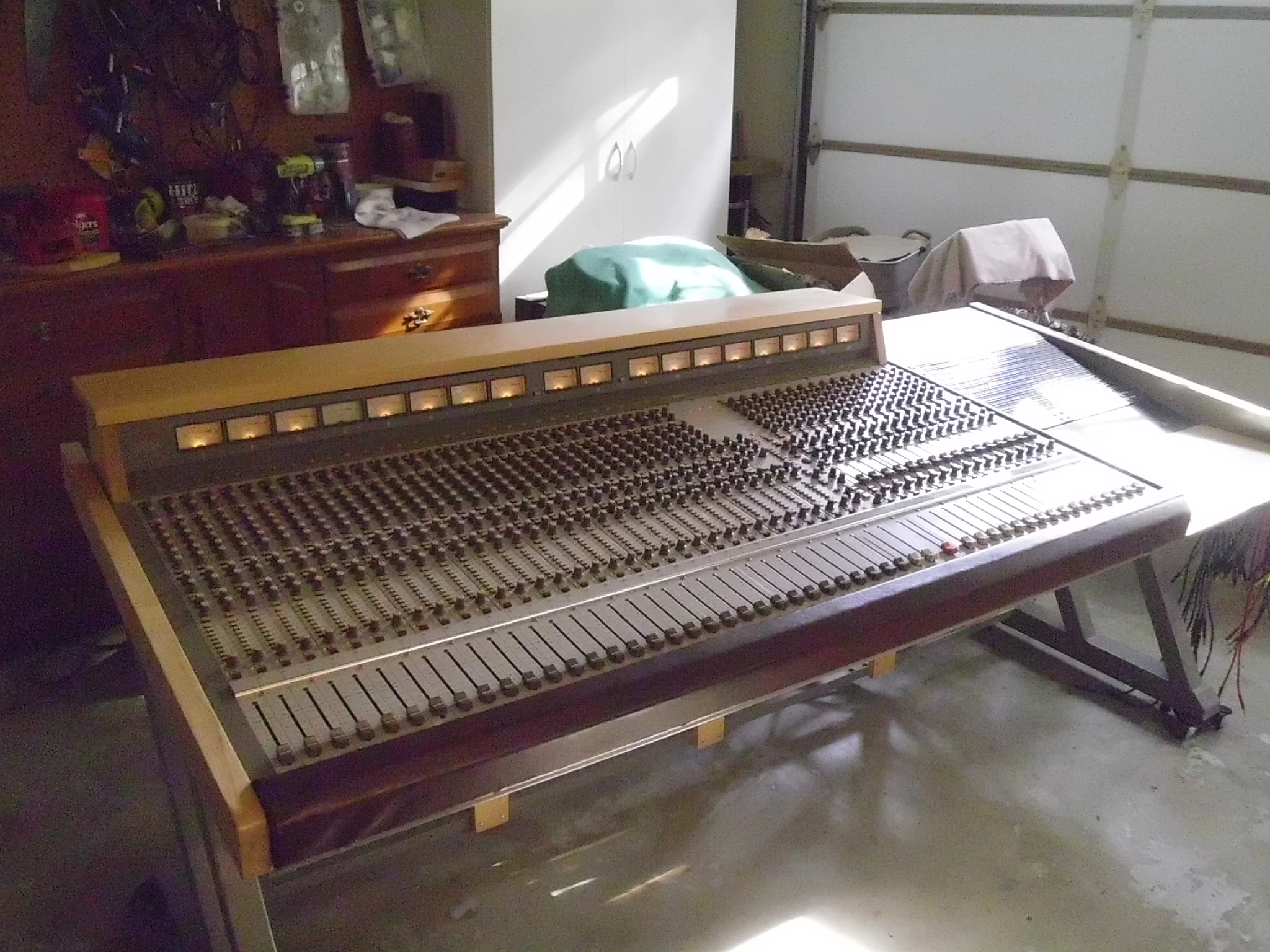

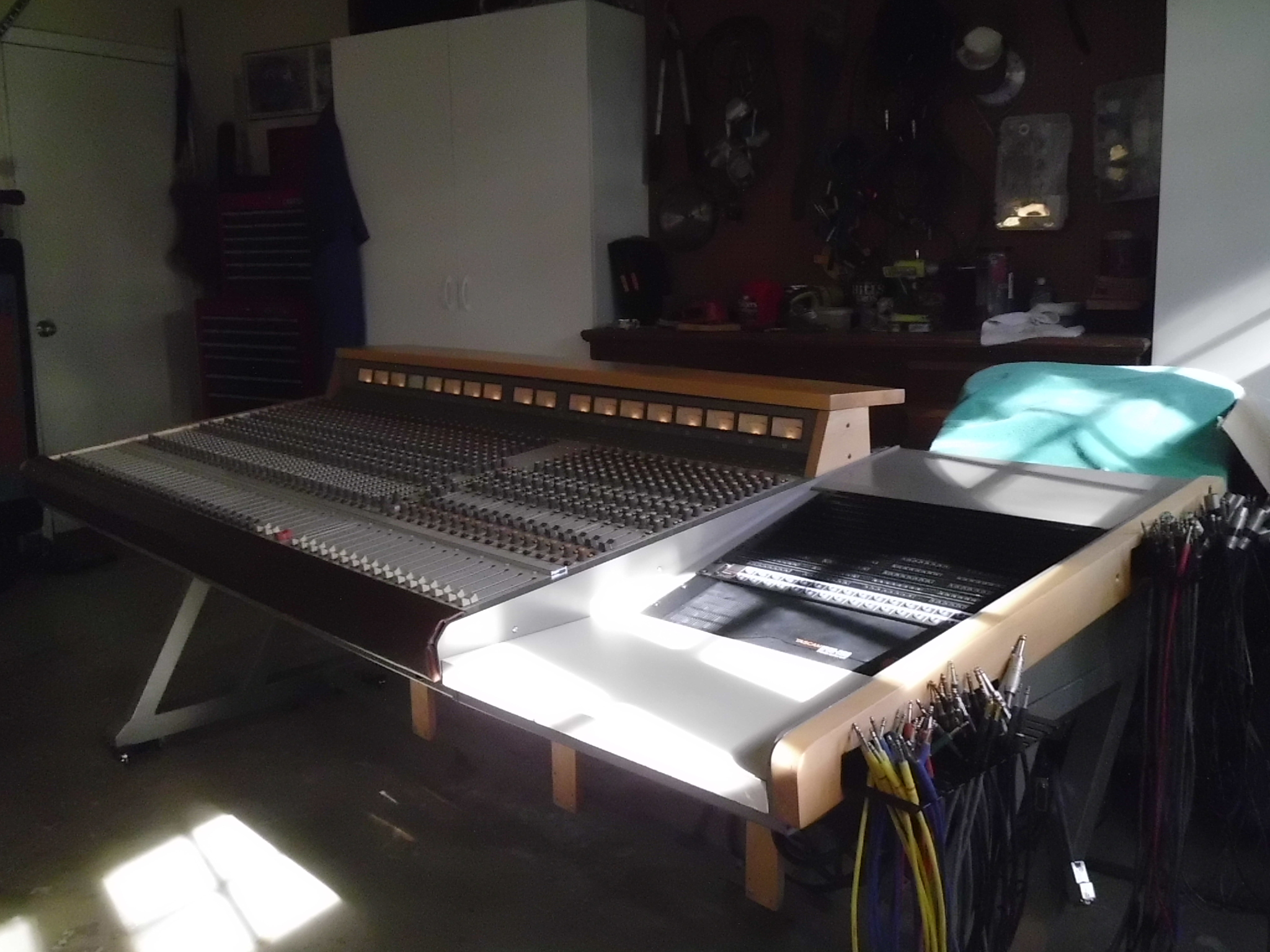

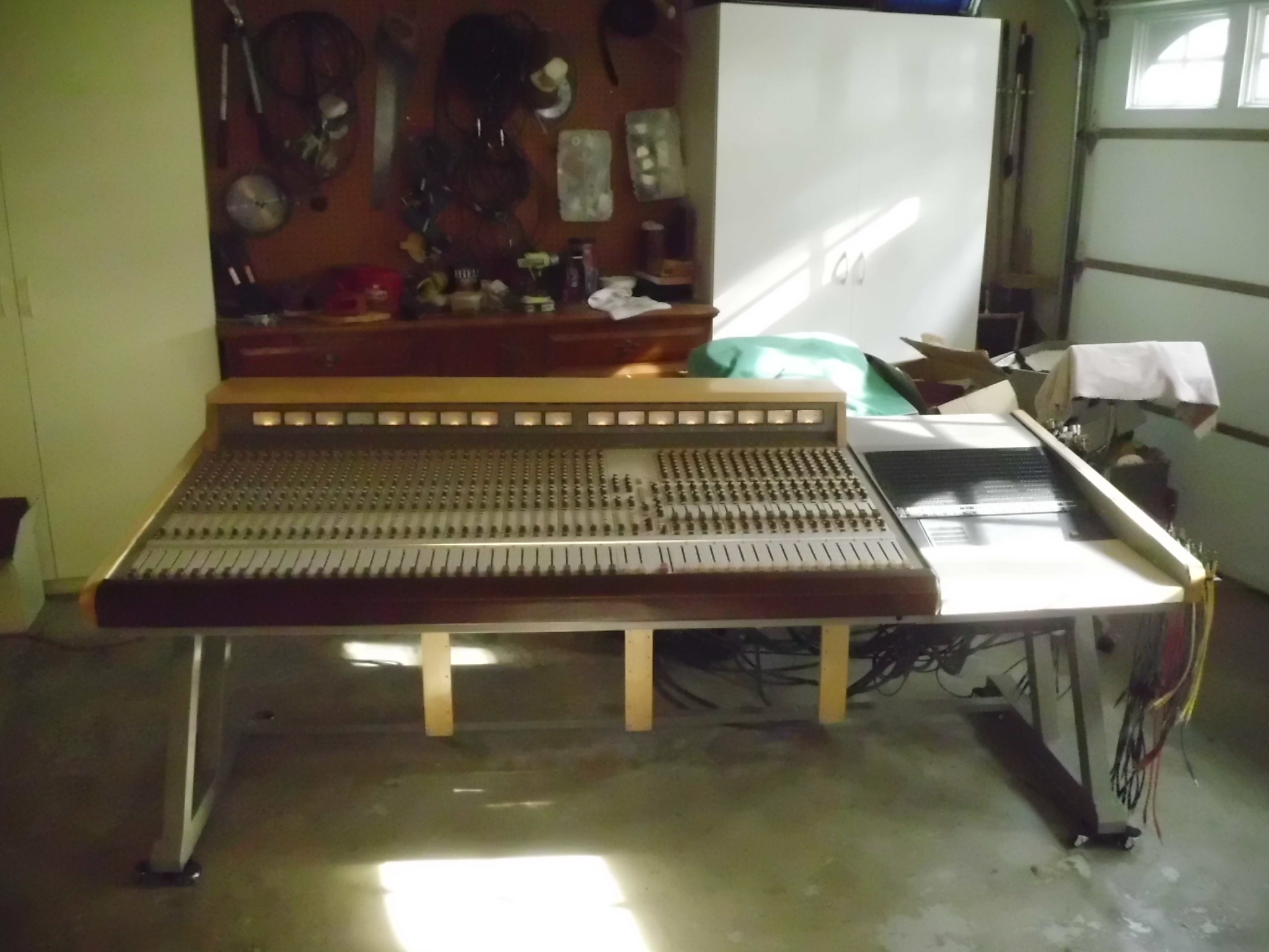

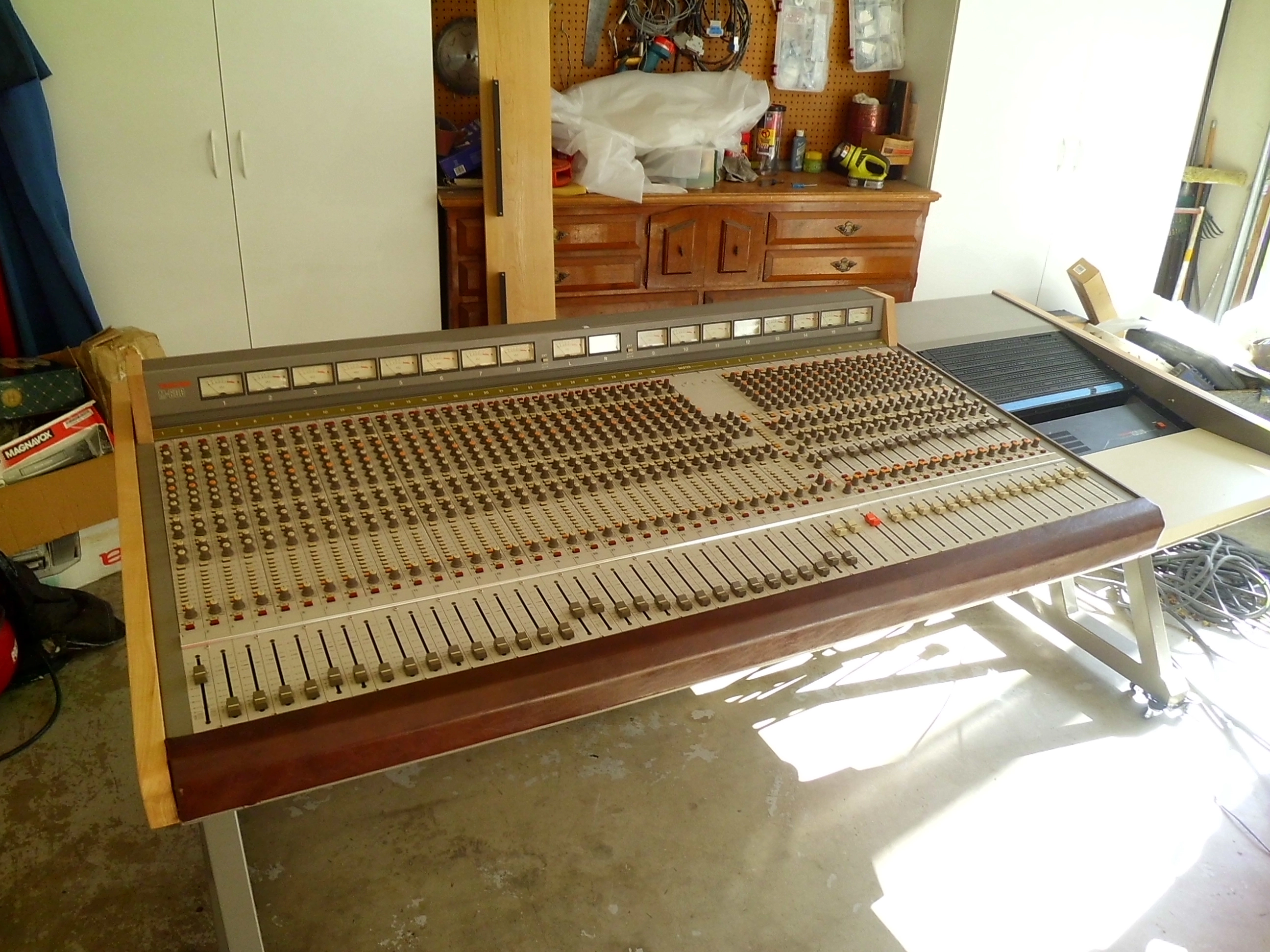

More Pic's of M600 Console
Wow that "Old beast" looks pretty good.
Just saw a problem in the pictures. I'll post some new ones tomorrow.

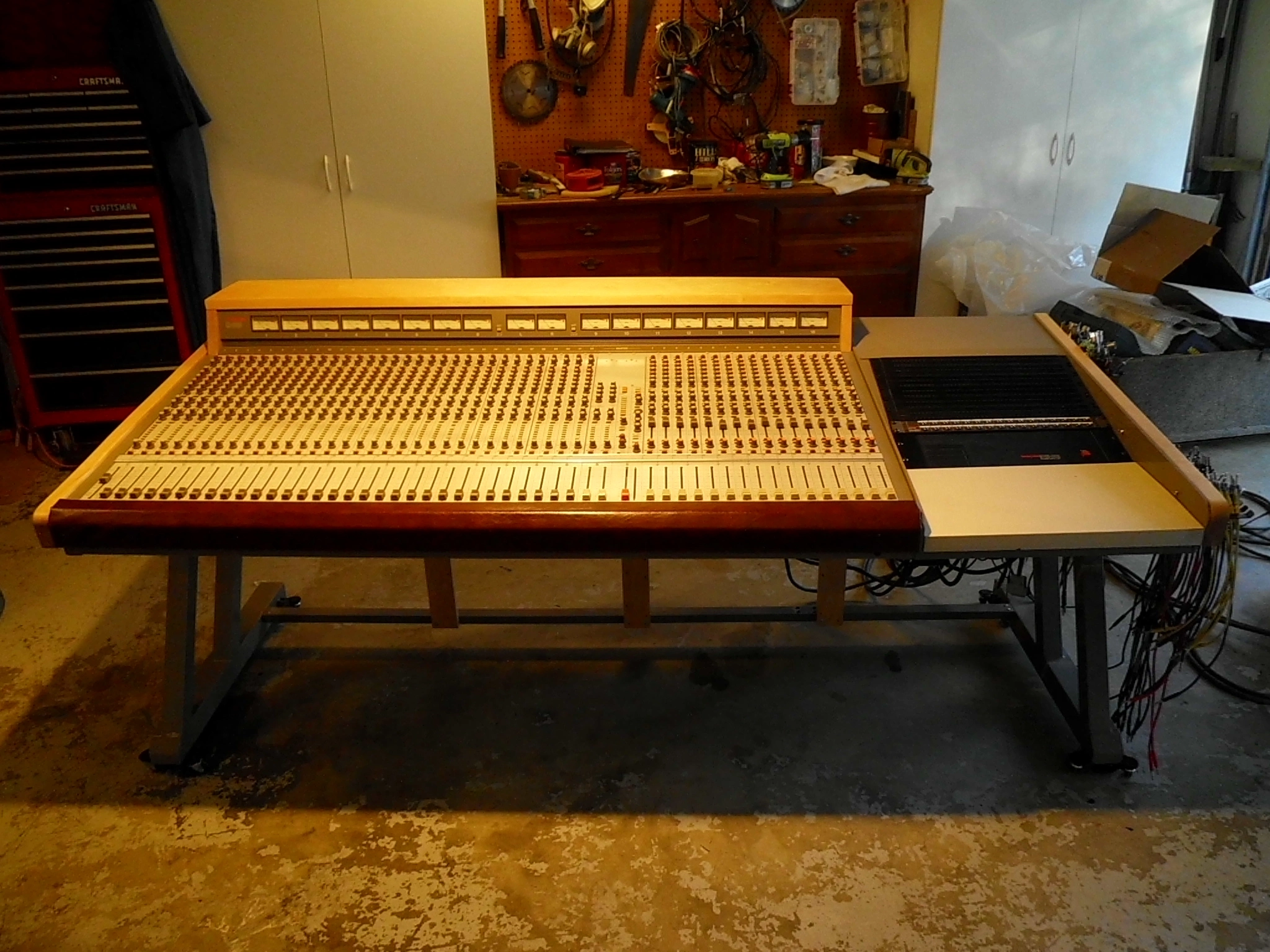

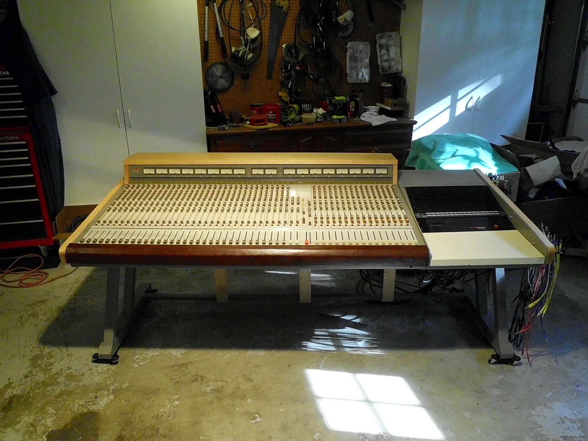

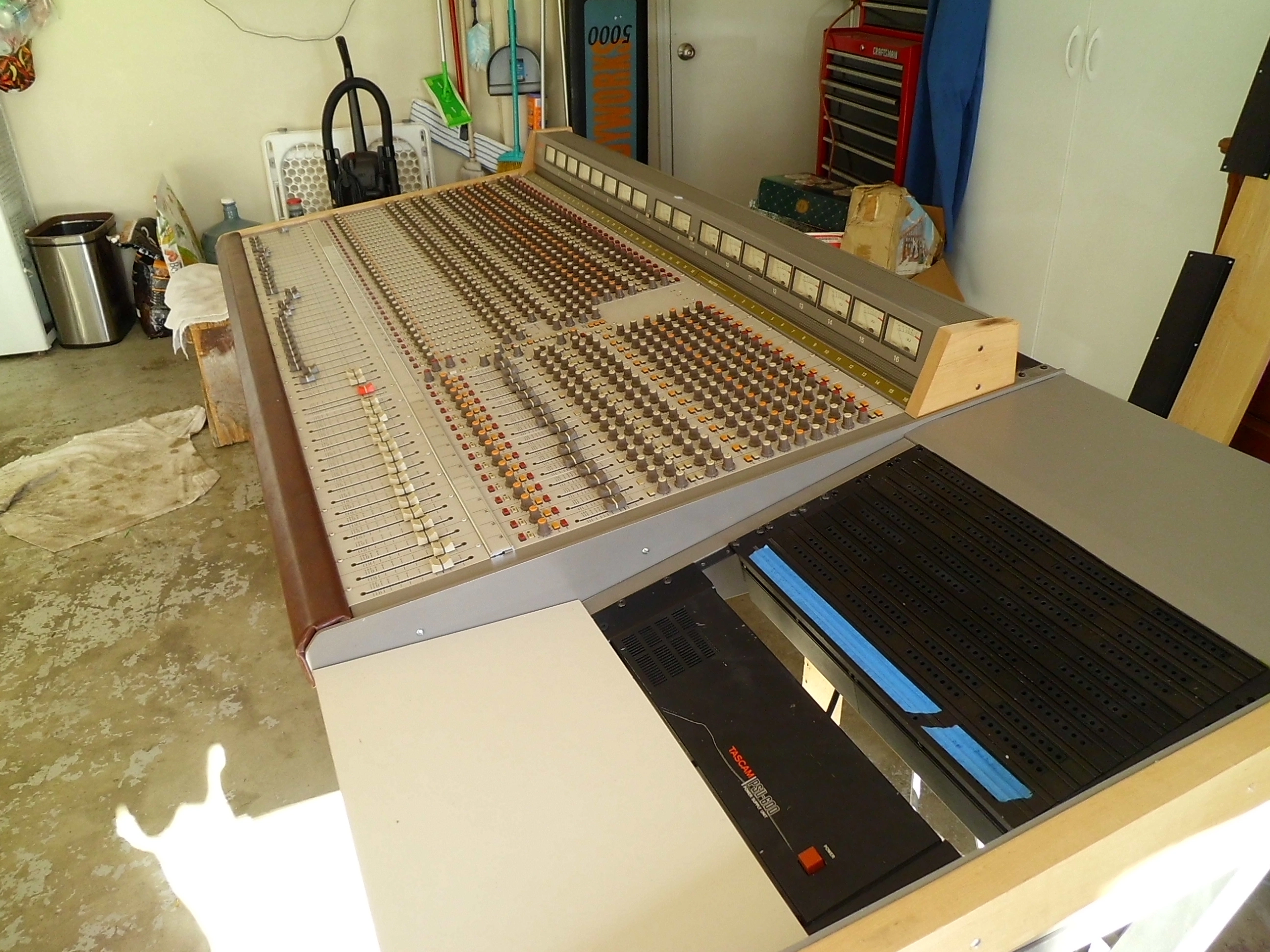

Pictures M600
OK here are some more pictures of my M600. This time All the faders leveled! Gheese!!
SANY0170.webpSANY0172.webpSANY0173.webpSANY0169.webpSANY0171.webpSANY0174.webpSANY0175.webpSANY0176.webpSANY0177.webpSANY0178.webpSANY0179.webpSANY0180.webp
That's it! Hope these will do. Ghost. Can't wait to get a wallpaper!! Now if I could only get Buss 1-8 working!:eek:
Those look really nice Ron! :)
I'll see what I can do with those as time allows.
I've posted a few already in the wallpaper thread that you can use for now.
Cheers! :)
I have seen them. You did an excellent job on them. It's those darn faders that bug! Sorry.

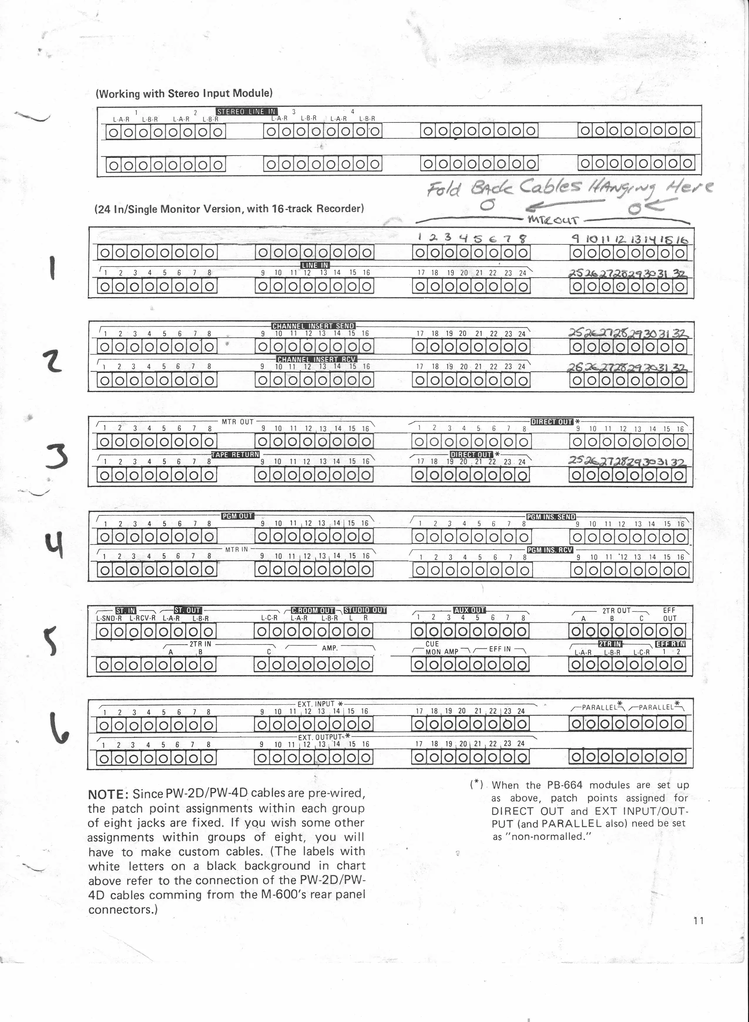

Patchbay layout

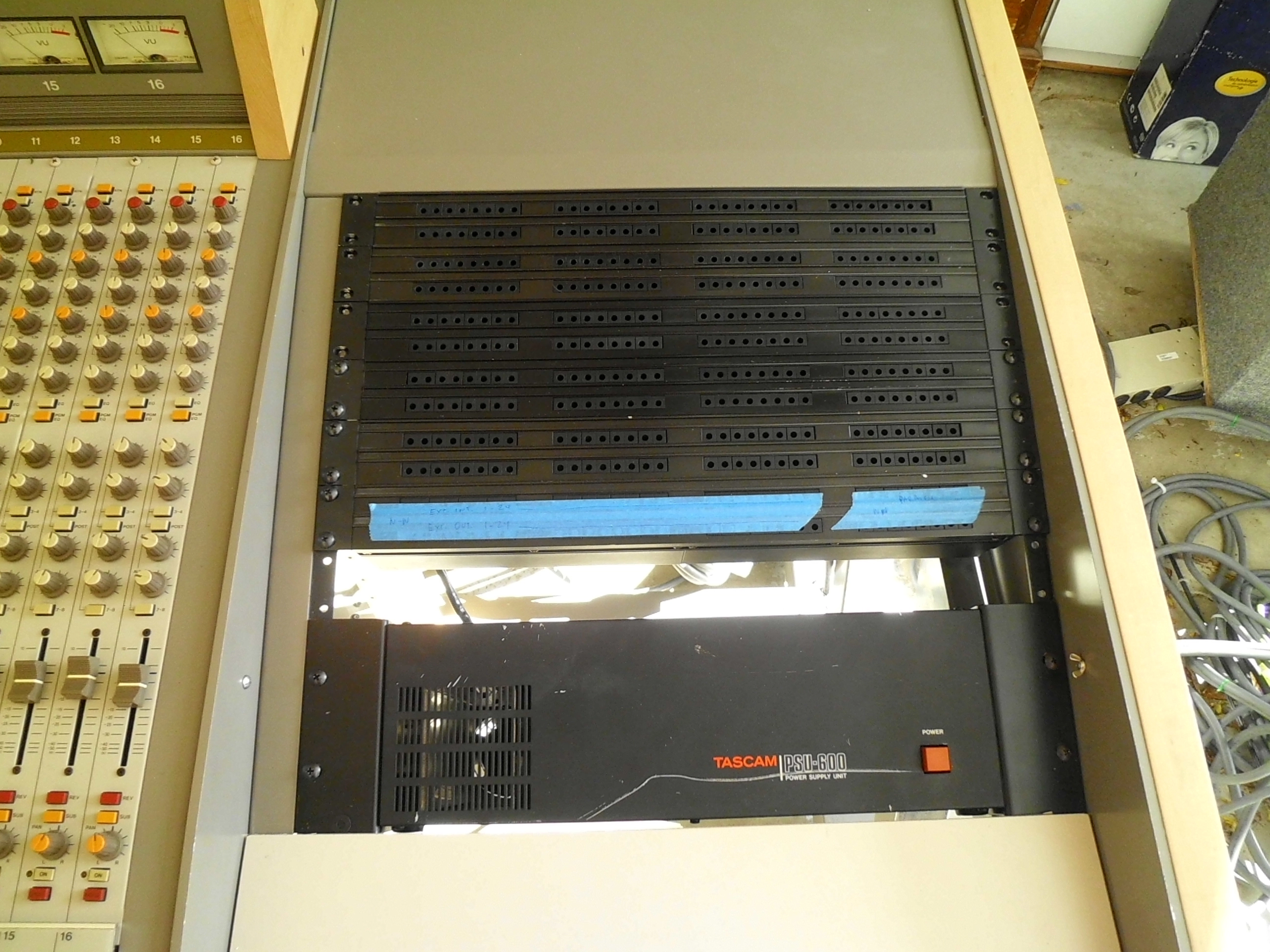

I've got the patchbays connected as follows. I still don't get a signal through a condenser Mic. to any XLR inputs on the rear of the board. I do have the phantom power switch engaged. I also don't know exactly what to do with the two fold-back cables hanging from PB # 1 and I don't know exactly what to do with the D-sub connectors located under the XLR's on the right rear of the board.
Any guidance much appreciated. BTW when I activate the on-board tone generator I now get signal to all 16 VU.s on both the console and Ms-16. Hurray!
Ron
Ron,
The cables go to PB#3 MTR OUT. top row above TAPE RETURN.
It's a split monitor out so you can send tape returns to the input channels for remixing.
At least that how it works on my M600.
Hope that helps
Gary
Thanks Gary. That would be the one hanging on the left goes to MTR 9-16 and the the one on hanging from the right to MTR 1-8 ?
Ron,
Yes, if your looking at the back of PB#1.Just bring the cable from PB#1 MTR1-8 hole 3 down to PB#3 MTR1-8 dsub and
cable from PB#1 MTR9-16 hole 4 to PB#3 MTR9-16 dsub.
