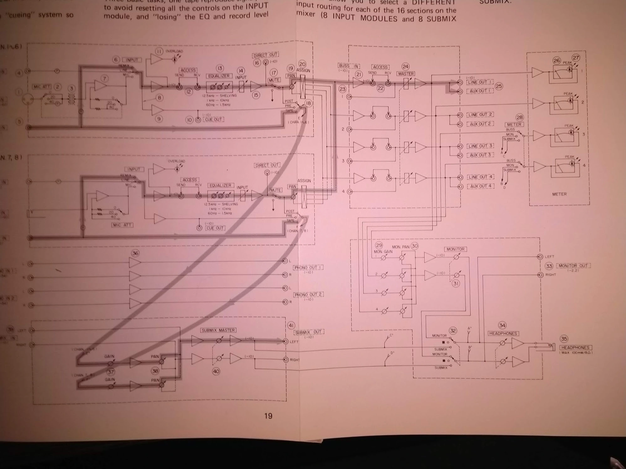

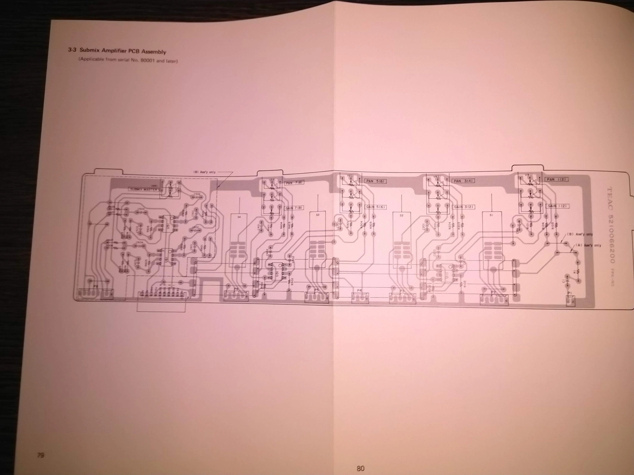

I took some pictures... hopefully you can read them! I have to zoom in. The block diagram is cut off on the left but it's just Channels 1-6 and then 7-8 (with the 1/4" jacks instead of xlr)

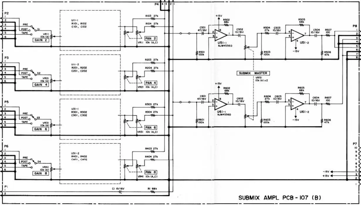

I also included the schematic for the submix amplifier pcb assembly.

Thanks for the effort, but what you called the “schematic” is not the schematic...that’s the PCB layout. I need the complete electrical schematics that show the circuits at the component level. And I don’t think pictures are going to work. I’d need scans, and preferably full scans of the fold-out “tabloid” pages and not sectioned scans.
I’m not expecting you to do that, it’s just what you need for the next step.

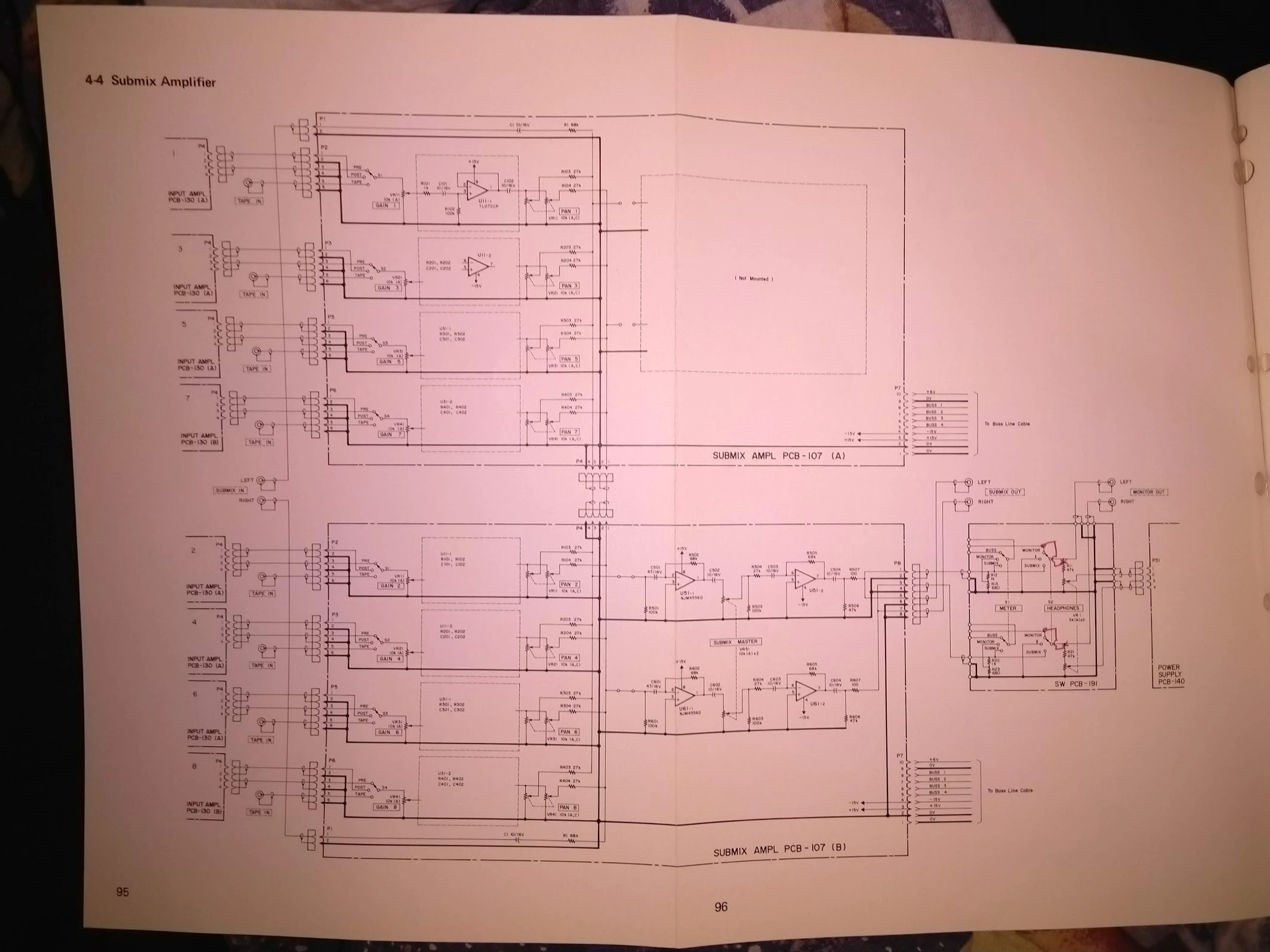

OK I see what you mean, well here's the submix amplifier schematic, perhaps you can read it despite the dodgy photo quality.. I don't have a way to scan at the moment but there is also a schematic for the inputs, master monitor amplifer, power supply and the wiring.
