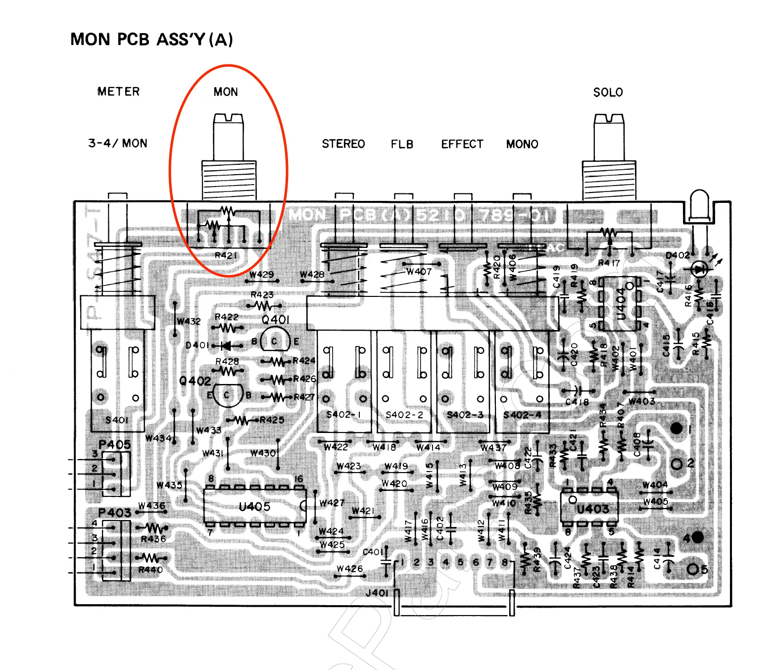

Edit: I have this same issue, trying to find a replacement pot atm, anyone know the name of the pot for the headphone monitor?
Found out it is this:
Ref no. R421
Parts no. 5282411000
Description: 1S2UVR 12, 20KCX2

It is R421 on the MONITOR PCB. It is a 20K A-taper pot with two elements in tandem…so it is marked “20KAX2”.
But before you go further, what is the specific problem you are having? I ask because the pot is fed by 4000 series logic (an LC4966) and there is a pattern of those going bad in a number of period Teac devices. I think this is because, and this is one of the very few issues like this in a Teac device where I’m, like, “well *that* wasn’t the best idea…”, they powered the device using the +/-15V rails, and the device has a max 30V peak-to-peak input power rating. Now, there are usually dropping resistors on the power rails of each PCB in this era of Teac stuff…like usually 33R or something, which drops the power a little bit…not a lot, but a little is better than none when you’re powering an active device at its input capacity, but I don’t even see those on the MONITOR PCB…I see them on the INPUT PCBs…22R there…but nothing on the MONITOR PCB. So that LC4966 is running right at capacity all these decades. So what’s going on with your headphone output?

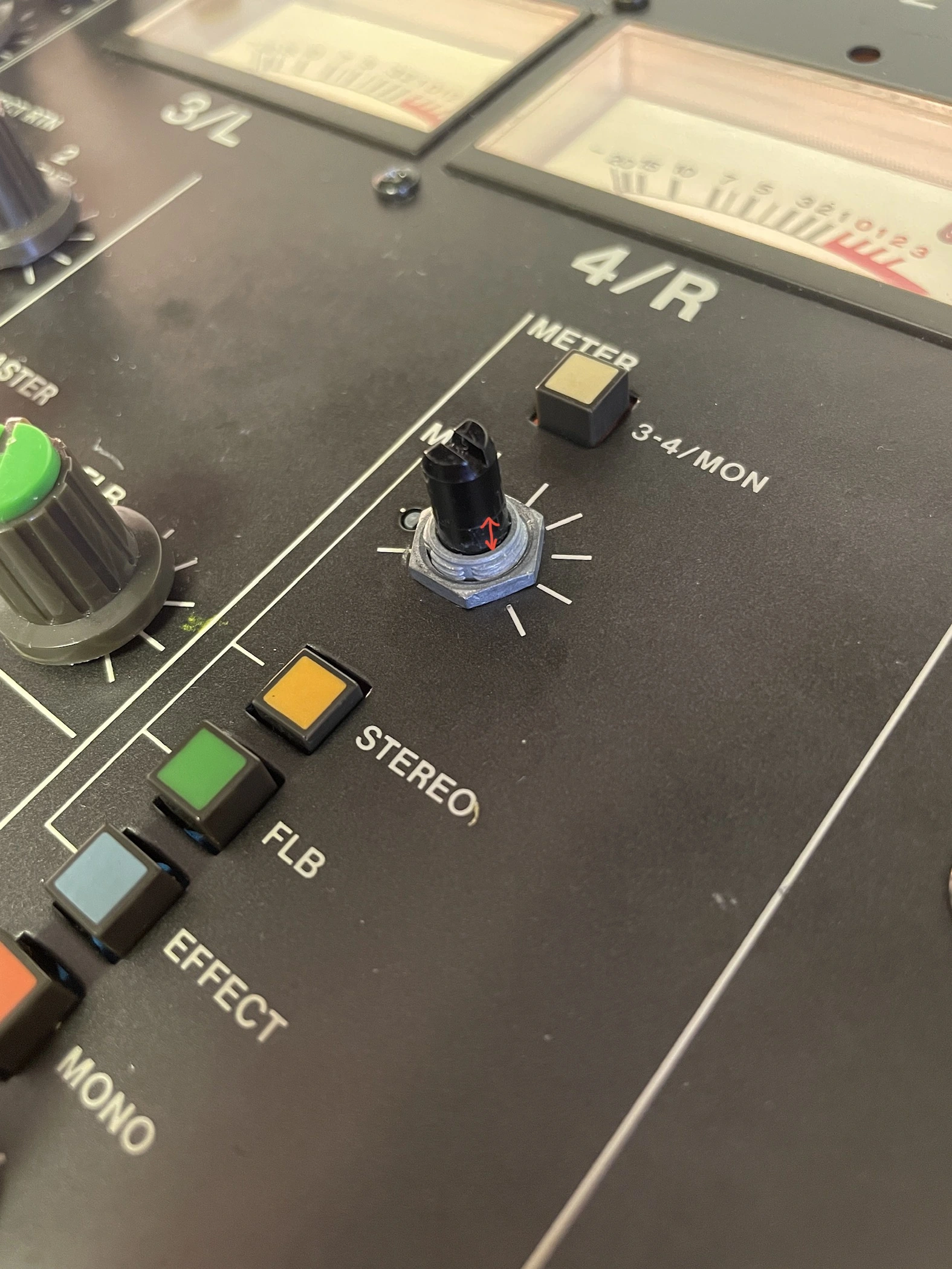

Hi @sweetbeats just circling back to this as I opened up the mixer to take a look again at this headphone monitor issue (just plays out of one headphone, but works with both when I press it down) I re-soldered the connections to the board for the R421 monitor pot but it still does the same thing, tbh the solder joints looked fine and nothing was loose on there. What I did notice is that the actual plastic part of the knob moves up and down within the metal chassis when I press it, which doesn't happen for any of the other knobs on the board, which must be the reason for the lack of connection to feed both L/R signals through to the headphones. Have you ever come across this before?
Refresh my memory…works when you press what down?
How much does the pot shaft deflect approximately?
When I press down the knob itself. The plastic shaft moves about 1mm max 2.

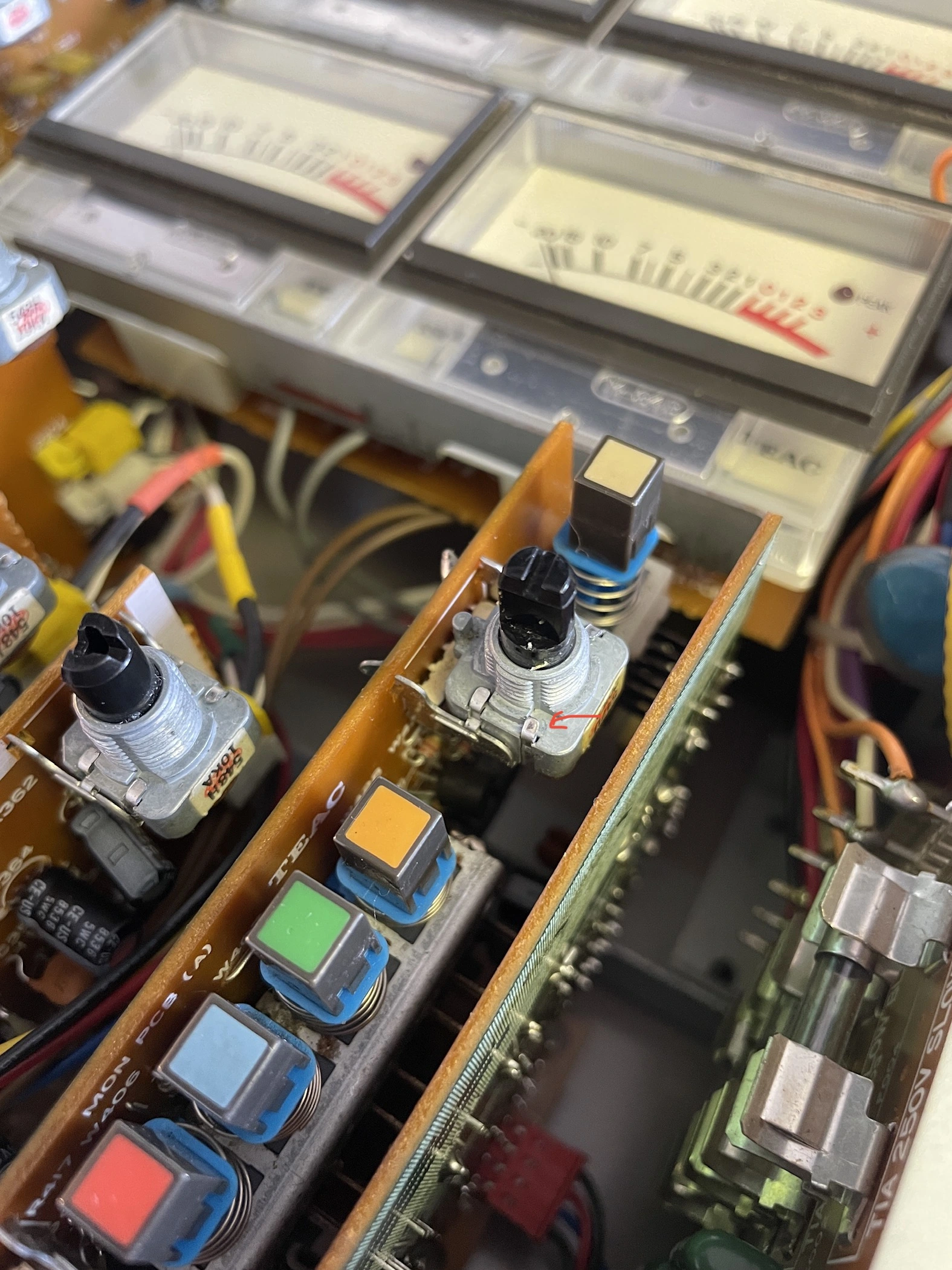

Unfortunately there no replacement parts for this pcb anywhere online so a fix (if possible) is only solution. Can i remove the shaft part from the metal holder and potentially try repair something under here, or is that a terrible idea?

You can replacements for that part. You’re just not going to find by searching for M-208 headphone pot. You have to search by the specs for the pot which is a dual element 20K ohm A-taper pot with a 1/4” ‘D’ shaft. You’ll find this abbreviated as “20KAX2”. You’ll also want to measure the shaft length. So then you go to Mouser or Digikey and search for pots with those specs and look at the data sheets to verify the pin configuration. I know some or all of that may be unfamiliar to you, but my point is it’s not a matter of the pot not being available, you’re just not going. To find it searching by make, model and function.
And sure you can try to take it apart, bend those tabs you see on the top over and see if you can remove the top to access the inside. I don’t know how easy that will be depending on how it’s constructed…I think there is one element with two tracks, so that will be easier to disassemble vans pot with two separate stacked elements with one track each…I have to look at the PCB layout to see the pin layout…okay yeah I think it’s a single element so you can try just bending those tabs over and pull the top off and see if you can see what’s going on in there. It’s normal for there to be okay in the shaft, especially on plastic shaft pots, but it may just be you need to gently deflect on of the wipers so it makes better contact with the element.
