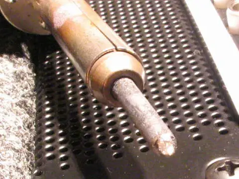

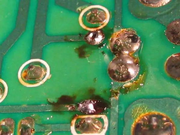

Soldering Frustration...
Tried to solder the resistor back into R5 on the Mother PCB.
I can't get the solder to weld to the PCB! :mad:
Well, maybe it is welded in one spot, but the other joint is not welding with the PCB. I don't want to damage the PCB...
Maybe it has something to do with my iron:
Older basic Radio Shack iron...tip is ugly...I have a new iron on the way.
Could that be the problem?
Here is a closeup of the iron tip as well as a closup of the joints on the PCB...nothing stuffed in that pic...I pulled out the one I was putting in because the joints looked so bad.

A new tip on that iron might help.... or possibly a better iron. I'm sure tehre are many people that can give you better soldering tips - I can operate an iron but I wouldn't call myself expert by ANY means.
