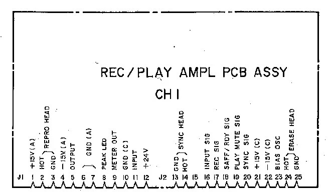

Please look at the jpeg attached below of the input/output connections on the 58 amp card. I’m going to take a crack at understanding the current inflows and outflows. Correct me where I’m wrong, fill in the blank where I’m clueless. “In” and “out” are with respect to the card (i.e. “in” means current flowing into the card, “out” means current flowing out):
Pin 1 in
Pin2 out
Pin 3 in? Do the ground circuits for the heads go back through the amp cards? It appears so according to the amp card schematic, but I want to confirm if that is right…I'll put up a schematic if needed...
Pin 4 ??? Its that negative voltage thing…
Pin 5 out
Pin 6 out
Pin 7 out
Pin 8 out
Pin 9 out
Pin 10 out
Pin 11 in
Pin 12 in
Pin 13 in?
Pin 14 out
Pin 15 in?
Pin 16 in?
Pin 17 in?
Pin 18 in?
Pin 19 in?
Pin 20 in?
Pin 21 in
Pin 22 ???
Pin 23 in
Pin 24 out
Pin 25 in?

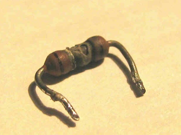

The victim has been excised...

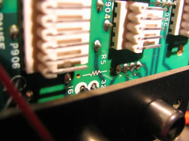

Pulled the Mother PCB out to get R5 off the board...it is aptly names "Mother", as that's exactly what it was to remove it...47 connections to remove I think, and many of them zip-tied together in spots that were hard to access in order to clip the ties...I thought about trying to desolder R5 through the card-bay, but thought better of it. And by the way, I can really see why the RCA jacks are an achilles-heel on the 58. It is a crazy design. The PCB itself is mounted to the frame with 9 screws I think, which is a good thing since its gets the abuse of amp cards being pulled and reinstalled, and it is further supported against the back cover panel by...you guessed it...the 8 platforms that hold the RCA jacks. So in a sense the pieces that hold the RCA jacks also supports the PCB when installing cards and that thing is held to the PCB by nothing other than the solder joints for the jacks. :eek:
Here is a pic of the current state of the 58:
Went to my fav electronics shop instead of Radio Shack...Had some other stuff to pick up. Looks like size-wise the resistor st R5 is indeed 1/4watt. Got a pack of those and got the burned up one out without a problem. I'll be putting a new one in sometime in the next day or two and then I'll get the Mother PCB back in and start connecting sub-systems up and seeing what blows. Oh yeah, got a bunch of fuses too. :p;)
Here are pictures of the victim of my carelessness, and its former home...

Looks like 1/4 watt to me....
