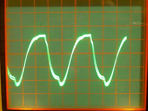

Brought out here, hooked it up to the appropriate test points on an amp card to test the naster bias oscillator frequency, and I hope in my over-confidence Izm doing the math wrong...
I have a probe connect to channel one, vertical mode is set to channel one, VOLTS/DIV is set to .1, TIME/DIV is set to 1 micro-second. I pull in a good sweep, and measure one cycle at about 3.4 divisions...that's...294kHz right? :( About double the 145kHz it is supposed to be...
Don't know where to go from here...don't know if it is a problem with the master bias oscillator, or components on the master bias card...

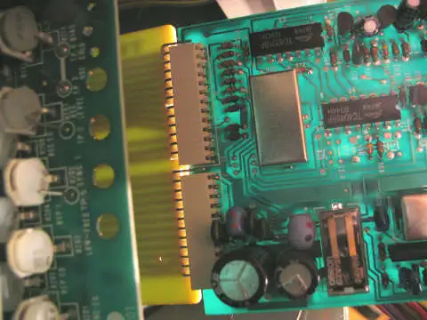

OK, was it offset one pin to the left or one pin to the right? We can decide what was shorted there. Also, which fuses were blown? Test each fuse as that a blown fuse may not be obvious from instpection (if it blows inside the link.)
We want to makesure that you have each voltage.
Back to the scope - I assume that you counted the divisions from one rising edge zero crossing point to the next rising edge crossing point. If you measure from a rising to a falling you would get twice the frequency.
Ah, I guess that would be offset one pin to the left, or down as it is oriented in the deck. Picture below.
I do believe I went rise to rise (or rather I think I did fall to fall). Picture below, and again that is at 1µs. Its about 3.4 divisions to my eyes. Am I reading that correctly?

Rise to rise, 3.4 uS +-.... we can look at that later.
