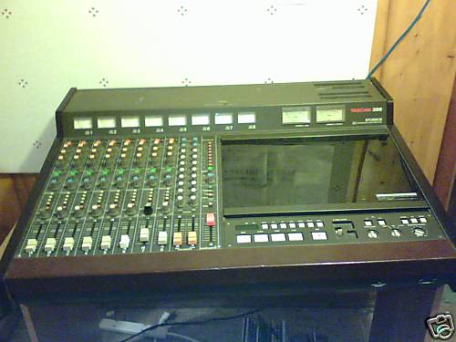

Here are the pics from the listing:
Yes, I agree, the shot of the headstack was worthless but the seller tried to get a hold of a camera other than his phone...he gave it a go.
