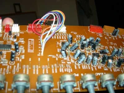

so Tom, did your caps have visual clues that they were off, or at the 'just making noise point" they are perhaps just beginning to fail and have no visual signs? if this is so, maybe sweetbeats has the right idea with recapping everything from the getgo. in any case I don't see anything obviously wrong with the caps I'm looking at - no bulging or leaking. once in a while there is a black mark on a cap here or there, it looks like someone marked it with a sharpie or some paint. anyone know what this is about? is it some manifestation of cap failure, or is it what it looks like, which is that it was marked with a paint pen of some kind for some reason? I've got a picture here, but its basically worthless - I can't take these small clear pictures I see people posting here with the camera that I've got...
black 'painted' capacitor is just about center of picture.
I really wish there would be a way for me to get away with replacing as few caps as necessary, there's something like 32 on the "buss pcb assy B" alone:eek:. I also wish there were some way to check caps without getting them off the machine - when I invent my own universe, you'll be able to check capacitors on the pcb board!:rolleyes:

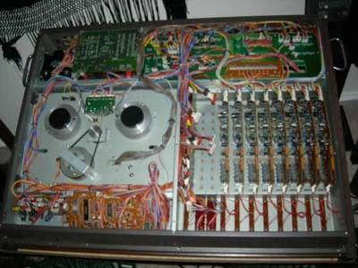

... its a little sad to have her all taken apart and upside down when just earlier today she was playing the tape of my first test recordings...
but I'd like at least to take care of the AUX / EFF noise before I start in earnest. I can't really think of a work around for this (well maybe use the monitor out as an effect out?)

Most of the time you won't really be able to tell if a cap is bad just by looking at it. They do sometimes begin to bulge (look at the top, and the bottom where the leads come out) when they get really old, but perfectly normal looking ones can be bad too. If i see a few that look suspect, or i know they are old, i almost always try and replace the whole bunch.
The sharpie marks: I've seen that too! I think it is something that was done at the factory during assembly or QA. It probably doesn't have any significance for what we should be replacing. My mixer was the same though, red and black sharpie marks here and there.

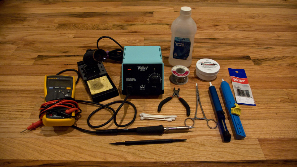

One year ago i was a recapping virgin as well. It only takes a little bit of practice to get comfortable. And there are some tools that will help make things easier. Here's a quick photo of the tools you'll want to have:
I started out with a cheap soldering iron from radio shack. It worked fine for a while to learn on, but there were times where it seemed too hot or not hot enough, and the tips for it were kinda cheap and wore out quick. I finally broke down this winter and got the nice Weller Soldering station with the adjustable iron. It's been well worth the 90 or so bucks. Being able to adjust the temperature of the tip is great and helps you avoid burning the traces. The replacable tips are nice too, they come in different sizes and shapes and generally last longer than the cheap ones. The other stuff in the photo... Solder sucker pump(s), tiny wire snips, long skinny forceps/pliers, rosin-core solder, a tub of rosin flux, rubbing alcohol, q-tips and a plastic poker thingy.
Once you have the supplies, find a old junk PCB that has a bunch of stuff on it, maybe something out of an old junked VCR and practice desoldering and re-soldering the caps on it. It will help ya get the feel without risking your 388. Focus on getting the caps off nice and clean without getting the PCB too hot. On some PCB's the traces will peel up if you get them too hot or burn them. Clean the empty traces and holes with the q-tips and rubbing alcohol.
Next, take inventory of all the capacitors you'll need to recap the PCB. Make a list of each cap's value (XX uF/ XX V) and how many of each. The ones in your photo are the "radial" type, where both leads come out of the same end. "Axial" capacitors will have one lead out of each end. You can get a good initial capacitor count by just looking in the manual at the parts list, but i'd take inventory of what's actually on the PCB too, just to be sure there's no discrepancies. Also look in the manual for any special notes about the capacitors. If a certain cap says B.P. it's a bi-polar cap (meaning that the leads can go in either way, no + and - side).
Once, you have your list, you'll need to pick out and order the caps. I find myself using Mouser the most, but sometimes i get caps from DigiKey and other places too. It mostly depends on where i find what i need. Once your caps arrive in the mail, you'll be ready to go.
I wish there was an easier way to test caps too. At the very least you'd have to desolder one lead just to test them with a capacitance meter. And, it's probably easier to remove the whole cap/both leads, really. Even if the cap tests fine, it's still old, so you might as well replace it with a new one, since it's out. :) I kinda look at it the same way with the whole PCB, you've taken the time to unplug everything and remove it from the machine, so you might as well refresh all the caps on it before you put it back in.
