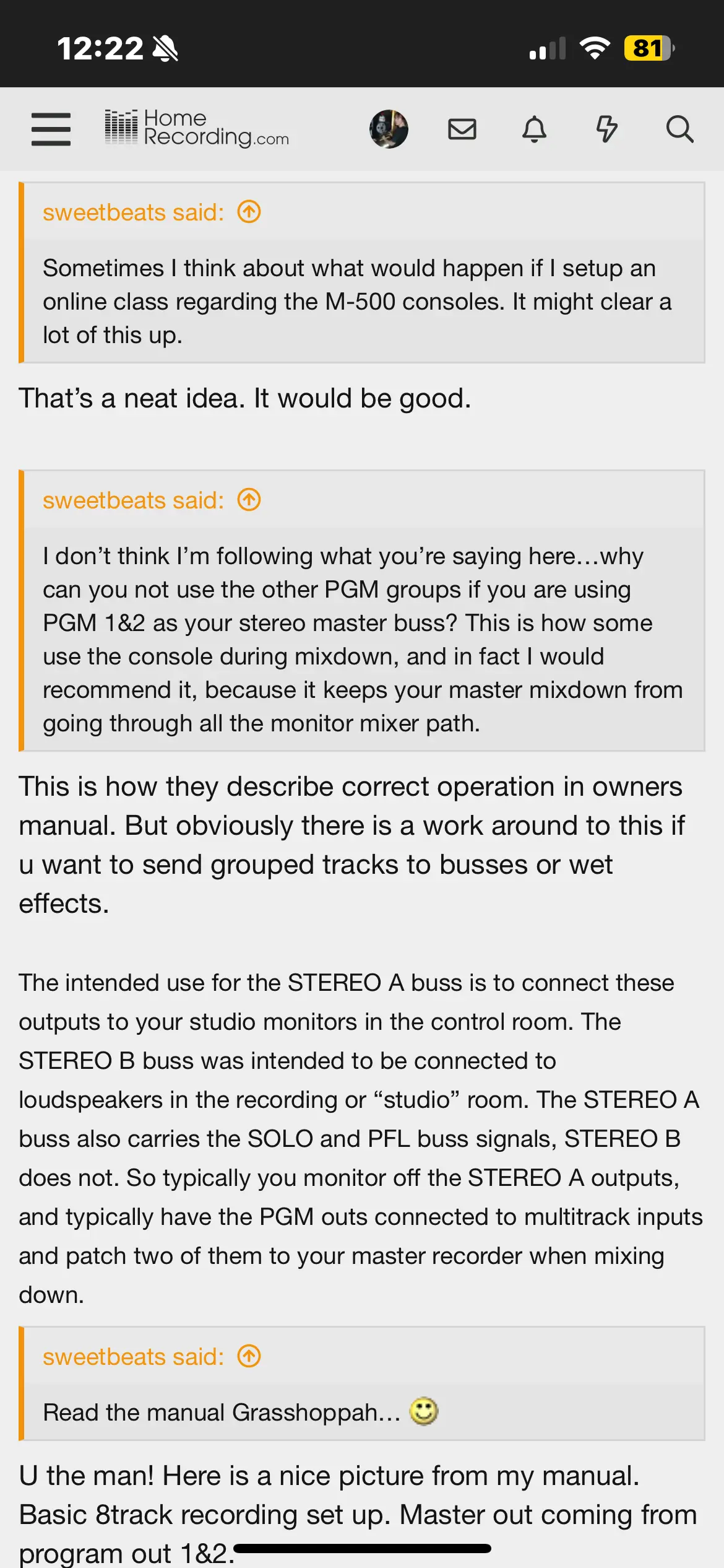

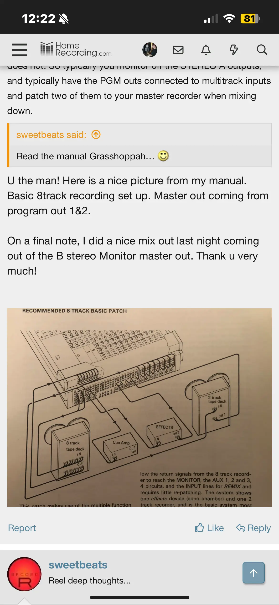

okay so…. think i just answered my own post while researching. as expected, the resident expert in all things tascam M series related once again teaches me valuable information.
I suspect that stereo master, is a good clue for where the designers expected the users to take the signal. In all the years I have been doing this kind of thing, the master outputs went to tape, then MD, or CD or DAT and now my preamp ins. I work on the principle that in the basic circuit diagram, the only differences in output are where the busses have individual output sections, each one optimised to a specific level - the old .7V or 1.4V levels, with either balanced or unbalanced outs to suit the devices. I never noticed ANY differences in quality - the only thing would be using the low output to drive the device expecting a hotter signal and having to add extra gain. The quality was the same but signal to noise a bit worse. However, that was very rarely an issue. None of the mixers I have ever owned had different quality at the various outputs. All I want is a recording of what comes out of the speakers. routing and panning to use individual outputs seems to me, to be totally pointless.
The M-500 “STEREO” busses are not really intended for main summing…they are essentially the CONTROL ROOM and STUDIO outputs. To minimize the number of unnecessary amp stages I would use the RCV jacks for inputs, some to a pair of PGM groups, and feed the master recorder/computer using the PGM BUSS outputs. If you need more trim level coming into the M-512 I wouldn’t shy away from just using the TAPE IN jacks as designed. There’s only one amp stage additional there and it’s line level as opposed to mic level, and being able to trim the input and maximize the dynamic range is smarter gain staging than avoiding one low noise line amp stage only to have to boost another downstream and the noise at input with it. But the M-500 series design does not intent for you to use the STEREO A/B outputs to feed the master recorder. They intended for you to use a pair of PGM outputs and you monitor those via the STEREO buss.
