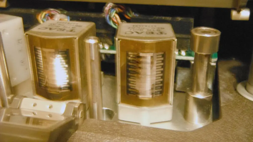

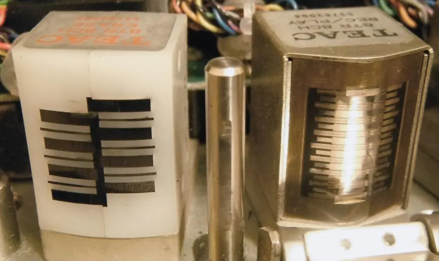

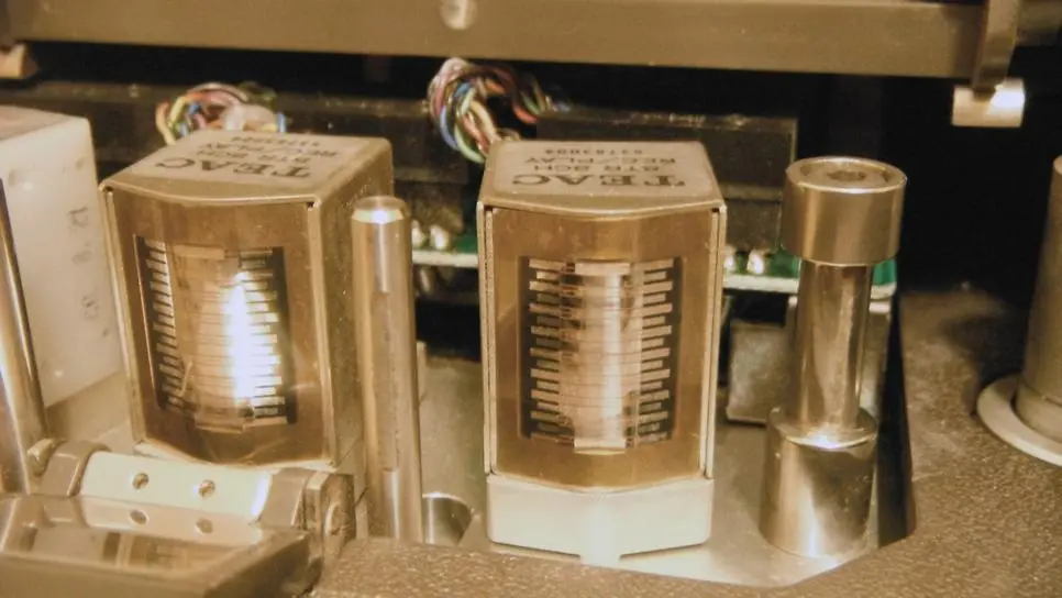

I have had this tape with me for a few days. I have gone trough it and cleaned everything. The heads were as you said with an Apex tape on board. I have included some images of the heads which I hope are clear enough for some sort of opinion on them if not from you then maybe from another member of the forum. I can see that there is wear, but I don't know enough to tell if they have had it or not. Also my eyes are not so good these days. Hope you can help. I have a new tape & demagnetizer on order.
