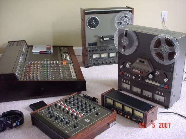

TASCAM 34 taking the face off
Can you spot the 34?

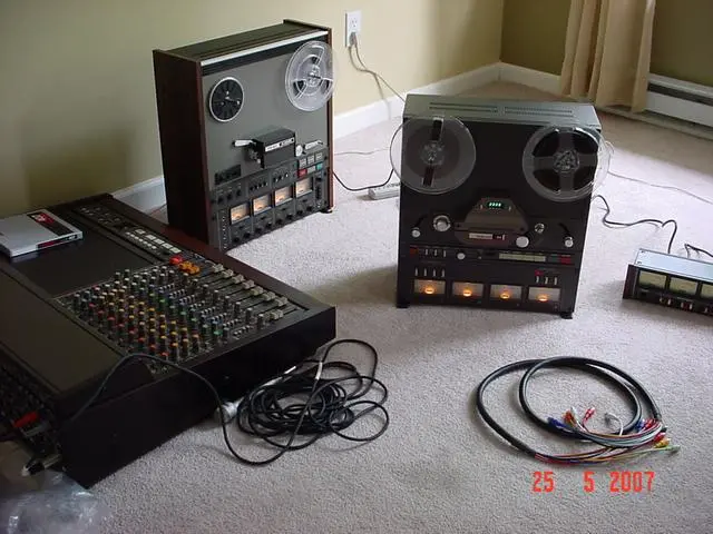

Another one..

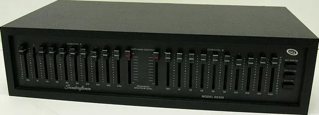

That's not all, 'cause I still have the TASCAM M30 and 244 boxed up, not to mention my LXP-1 and DBX 118 / Microlimiter etc... ;)
But where's your Soundcraftsman graphic EQ w/ cut-out cardboard curve setting templates? :D
G.
Wow, you got some minty decks there:rolleyes:

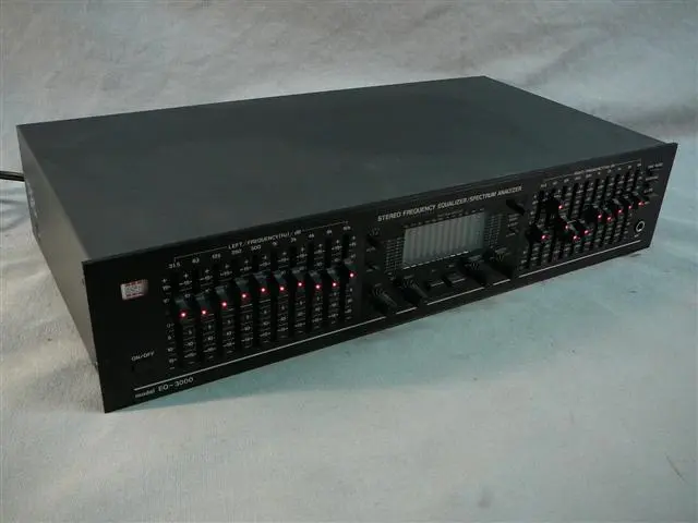

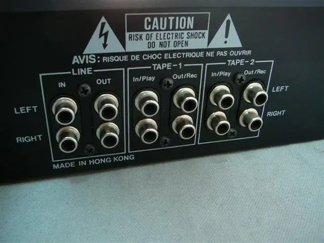

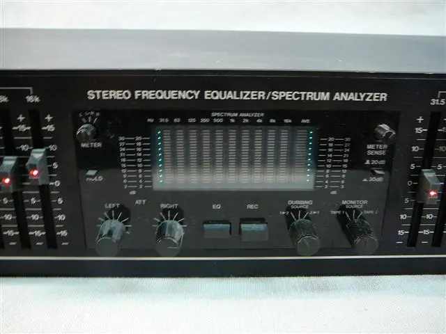

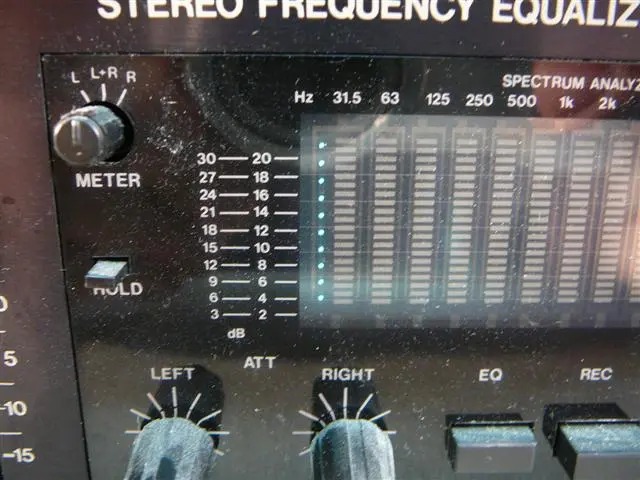

You need this!..........:eek:;)

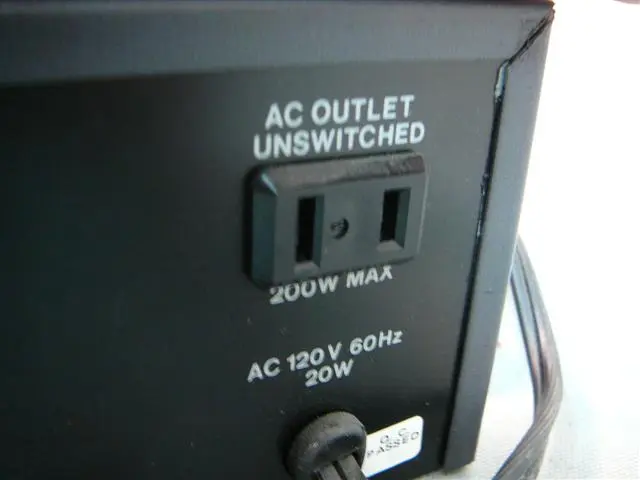

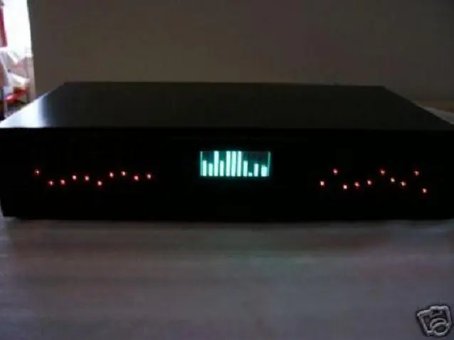

....................:eek::rolleyes:
