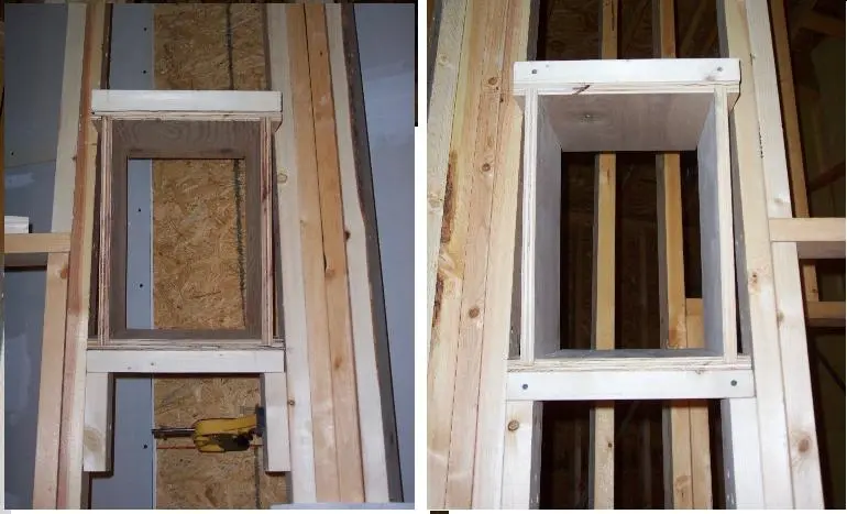

You guys are probably sick of me and my pics by now, but I actually have a question this time.
The following pictures show how I intend to mount my rear surrounds.
The "soffit" is actually built INTO the wall, rather than ONTO the wall as is typical in soffit mounted MAINS.
Is there any problem mounting the REAR SURROUNDS this way?

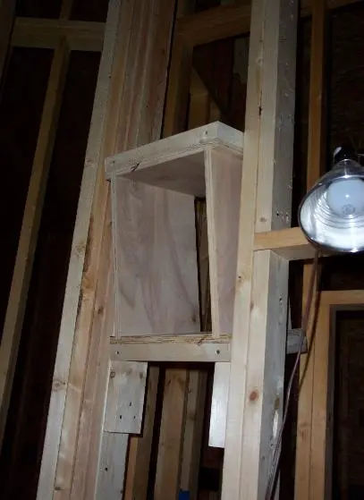

Here's another view:

About the surround speaker mounts. Are those going to penetrate your control room shell? It looks like it. Won't that compromise the iso construction?

Hey Michael, I just noticed something. The boxes are fastened to the CR wall, correct?
IF so, maybe check barefoots design for fastening to the wall behind, whereby the isowall doesn't get structural transmittal throughout. I don't know if its applicable here, but his main soffit design is pretty cool. Anyway, its a thought.

Well, the speaker fills the cavity. It fits it EXACTLY. In fact, you have to really push it in there to seat it. Couple that with a solid wood "beauty plate" around the front, and you've got an air-tight seal.
I suppose I could put a back on the mount, but I'd be concerned about heat generated from the amp.
I'm using Event 20/20 bas's.
I dunno. Uncharted territory here....

Yeah, see, I thought about that too. Will the entire wall reverberate from the music played through the speaker? Maybe. But keep in mind these are REAR SURROUNDS. They wont be used for day-to-day tracking and mixing. In fact, I'd expect they get used only about 10% of the time. And 8% of that'll just be me showing off! :p

Unless someone comes in and slaps me down, I think I'm going to go this route.

For now, some basic points - according to Thomas, your baffle extensions (the wall surface you see as a finished install) should be quite stiff, NOT hard-coupled to speaker boxes, and several (like maybe 4-5) woofer diameters in any direction if possible. He's stated that speaker boxes tend to put out enough vibrations that they should be decoupled from the "baffle extensions" known as "soffits", or more correctly as "flush mounts" - Ideal, if you were building a super-anal, million-dollar room, would be concrete pedestals isolated from the rest of the concrete floor, with speakers mounted on them on thin pads (to avoid buzzes) - then these isolated "towers of sound" would be surrounded with a fake (but stiff) wall (the flush mount part) that was even with the front baffle of the speaker, did NOT touch the speaker but with less than 1/4" gap, said gap filled with soft fiberglas or similar, and again with the baffle extension continuing in the same plane as the speaker baffle for at least 4 woofer dimensions in any direction.
The large area of baffle extension keeps the speaker from exhibiting a "horn effect" for the woofer, which can narrow the sweet spot - that in turn can make the surround effect spottier than it otherwise would be.

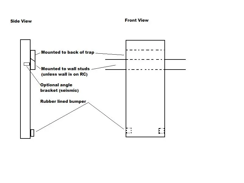

One method I've considered along this line to "have your cake and eat it too" is movable absorbers of some kind to be placed on front/side surfaces when mixing in surround. I've drawn one method on John's site that uses beveled "rails" to hang absorbers on when needed -

For the degree you want to use surround for, other than path length (you didn't mention if it's equal) before you go any further I would enlarge your mounts enough to allow for a little more space around the 2020's, and set them on approximately 1/4" pads, softer than the typical neoprene - I've found that most "mouse pads" are a good consistency for isolation without allowing too much "rocking" of the speaker due to low freq cone excursion.
Then, you need enough space around the other sides of the speaker boxes for some "stuffing", as I mentioned - if you keep the actual opening thru the heavy "baffle extension" so that the gap between speaker and baffle extension is 1/4" or less, that will satisfy the need to eliminate diffraction effects of the lower mids "wrapping around" the edge of the speaker - the "stuffing" between speaker and baffle extension keeps this from being a problem with higher frequency, shorter wavelength sounds. For looks, some thin black or charcoal grey foam evenly pressed in around the speaker would keep things flush without showing any of the yellow fiberglas that's alongside the speaker box.
Ventilation for the amps has been drawn by John somewhere on the site, forget where - bottom and top of the flush mount's venting, basically, with absorption "breaking up" the possible reverberant "organ pipe" effect of an air column.

Only the basic drawing of the "rail mounted" temp absorber hangers that I drew - Barefoot's drawings of isolated soffits are on John's site (still down last I checked, but supposed to be up today sometime)
If I remember correctly, Barefoot's design cantilevered the speaker mounts off the inner wall, then placed the baffle aligned with(but not touching) the "baffle extension" or flush wall part. Sort of like if you "lean out a window" to look around, but are careful not to actually touch the wall around the window with your body...
I'll see if my rail mount drawing will fit here, John's has a larger file size limit. Oops, wrong computer - this is (I think) the simpler of a couple... Steve
