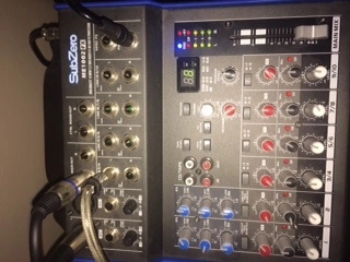

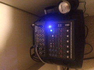

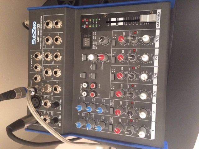

Firstly, thanks for all your responses. I have tried the volume on the head phones and still nothing. I had an email from gear4music and they said the buttons on the left CTR would solve the problem - still no sound though! I have attached a couple of photo's in the hope this may help if anyone has any more suggestions.
Just to say I really appreciate your time and help.

These pics show the 'Main Mix' fader at the bottom of its travel. If that the way you're running it normally it's wrong. Push it up to where the '0'(zero) number is. All the buttons should be in the up/out position.
Your monitor is plugged into the left output, so music in the right input might not get to the left output. Plug the monitor into the right output and see if that works. Not sure if the Pan control would shift it over there or not. Do you only have the one monitor?
OK - thanks. 'Main Mix' fader is now at zero and the volume turned down else on the output. I am only running one monitor. Still no sound from the head phones. plugged into right side and no difference.

Hey Neil, in the numerical display for the effects, is only a single number '8' on the right showing? Is the left side of the display not lit? And if you push the effects 'Program' knob and turn it do both digits of the display light with a two digit number. If you only get one digit, I'm beginning to think you may have a defective unit, including the headphone part of it.
