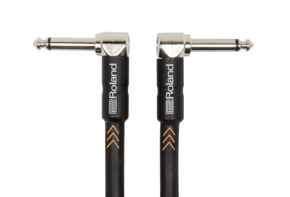

Yeah, for sure, I've never heard of phase polarity! I will be learning many new things when setting this up. That's for sure! About the extension cords Gecko, do they do them with a right angle like jack leads? That would be a good idea even is the cords are long enough anyway. Otherwise the speakers will have to be miles from the wall! Anyway, I will Google it and see what I find. Thanks again.

An extention cord is used to extend the power cable that comes with the speaker. It is a power cable with a male wall plug on ones side and a female wall socket on the other.
All the speakers you have looked at have standard IEC power cords. You can buy IEC power cords that are 5 or 10M long. You can get IEC extension cords as well. Just look on Amazon for something like this. They run about $10 or so. And yes, you can buy right angle power cords as well.

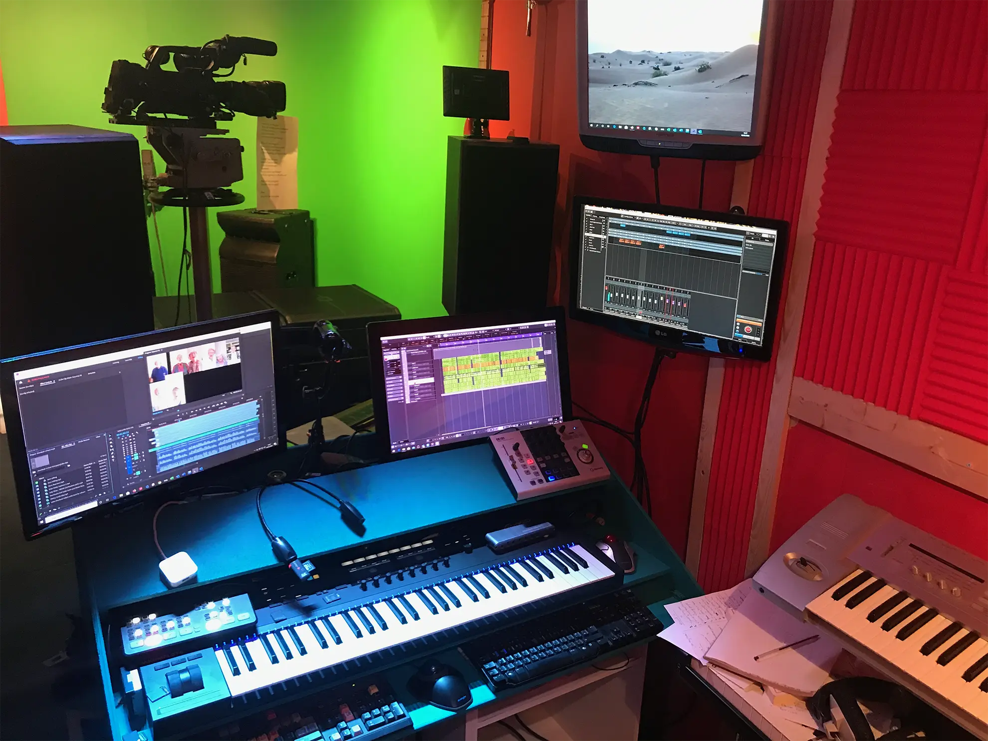

If you look at the picture of my studio - to the right behind the monitor is a floor to ceiling foam strip. That was where the wall used to be, and I had turned the recording room into green screen area for some video work in covid. I took the wall and the dividing window away and the foam - which of course doesn't really do much for the acoustics is there simply because the walls were a mess where I joined the two room within rooms into just one. The foam just hides the 'bodges'. My monitor speakers are now 5m from the far wall, with about the same, maybe a bit less behind me - and they sound so much nicer, and the room doesn't need the old bass traps I had. All I have added is a rockwool filled panel 1.5m x 60cm above where the keyboard is, as the angle on the desk made a weird sort of reflection that messed up the stereo imaging. The panel on the ceiling fixed it. I've never known anybody do this before, but this way around is so much better than spinning the gear through 180 degrees and having the speakers at the end.
