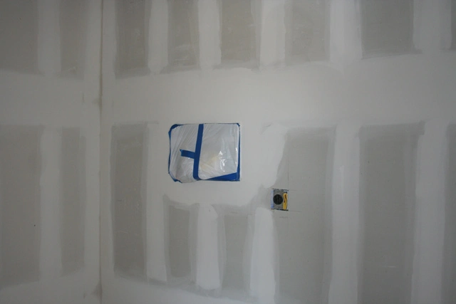

Okaaaaay. got some more pics for ya.

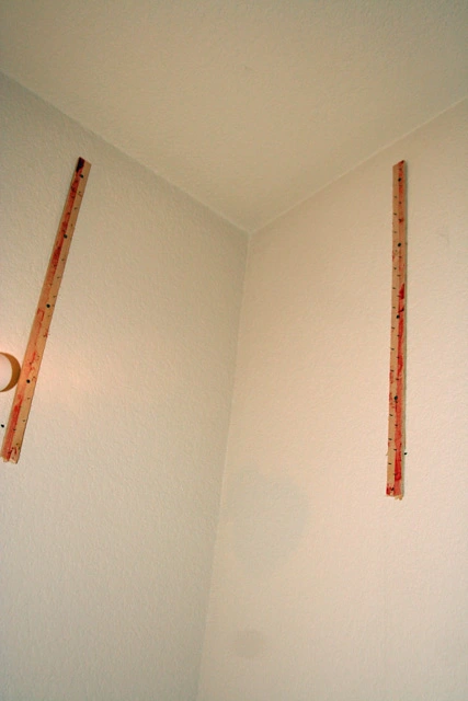

Fisrt one is after drywall was hung, taped and mudded.

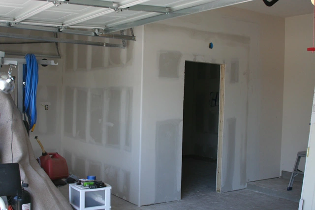

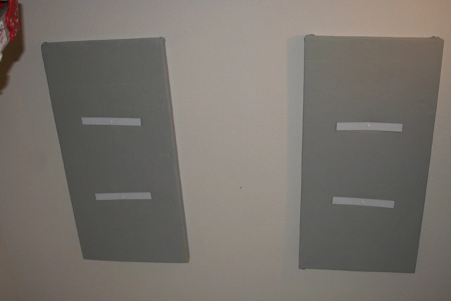

2nd is a/c in drywall. The drywall guys did a good job fitting around the a/c.

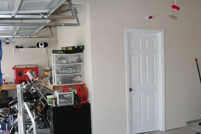

3rd, we're taking a bit of a time leap. Walls are textured and painted. Door is hung. Note: I hate doing doors and this one was no exception. I put Great Stuff expanding foam between the casing and the wall studs. It, of course, expanded and pushed the door jambs out of shape. Duh!!! I had to cut the door down to fit, then the door knob didn't install properly because I trimmed the door on the door knob side. What an idiot I can be sometimes!! When you trim a door, do it on the hinge side!!!! Okay. All inspections are done, inspector loved the room. Electrical turned on. I also built a workbench and moved my crap (and my Harley) over there.

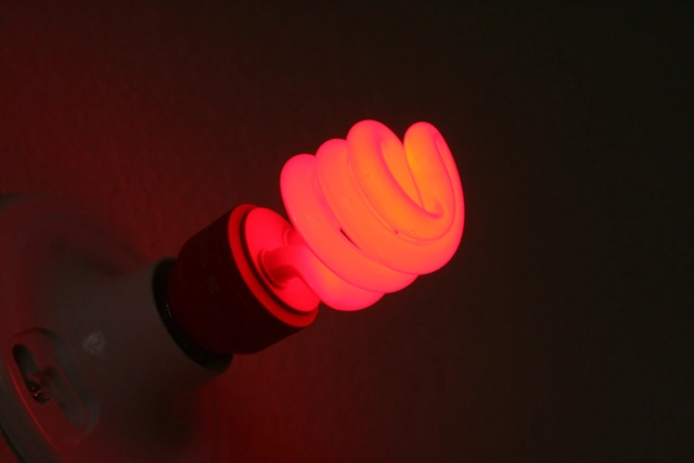

4th, Yes Kinetic, I am telling you that light outlet is for a Recording lamp. It was a last minute decision to put one in. I didn't need it, I thought maybe it was a little over the top. But I had all the stuff, took me a minute to run the electrical, etc., so, what the hey. I picked up one of those CFL style lights and...
...it's a little nostalgic, a little funky. I LIKE IT!!!

The fact is, the room is small and I do more than music in here, so stuff piles up quickly. Thanks for checking out the thread.
