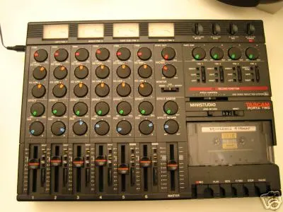

I'm gonna throw a different spin on this, for a minute.
There's only one device I know of that will do field recording and multitrack recording with more than two inputs,... it's the Tascam Porta Two.
The Tascam Porta Two is an older 80's vintage model, that has 6 input channels, and records to 4-tracks simultaneously to tape in Direct mode, plus runs on batteries and has strap buttons for field use. The Porta Two is a VU-meter style unit, and records to cassette tape. The Porta Two (std) is a "normal" speed device, but the Porta Two HS is a "high speed" device, which will give you noticeably better high fidelity to tape. These are both Ebay-type items.
As I see it, the Porta Two can be used for field recording, plus your multi-channel/multitrack band recording. You can record and mix down on the same unit.
Also, the resulting 4-track tape recordings can be dubbed from the Porta Two (std or HS) to the 'puter, for further manipulation and/or burning to CD.
It's probably not the answer you were looking for, but that's my 2¢ worth. ;)

Heh . . . I'm not turning down any advice at this point! But . . . recording to cassette tape? I know I'm on a shoestring budget here, but that brings up a lot of questions in my mind. Fidelity? Tape/machine noise? Method (and ease/difficulty) of converting to digital for computer manipulation?
Thanks for your 2¢ . . . wanna turn it into 10¢ or so? ;)

A decent quality cassette 4-track recorder can be fine. However, I would worry too much about a unit with onboard batteries. You can get an inverter for your car, or simply carry along an inverter and a small 12V battery. SIAB's don't consume much power. Actually a plain ol' UPS would work pretty well, so long as you get a unit where you can turn off the alarm :)
Eh,...
Based on your original post, (IMO), the Porta Two satisfies your needs on a both levels.
A) collecting of sounds in the field.
B) ability to record, mix & master your band's music.
Two worthy, but high demands to expect from one device.
(You're also on a budget.);)
First, "collecting of sounds" implies "field recording", which then implies having the ability to run on batteries, if necessary or if so desired. The Porta Two works either on a standard AC adaptor for home use, or on batteries for actual field recording.
Then, "recording/mixing/mastering" of your band. This is a more demanding requirement. The Porta Two's built-in mixer enables you to do many complex mixing tasks, both in the recording and mixdown phase of production. It records 4-tracks simultaneously (to tape) in direct-mode, which gives higher basic production value than standard 2-track recorders.
Dbx is a noise reduction used on most Tascam Portastudios, that virtually eliminates tape hiss. Using Type II cassettes and dbx NR, the specs and sound quality of the Porta Two would be comparable to it's all-digital battery-operated counterparts, (being the PXR4, MR8, Zoom PS04, Boss BR-532, minidisc portables, etc).
You'd be using regular mics, so there's not a big concern of "tape machine noise" picking up on any recording, as you might get from any built-in type mics. The tape mechanism's remarkably quiet, anyway,... a non-issue.
In contrast, the PXR-4, MR8, BR-532 & minidisc portables have an internal mixing function that's used on playback, but there's no mix section that may be applied to the recording function. It's just 2-inputs, recorded raw and straight in. For any mixing of your live sound, an external mixer must be employed.
Also, the PXR-4, MR8, BR-532 & minidisc portables only record 2-tracks-simultaneously/max, which is fairly limiting. They may do 4- or 8- tracks total, but only 2-tracks at a time. In simultaneous recording mode, they're only 2-track recorders. The #-max-track/simul recording capability of a recorder becomes a very important issue in respect to hifi production of live music.
Recordings you capture on the (analog) Portastudio may be recorded over to the 'puter, for further processing, burning to CD, etc., through your soundcard.
Any battery operated recorder will record field sounds, but very few of them will do it with high fidelity, as well as be a recorder capable enough to fully produce your band,... in the "mixing/mastering" sense.
If you're looking for single recording device that's portable enough for field recording, (batt-op if necessary), AND will record/mix/master your band with a fair amount of complexity and high production value,... that's also affordable, then the Porta Two's it. It has all that in a small, portable package.
If I had to choose an all-digital unit from the field of battery operated recorders, I'd probably choose a Hi-MD, or Fostex MR-8, and call it a day. However, due to the lesser mix function and 2-track/simul/max hard limit, none of those all-digital/battery-operated recorders are as sophisticated a production tool as the Tascam Porta Two.
If you're talking about any other type of portable recording or band audio production with available AC line power, then my recommendations would be... another analog Tascam Portastudio! The Tascam 246 or 424mkII/III.
As always, YMMV.
Thanx for listening.
First, Laure, I would not dismiss A Reel Person's suggestion out of hand. He has forgotten more about cassette recording than I will ever know. As far as how the sounds would get to the computer from the Tascam- the same as the Pandora. You run the tracks from the line out of the Tascam into the sound card's line in, in analog, in real time, and process them in the PC using recording software. No difference. You're dealing with an audio signal, not a data file. The sound card does the analog to digital conversion.
I've got just one question Reel Person, and don't misunderstand me, I'm really not clear on what you mean when you say the Pandora has no mixer section. As far as I understand what a mixer section is, that's not true. You can apply different EQ and compression, fx, or whatever to the individual tracks. You can bounce tracks to create submixes, and export those submixes as audio signals, and then undo any of it (try that in analog). If you know how, you can use the line out as an aux send and process tracks through outboard equipment and route it back to the Pandora's line input onto a different track, or re-amp tracks. Please explain to me what it is that the Tascam's "mixer section" does that the Pandora can't do. The only thing I know of that it can do that the Pandora can't is record 4 tracks simultaneously with cool analog meters (which I admit I prefer to LCD level indicators). It can also record more data without changing cassettes/cards.
Please note that I, for one, believe your suggestion is as valid as mine, and I agree that what Laure wants to do could be done that way. I think cassette recording comes with certain up-sides and down-sides, like any other recording system. The biggest up-side is it's easy to learn and to understand, compared to a menu-driven digital recorder, and is relatively inexpensive. The biggest downside is that it involves moving parts, which create noise, and are subject to capstain drive failure, wow, flutter, etc. This is especially true of older, used units. I believe that done properly, Reel Person's suggestion could work.
On the other hand, the Pandora offers many capabilities you won't find in a cassette, such as a metronome for click tracks, drum tracks, a compressor,
noise gate, complex editing capabilities, track bouncing, seamless erasure of sections of tracks, zero mechanical self noise, undo capabilities, and a wide array of other features. I also understand that track EQ is more easily accessible on the fly on the Tascam. The BR-532 and the Zoom units I am only a little familiar with, so I really don't know what they can do. In short, I believe that the Pandora can do a lot more than Reel Person thinks it can, and the Tascam can do a lot more than Laure thinks it can.-Richie
First off, Reel Person, thanks for your reply--that was considerably more than 10 cents! And no, I'm not dismissing the analog cassette tape concept out of hand--frankly, I don't know enough yet to do so. From what I gather, the Tascam might be the better choice if I decided to go with trying to record my group--more tracks simultaneously in a simpler way. Then again, it's less portable than the oh-so-light and small PXR4. Either way, it's a good suggestion, and price may end up being the deciding factor since my learning curve will probably be more or less the same on any machine of this type.
There are actually a couple of the PXR4s on e-Bay right now for $120-$200 or so, and one of the Porta Twos . . . but oops! That only has about 4 hours to go. Not ready to decide quite that fast. :D
I'll be interested to follow your discussion here to see what else I can learn. Thanks again for taking a newbie's questions so seriously.

I have a 424mkII that saw use up until a year ago, and you can definitely do high quality work on cassette. Tomorrow I'll try to post a track I did with a Peavey mixer, the 424, and a couple of Shure SM57s--definitely a humble setup, but it sounds very good. Of course I was recording actual talented musicians (as opposed to me) in a large space.

Richie,
I gave that paragraph a lot of thought and applied a heavy edit, to where it's hopefully more accurate. Please read my statements above carefully.
The PXR4 obviously mixes it's 4-tracks with an internal mixer. The mixer function is applied to the playback of tracks, only. Playback-mixer ONLY.
What the Pandora PXR4 (and others like it) don't have, is a mixer section that can be applied to the INPUTS, on the FRONT END OF THE RECORDING PROCESS. It's just two inputs, straight in.
I don't consider an "Effects Loop" being applied to the inputs the same as a "mixer", on the "front-end" (input-side) of the recording process.
A Portastudio, like the Porta Two and others, has a mixer section that can mix signals on the "front end" of the recording process,... mixing up to 6 inputs down to 2, where it will be recorded as a stereo signal.
"Front-end" mixing power is an important issue, which is why you'd often hear of hooking the PXR4 or MR8 to the outputs of another mixer. On the Portastudio, the mixer section may be used for "front-end" mixing during recording, as well as the obvious "playback-side" mixing for "final mixdown".
The PXR4 (and other's like it) have many advanced features that a standard Portastudio doesn't have, but the Portastudio has adequate patch points to bring those other accessories to bear by patching an external device into the loop, as needed.
I've emphasized that many Tascam Portastudio record up to 4-tracks simultaneously (max), and that is a lot more powerful than a simple 2-track simul/max recorder, the category of which the PXR4/MR8/BR532/ZOOM and handheld minidiscs all fit into.
On physical equipment breakdowns and maintenance,... I'm living proof that you may often find these vintage 80's Portastudios is like-new condition, that need no maintenance and play like new, as-is. I have many, many examples of that case, if you'd like me to trot them all out on parade. The only units I have that need repair are the ones I knowingly bought as "fixers".
The likes of the Porta Two was mentioned by virtue of it's capability of battery operation for true field recording. As you know, the field battery operated multitrackers is very limited.
Also, as I mentioned above, the mics used on the Porta Two would be standard mics with cables, so the "self" noise of the mechanism would not pick up on the recording, as you'd tend to get on "built-in" mic designs.
Eh,... I hope that clarifies further what I said, above!;)
