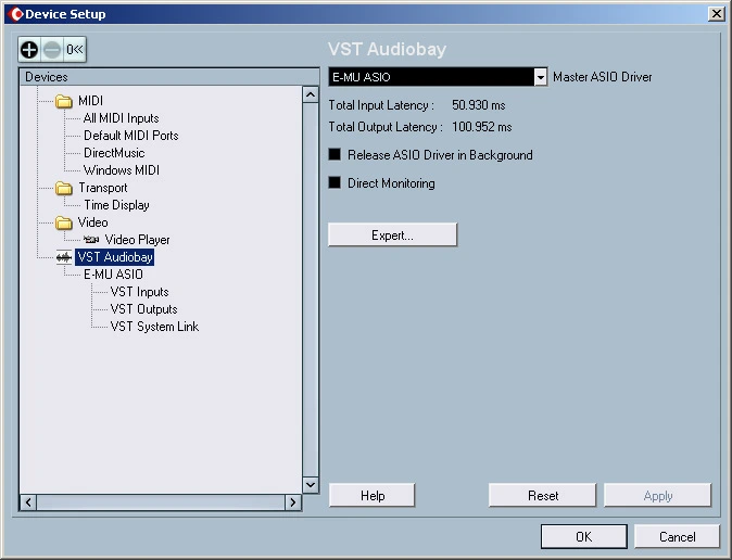

Go back to Cubase. Wavelab can record, but it's really meant as an editor and not a mulitrack DAW.

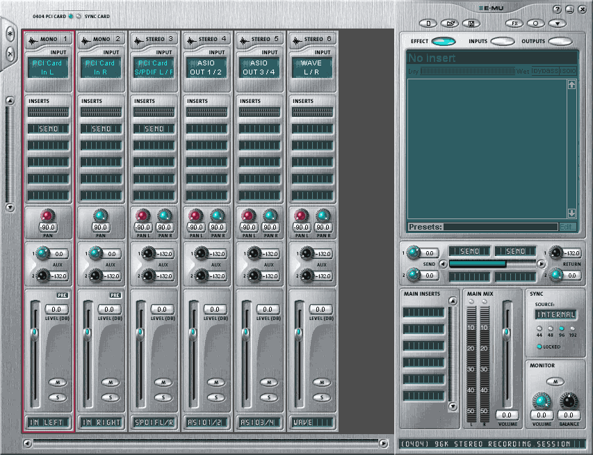

Post a screenshot of your Patchmix settings. Let's see what you have.
Then post a screenshot of Cubase> Devices> Device Setup>VST AudioBay
What version of Cubase do you have? I have SE3 which is kind of old. Graphics will look different, but content and function should be the same.

I'm startng to think there is something wrong with the way the mixer is set up.... The physical mixer.
I can only get sound into DSP Patchmix when the FX are on and the signal wetted. The wet part of the signal seems to double up and sounds like there is some kind of huge echo going on. When recording started in Wavelab, there was an almighty *CRACK* but the sound of the guitar was distant and full of echo.
I don't see what you're seeing. As you say, different version, different graphics. Am I close to what you're looking for?

Well, you need to get your mixer set up straightened out. Be sure to read teh manual. Your description sounds like you got it going through an effects loop or onboard processor. Turn all your Aux and Efx knobs down so you're not using the onboard effects unit.
For people who want to run a mixer into an interface, I always recommend using the Tape In and Tape Out. Be sure to read the manual for your mixer, it will tell you how to hook it up to a 2 channel tape machine. Just substitute the EMU card for a tape machine. Tape Out from the mixer to the PCI L and R inputs on the EMU. Then PCI L/R Outs from the EMU to the Tape In on the mixer. Other people might suggest using the main outs from the mixer. You can if you want.

Don't use the ASIO Multimedia driver. Find the ASIO selection for the EMU. The multimedia driver is a windows interface and adds an extra layer to the processing. Plus, it won't be able to automatically calculate latency and buffer settings.
When Cubase finds the right ASIO driver for your interface, it will run an automatic test, or it will ask you if it can run the test. Allow that to happen, it is calculating those important parameters.
Yes, you are close to what you should be seeing.

I've never used Patchmix before, but it just looks like a slightly more complicated way of performing what is usually a simple task. Once you have it set up in the way you want, you should just be able to leave it and forget that it even exists.
With most soundcards, the inputs that are visible to the DAW software relate directly to the physical inputs of the soundcard. So if you want to assign a track to record from input 7 on your soundcard/interface, the input in the software named something like 'analog input 7' is more than likely going to correspond to it.
All patchmix does is present you with the physical I/O of your soundcard and the virtual I/O of your software (through the ASIO drivers), and let you chose your own routing between them.
Soundcard input -> Patchmix -> Software input
And I'm guessing it works the other way around...
Software output -> Patchmix -> Soundcard Output
I assume it serves some kind of purpose by allowing you to do more creative routing, make monitor/headphone mixes from physical inputs and software outputs then route them to their own outputs (like a more complicated version of Motu Cuemix), etc, but I wouldn't worry about that.
So for most purposes, all you'll want to do is assign your physical input 1 to the ASIO input 1, input 2 to input 2, etc. So then when you assign a track in Cubase or Sonar to record from what is presented to them by the drivers as input one, the routing in Patchmix means that the software receives the signal from input 1 on the soundcard.
You may have to do the same thing for outputs... i.e. in Patchmix, assign ASIO outputs 1+2 to the soundcard outputs L+R/1+2. In the DAW, set the master bus to output to ASIO outputs 1+2, and hey presto, the signal is routed to your main soundcard outputs!
