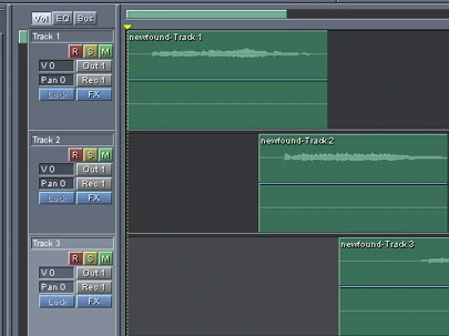

Here is a screenshot of what my situation looks like...
I try to pan that to the right and all the sound goes away completely. I've been doing what minofifa said and have been copying and pasting from the top to the bottom in edit mode.

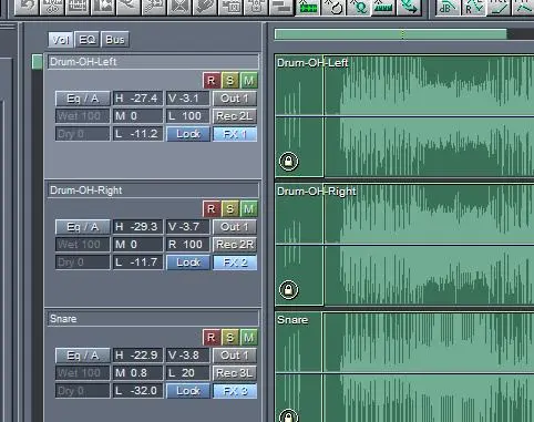

Cool- Thats what i thought- now we can solve this.
on a new track...
-Right click on the [rec] button and and pick the source as
- hit ok and arm the track (notice you didnt pick [stereo] as the source)
-then plug your axe onto the left input on the MAudio
then record. This wont fix the tracks you've already done. This will record future tracks in mono. Notice how all tracks in the image i posted dont have a top and bottom.
Doing this will probably cause you to only hear your guitar in one speaker while you are tracking. That is OK- once you playback it will play centered. You can then pan after youve recorded.
I hope this helps- we'll get ya straightened out.
