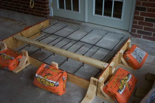

Doweling in the steel:
I actually ram-set the form to the patio. The bags are just there to square it up so it didn't move on me.

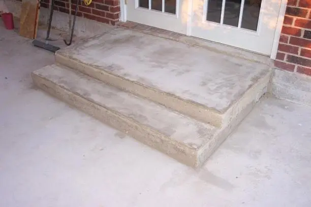

24 bags of ready mix and 24 hours later:
A landing and step!!
Wooo-Whooo! :rolleyes:
It took all weekend to do that. :(
Scratch one punch list item.
