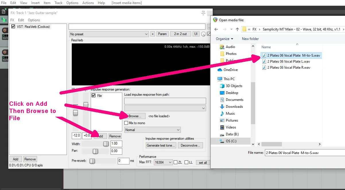

Just wondering how to use these impulse files...they're wav rather than dll files...is there software I need to use in conjunction and do I add them into reaper in the same way as I would a dll plug in?

Using the convolution reverb files is simple in ReaVerb. I like to use about -30 to -40 on the Wet slider to get a natural reverb level. You've got everything from a small chamber to a huge hall at your fingertips.
