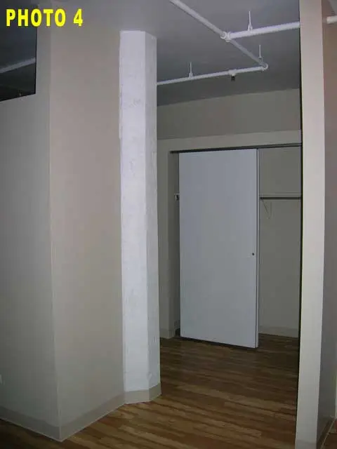

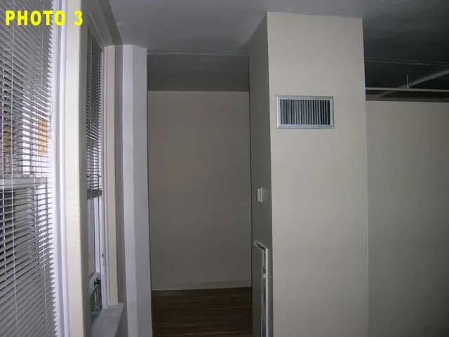

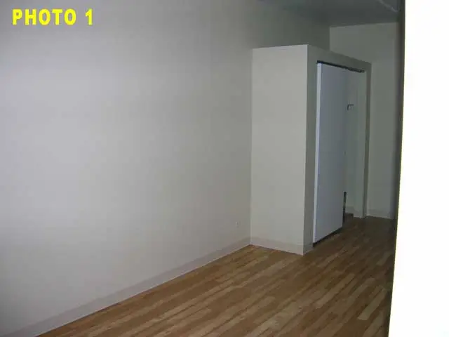

Ok I have a few pics here now :D
PHOTO 1:
This is the main problematic wall. Its super thin sheetrock. The floor , ceiling and other walls in the whole space are all concrete (except the partition wall in the middle.. see next)
PHOTO 2:
This is my new idea. This is a partition in the middle of the space which you can see the problematic wall in the backround. One side is the bedroom area and the other is my main space area.
(A) I was thinking of maybe putting a simple door here and build up the top of the ceiling so its closed.
(B) Here, to seal off this part, I was thinking maybe 2 pieces of glass/thick plastic. I'd like to keep it clear.
(C) Same as (A)
PHOTO 3:
This is where 1 door would go. You can see the problem wall in the backround
PHOTO 4:
This is where another door would go.
This is what I was thinking for the Door(s)
Ok I will be checking back here so let me know if there is more info you need. You rock I really appreciate all this help. You will need to go on my Xmas list !

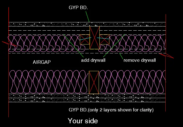

Virtual, there might be another way to "skin this cat" - without letting your landlord know you're doing it, you might check with your local Building dept to see if they have any MINIMUM sound isolation standards in place for rental units; if they do, there's a chance you could either use this to break your lease, or to force the owner to fix the "shoji panel" wall himself. Just a thought -
Either case would beat what's going on at the moment... Steve

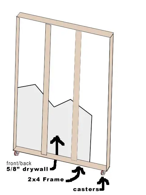

Ok after some time with the construction guy... I am at the point where soundproofing is not an option. To be within codes to do what i want.. would cost me way too much money and time. For now I have to pretend that there is no such thing as "soundproof" (i miss my old studio :( )
This guy came up with something that would help reduce the noise I would be generating. Its a type of movable wall/door structure on wheels. They would fit snug and there would be barely any opening on the bottom as the casters would be sunken into the frame.
We are going with a 2x4 frame (maybe 2x6).. Sheetrock (5/8") on both sides. 1 Thing though.. what would be the best insulation for this>? What is the best to pack it with? Im trying to do this from Home Depots' inventory so 701-703-705 would not be available.
Theres an image below I just sketched quickly for some idea of whats going on here. I know this wont help "much" but Im thinking it will at least allow me to work at a somewhat tolerable level.
Let me know what you think :D
p.s. Guys thanks for the additional options those were creative :cool:
But lets hope this idea works 1st heh
Hello virtuall, where theres a will, theres a way eh? :D Ok, tell me where you are placing these...ONE, OR TWO? Which area are we talking about? I assume the bedroom area as its the only one you can somewhat block off with these, in the doorways? The second thing, exactly what are we talking about in terms of generating sound, how loud are you talking and with what? If you are talking drums, I'm afraid you are fooling yourself. Vocals, acoustic guitar and maybe light electric guitars, in the bedroom with full height gobos in the doorways. Personally, I would put MDF on the frames as its heavier, and the edges don't half to be delt with like drywall. Stiffer too. But personally, I'd make it a perimeter frame only, no studs or partition supports. Shieth both faces with MDF panels, but line the interior with R-19 batt type insulation. If these are fitting inbetween the walls to enclose the bedroom space, maybe put some weatherstripping that overlaps. I'll draw the details later. Do you have a way to cut MDF, like a skill saw, and some hand tools for assembly? I'll tell you exactly what and how to do this if you want. Or you can give a drawing to the carpenter.
I can draw EXACTLY what you need IF you tell me where these are going, take pictures of the vertical areas that the end of the gobos will be touching, and measure EXACTLY the openings, both width and height. If this is for enclosing the bedroom, then we'll deal with those other openings too. Kind of like temporary baffles that you can take down. Anyway, as far as the existing partition wall between you and your neighbors, a gobo like this will do little, as sound will simply flank around the panels unless they TOTALLY fill the space in front of it, just like a real wall. The best thing to do, is use the bedroom space. Well, thats my NON EXPERT, NOT THERE TO SEE but this is what I'd do .02 :) Let me know and I'll try to help you more.
fitZ
"there would be barely any opening on the bottom as the casters would be sunken into the frame."
As Rick said, don't expect any measurable amount of low frequency isolation here; "barely" is about the same as "big hole" where bass is concerned... Steve

That is exactly what I would like to do. There are 2 openings I want to block off with these partition thing. There is also a gap above the already existion partition I want to block off. With these 3 areas built out..the bedroom is now its "own room" and my work area is its "own room".
My carpenter was going to build out the gap (mentioned above) with some type of thick clear type sheets and fill them in with insulation. What would you suggest for a clear product besides glass? It would be two rows of clear stuff with a 1 foot gap and insulation inside (I would like to add puck lights inside but never mind the tacky stuff now :D ).
As far as the tools, hes got them all I'd imagine. He says what I want is easy for him to do.
Knightfly mentioned the gap underneath with the coasters and letting sound out.. I dont know what to do about this because I would like them to be movable. They were going to have a large handle on them so I could slide them when needed.

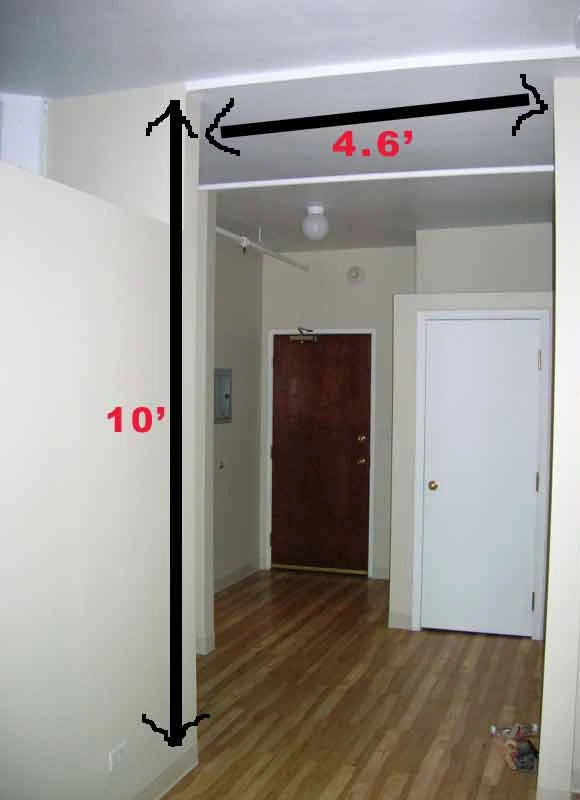

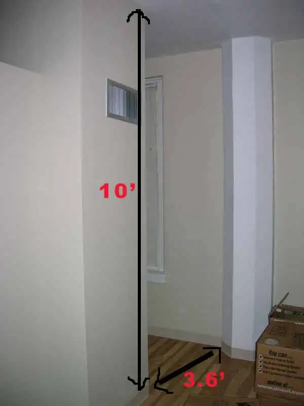

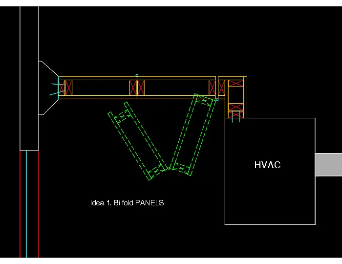

I attached 2 more pictures with dimensions. A rough sketch would be great. I would really appreciate it :D
Thanks Rick & knightfly
Quick Edit:
Just to mentin again incase I lost ya.. The reason to block off the bedroom from the main area is because at this point it seems the easiest way to prevent some sound traveling through the bedroom wall/neighbor wall.
Also this is a midi/digital setup (Genelec/Mackie and no subs).. no live drums, guitar, etc..

Well, heres ONE idea. Its all I had time for today.
fitZ :)
