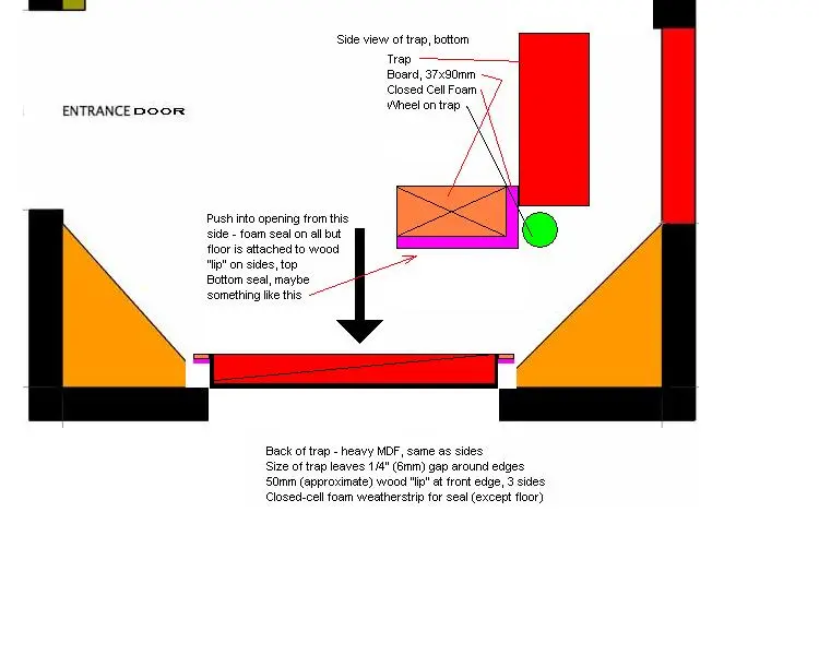

Possible seal idea for bottoms - originally done for another member at a different site, might work for this -
