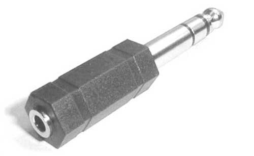

Yes, headphones will work. Make sure you get one of these. A 1/8" to 1/4" adapter.
yeah. i am going to buy one of those. and yes, to hear what i'm playing

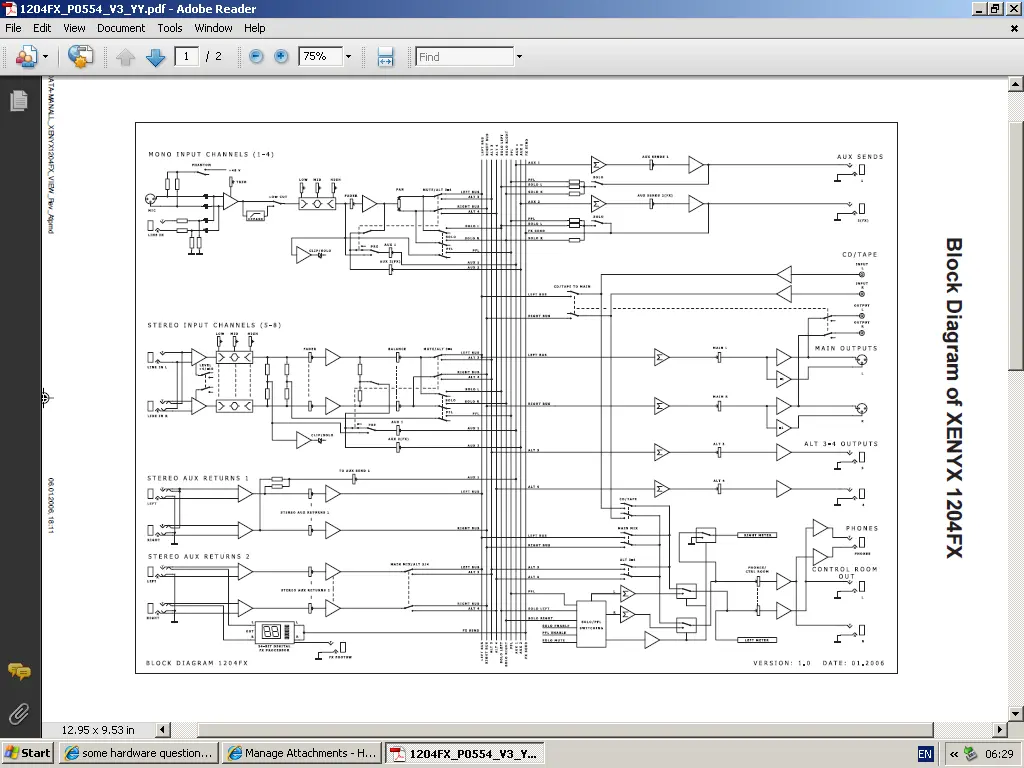

If the signal block diagram attached is of good enough resolution study that.
If not, put "Xenyx block diagram" into Google and get the .pdf (Behringer stupidly no longer include such data in their handbooks and the .pdf is too big for HR to handle!).
Now I know some people wail and say "Ooo! I can't handle technical diagrams!" Well I say "tough" because you HAF T!
If you drive you must be able to read a map (GPS is not infallible!). If you don't drive the Underground diagram? My point is, diagrams are the way we make sense of the world (that Berry diagram is no more an "accurate" representation of the actual circuitry than is the UG map!). You can follow a signal thru' from mic input to output.
Yes, the mixer can feed a hi fi amp. The good thing about audio is that you can plug almost anything into anything else and it won't smoke. May not work or might hum like stink so keep gains and volumes low and advance slowly.
