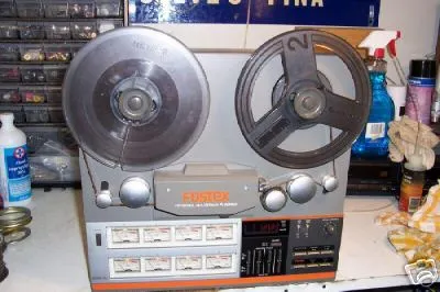

I'm afraid the A8 and the Model 80 are not very similar, at all!! :eek:
(A8)...

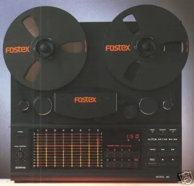

(Model 80)................. :eek:

Pray explain further. The transport design and basic control layout is the same, it just has some extra features and about three controls have moved around. The track selection might be different, I can't tell from the shots.
Internally they're totally different, and the colours aren't the same but that's hardly the point.

Yes, the Model 80 has Memory-Locate 1 & 2, RTZ, Loop & sophisticated sync capabilities that's less than intuitive to figure out without the manual. Track select (Rec-Funct) is different, but only slightly. I couldn't name the exact differences in Rec-Funct of the A8/Model 80 without looking directly at them,... but the "classic" A8 only records 4-simul from 4-inputs, while the A8LR & Model 80 have 8-in/8-out/8-simul capability.

Yeah, the A8 & Model 80's most basic setup & functions are the same. The A8 manual will get the Model 80 user going from scratch, in a basic sense. Thanx.
