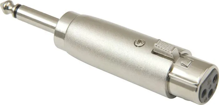

The SM57 should work fine with either a cable that adapts XLR (3-pin) to 1/4" (TS) unbalanced. There are simple cables that do this, and I've found they work just fine for the cable runs >20 feet.
Alternately, if you use a "standard" 3-conductor XLR cable, you'll need an XLR-to-1/4" (TS) transformer-adapter, which changes the plug style AND converts the mic to Hi-Z impedance, which is what the 1/4" inputs on the 424 requires.

I believe that has a transformer in it.

I got Audix coverter today. I plug my mic in and it works great.
