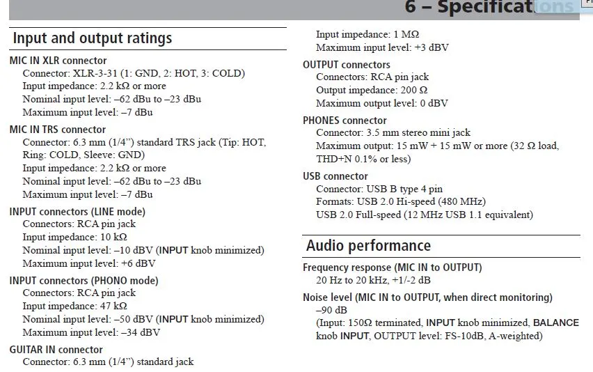

I'm currently using US-100 with a dynamic mic and planning to get sm57 or 58.
But I'm not sure if my interface has enough gain for sm57/58.
Here's a snapshot of the US-100 manual. I read that shure dynamic mic requires 60dB.
I'm not sure which value to look for in the manual? Is it the Nominal Input Level (-62dBu to -23dBu)?
