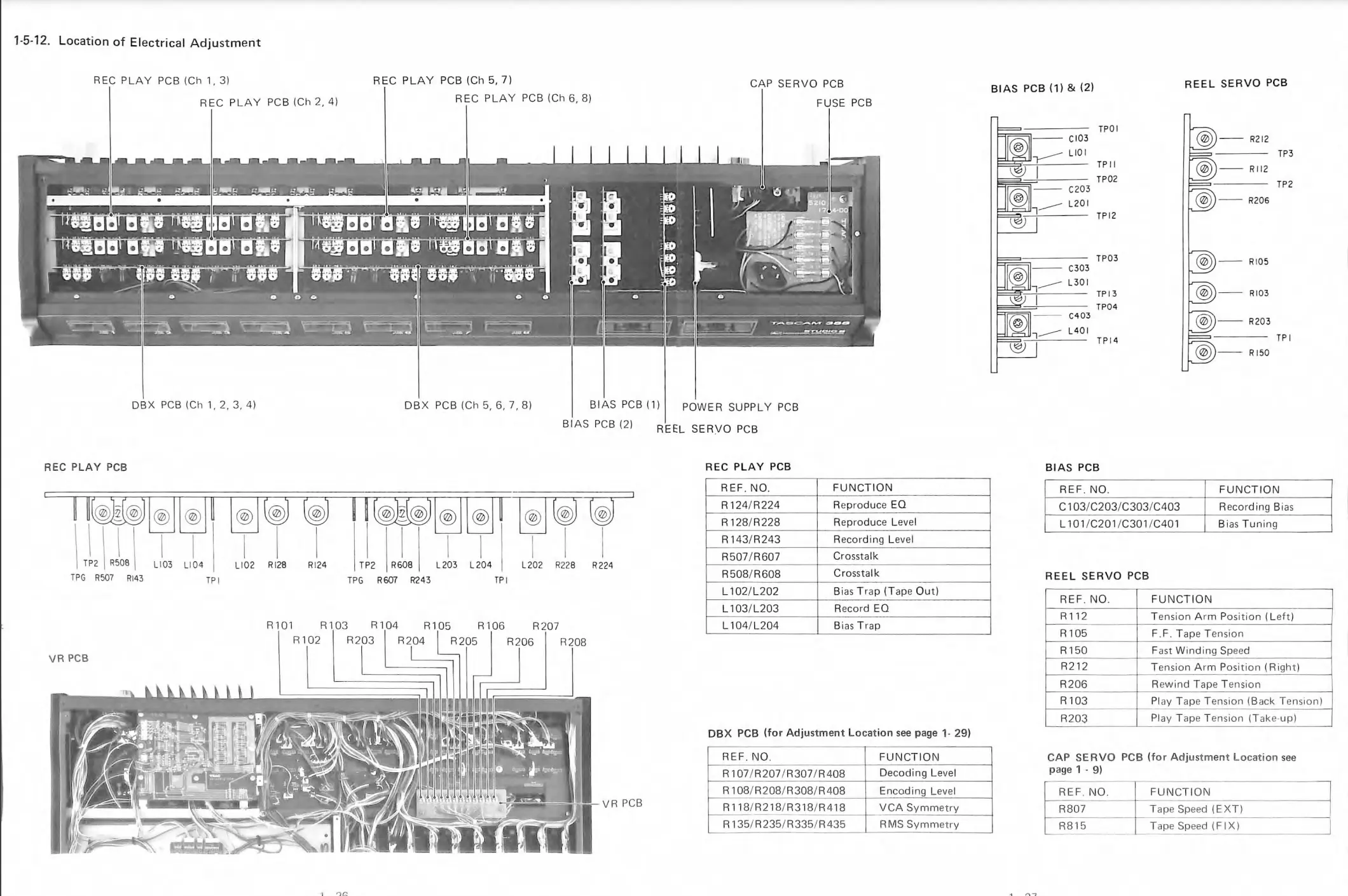

I'm wondering, I heard that when take the top panel off the tascam (how I adjusted the tension arms to fix the time monitoring screen ages ago), you can adjust two "knobs" with a small screwdriver to boost the input gain for individual tracks. I'm curious if I can boost the baseline gain level on tracks 1+3 to make them more audible, so I don't have to boost the trim when recording quieter instruments. Also hoping I can avoid taking the whole damn thing apart again (as I did when Sweetbeats walked me through lubing that bad boi up a few months back).
SO-- three baseline questions!
A) Does anyone know which knobs (pictures attached) correspond with tracks 1 + 3 gain levels?
B) Is it a bad idea to adjust these gain levels? I know things will sound a little crunchier, but as long as that's not significantly boosting the bass I think that's fine with the style of music I'm recording.
C) Is this whole plan garbanzo beans and I should do something else first before adjusting the baseline gain levels on these two quieter tracks?
THANK YOU FOR ANY HELP!!

I’m not really sure, but it sounds from your description there’s not a problem with your record level, it’s your monitoring level.
What I’m interpreting from your post is you can’t hear your source really well when monitoring before or during recording, so you are boosting the mic TRIM, but when you play back the track the level was too hot and the tape is saturated.
That’s not what the TRIM control is for. Set your TRIM level by performing the loudest part of your performance, turning up the TRIM knob until the red O/L LED just starts to flicker with the peaks, then back it off a shade. The TRIM is set. Leave it alone unless you are changing the source or you’re on to the next performance and it’s a different peak level in the performance.
Typically you then raise the input fader to the shaded area, assign the channel to whatever buss or busses the signal needs to go to, and adjust the buss fader(s) so the peak LED in the PGM meter is flickering. Then depending on the material and how the machine is setup you might back the channel fader off a bit or push it. Now you’ve set your level for recording and then you set your monitor level in the MONITOR mixer. So are you saying you do all that but you run out of knob for monitor mixer channels 1 & 3 to be able to hear your source(s) in the monitor buss?
If I’m understanding correctly and your monitor level is too quiet so you are cranking the TRIM, but your signal to tape is then too hot, adjusting the record level trimmers is only going to make things worse to tape. And I wouldn’t recommend doing that anyway. Those trimmers are for calibrating the machine…lining the levels and response up across all 8 tracks so they are the same. They are not for adjusting levels during the recording or mixing process. Bad idea. That’s what your input and PGM buss faders are for. If you want to know if your machine is out of whack calibration-wise, then you need to start at the top, cal the meters, cal the input level, cal the playback level (which you can only do with an appropriate reference calibration tape), set record bias, then record level for each track using an appropriate audio bandwidth rated level meter.
If you DO go in there against my advice and tweaker with things please use a non-conductive screwdriver.
The trimmers that adjust the record level for tracks 1 & 3 are R143 and R243 on the track 1/3 amplifier PCB. It’s all there in the pic from the manual you posted. The pic tells you which card goes to which tracks, then there’s the drawing below the overhead pic of the cardbay that labels all the trimmers and test points, then the chart to the right tells you, by function, which trimmer corresponds to which function.
SO…
A. See above.
B. Yes. Bad idea.
C. Yes on the beans. See above. Walk through the level setting process using the controls of the mixer as intended. Verify if I’m understanding your problem correctly.

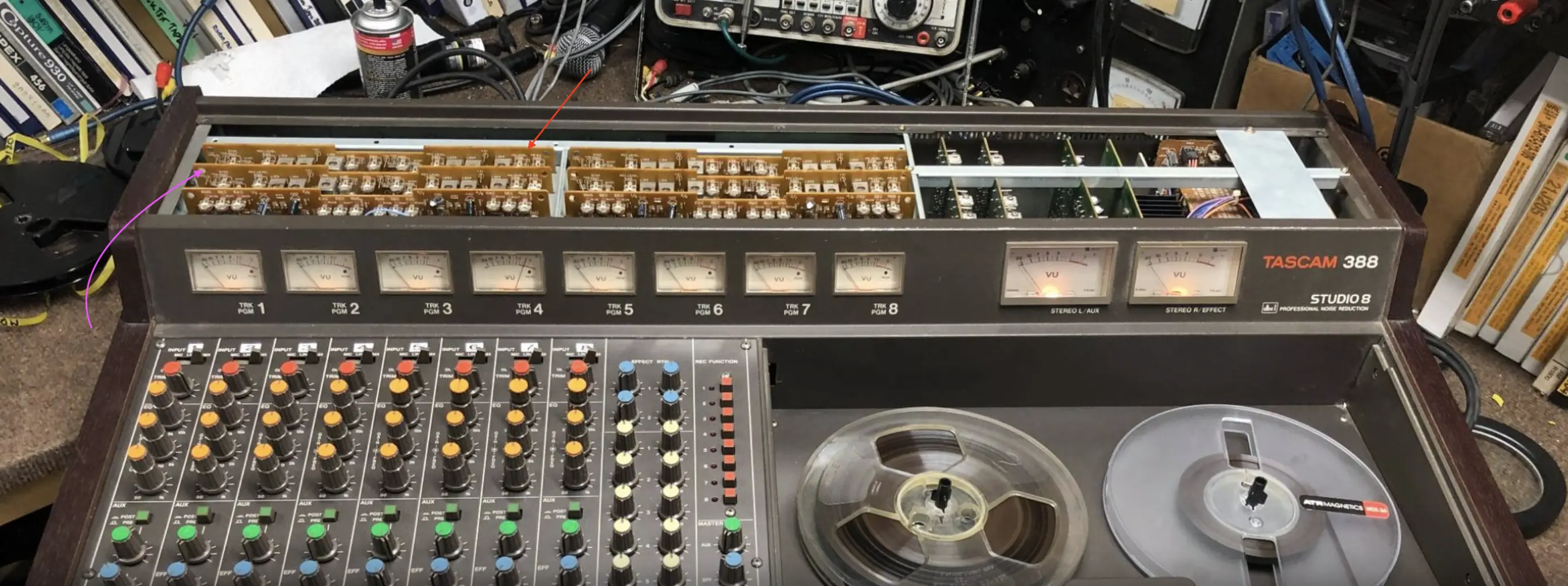

Maybe a dumb question but everywhere I look I can't see any pictures of what the card actually is and where to grab it from? It's visible from the top of the machine, correct?
I marked up the previous picture here. Is the red arrow pointing to what I'm removing, and I'll swap it with the card below it, with the Pink arrow?
Is that correct?
And nothing to unscrew or or remove besides the top panel, correct? I just give her the ol delicate tug per the advice from the other thread you linked to? That does seem more detailed on pulling, which I appreciate:
+1 to everything j.harv said. He's spot on. Look in the corners of the cards. If there are little holes there you can loop some wire through them to give you something more to hold on to as you rock the card from side to side. You have to be pretty firm in your application of pressure but gentle (i.e. just do everything nice and slowly). Don't be surprised if it takes some strength the first time you pull a card out if that's what it takes. For many of these machines the cards may very well have never been pulled and, well, after nearly 3 decades they think they can just stay in there. There are card guides on the sides of the card, so you can't pop it out crooked...the guides will prevent that. Just grasp the corners with your thumb and forefingers and leverage the pinky-side of your hands against the surfaces to the sides of the card so you have some controlled leverage. Just work back and forth applying that slow but firm pressure...it'll come out.
If you have the manual there is a page in the service manual section that details which card is what.
Make sure the machine is powered off and unplugged before removing any cards, and make sure all the cards are in place before reconnecting to the mains power and switching the unit on.
And so I can understand the big picture, basically we're removing the cards and swapping them to see if the issue is with the cards or the channels themselves.
Ideally, the issue is with the card and that will be easier to fix with testing and soldering? And if the issue with the channel not from the card, it's a whole other set of issues I'd need to test?
Yes, correct. Look at the picture from the manual you posted a couple days ago earlier in this thread. All the cards are labeled in that picture.
Is that correct?
Yes that’s it.
Also correct. And the action is really kind of a rocking back and forth…pinch the corners of the card between you thumb and pointer finger on each hand, put your other fingers or sides of your hands on the chassis wherever you can and use those fingers to lever up…this gives you control so when it pops free it doesn’t come ripping out of the cardbay causing potential damage; lever a little on the left, then the right, then the left, rocking back and forth until it unplugs. And if you don’t have enough strength just grabbing with the thumb and finger, you’ll see there are holes in the corner of each card. You can twist the ends of some wire in each hole to make a makeshift bale or handle of sorts so you have something more to grasp, or even just put a zip tie through each hole…even that will give you something more to hang on to.
Right. If your issue is on the track 1 & 3 amp card, when you swap that with the track 2 & 4 amp card, your poor performing tracks will now be tracks 2 & 4…the cards are all identical. It’s the slot they are plugged into that determine what tape tracks the feed and source. It’s a troubleshooting step that helps us start to hone in on where the source of the problem is.
Well I’m not really rooting for the problem to be in a particular place or with a particular PCB assembly…the goal is just to figure out the source of the problem. Let’s not get ahead of ourselves. We’re just going to methodically attempt to hunt down the source of the problem.
