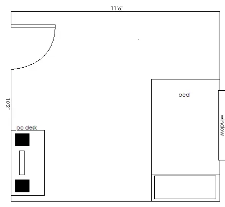

I would love to, and I was going to but I dont know how to post pics on here.
Would I have to draw one then host it onling and attach it here? or is there a way to post it from my comp?
You can draw one in paint (something like the one below), good idea to save as .png, then scroll down to the Attach Files section when composing a post.
There you go. the drawing isn't too accurate but the measurements are nearly on the dot (its a very old house so every wall varies a little)
in the picture it appears I could rearange my bed but it is in the most practical place to put it without covering my window (being single glazed it gets very cold) or the radiator. and it wont fit where the wall dips in near my fire place. for a better feeling of the size.

Right off the bat I can tell you that your desk and monitors are in probably the worst place they can be. Ideally, you'd want them where your bed is, about 1/3 of the way into the room away from the wall.

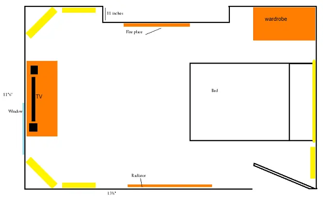

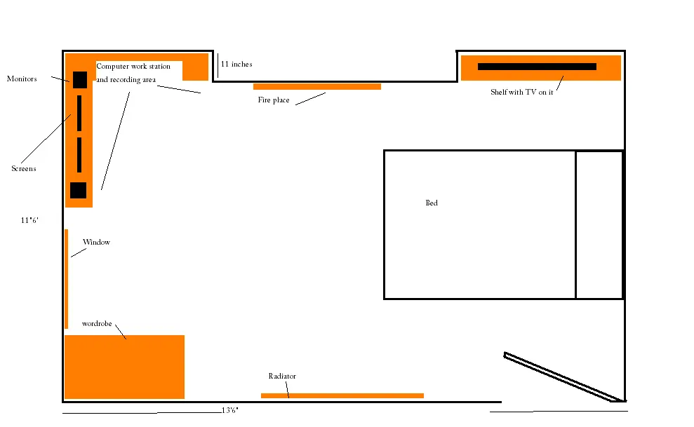

How about moving the wardrobe over to where your tv is and using you tv as your pc monitor? You could also use your studio monitors for better sound with your tv. Add bass traps in all the corners you can, including ceiling corners, treat first reflection points and get a big cushiony headboard for your bed. This is quite similar to my bedroom, only I have a bay window. I'd set up like this...

That aint a half bad Idea! Id love to do some mixing on a night while laid in bed!!
