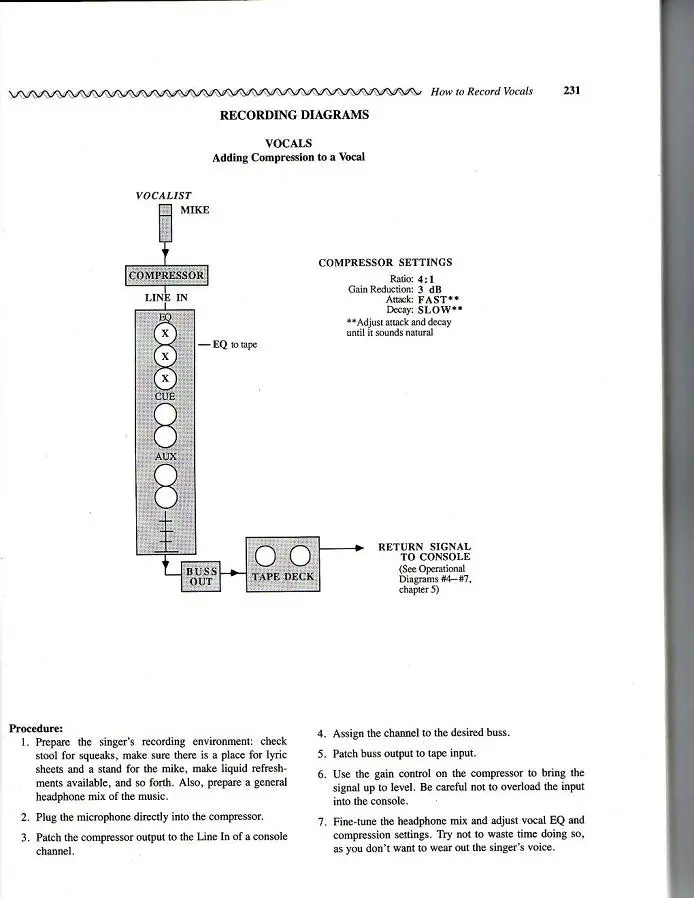

Actually, I was wrong, he specifically says in his book to plug the output of the compressor into the LINE IN of the console channel. (See attached page from book.)
So this would only work if, as boudlersoundguy was saying, it's a compressor/pre in one, correct? The weird thing is that the book is filled with talk about the limitations of the home recordist and how to get around those. It would be weird for him to overlook something as big as assuming that all (or most) home recordists would have such high-end compressors.

I was able to get halfway decent signal through my compressor using a battery powered condensor mic (AKG C1000s). It seemed to function properly but I don't see how this would be better, or even remotely as good, as the 'normal' way.
He's making an assumption about the mic/comp signal relationship.
Can you get enough signal by cranking the input gain on the comp....probably.
Do all comps have an input gain control and not just an output make-up....no.
Also...why run through an entire console and that longer/more complex signal path, just to use some EQ, unless you have no outboard EQ to use?
I never engineered any big bands and I have no book... :) ...but I would use the mic-pre route...and then if you need an EQ or comp in the chain...put it after the pre.
Also...he's got a comp going into an EQ...another bassakwards thing IMO.
That is just a poorly written page. Condenser mic needs phantom power and a preamp. He is probably talking about a preamp with compressor built in. Pretty confusing to a newbie. He should stick to studio work and forget about writing books.

Yeah, he really dropped the ball here. There is a lot of good info in the book, but there are times where, for whatever reason, he really misses the mark.
Yeah, this author left something out in his description, that's all.
I know of one new microphone that's capable of putting out line-level output given an ample signal (The Ronin Pegasus) but that's a very uncommon design.
In general the preamplifier stage built into microphones barely amplifies the signal at all. It's really there for impedance conversion. 99,999 times out of 100,000 you'll want to hit a preamp before a compressor.
