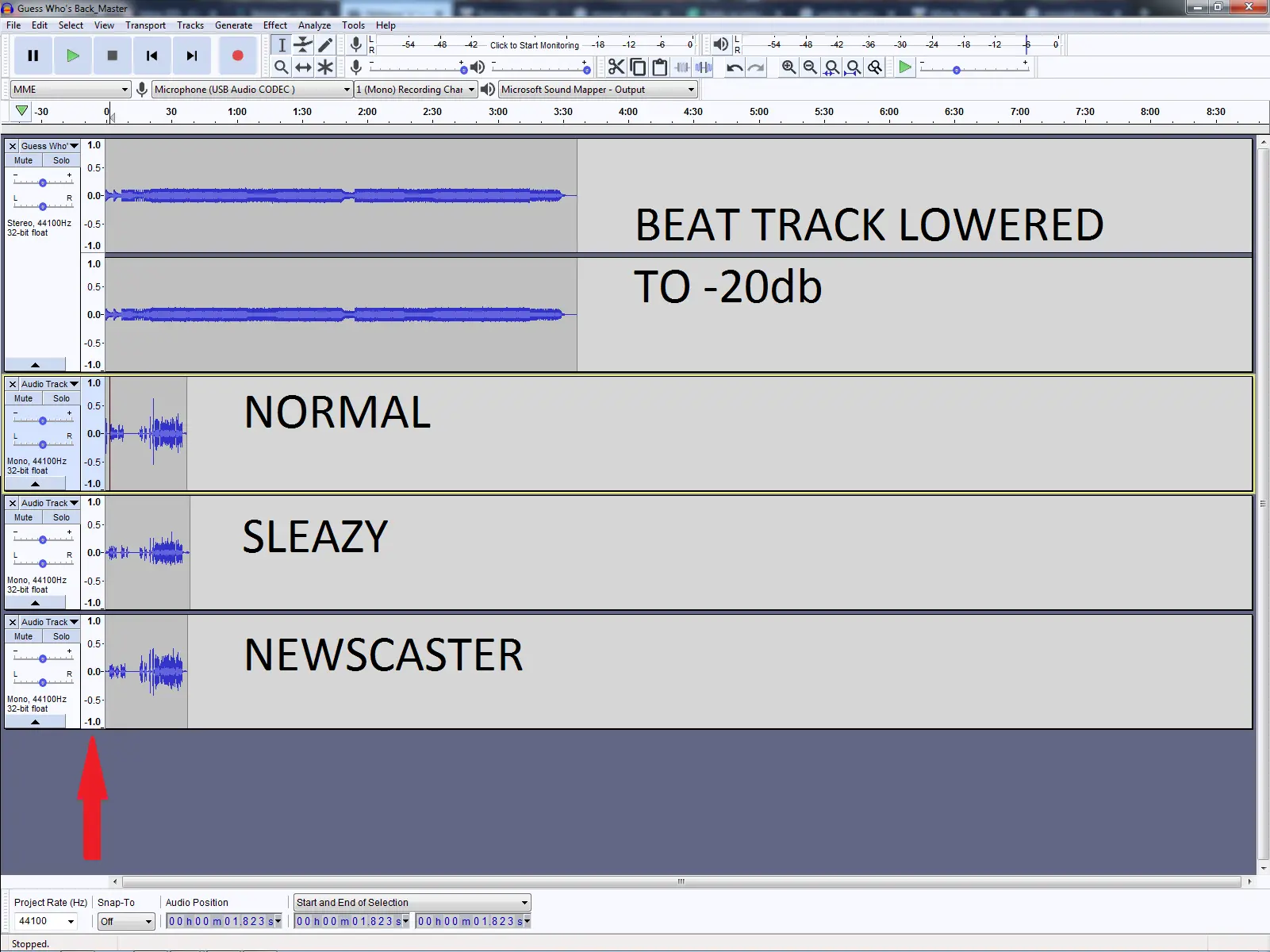

I reached step 8 using Audacity. I attached an image of my work that includes a red arrow at the bottom left. The arrow is pointing at the -1.0 to 1.0 range window. I do not know what this window is called, or why it only ranges from -1 to 1. Seems to me that it should have a broader range like the top right playback level has so the user can easily see if wave peaks are not above -6db, without the need to play the track and watch the playback/master level. The forum rules stated that this is not the area to ask if someones voice is good or not, so I fear having this thread deleted if I upload the short .mp3 clips of my voice. Would that be ok to do? Thank you so much for the step by step layout. Yourself and everyone else assisting me will get acknowledgement when we become well known.

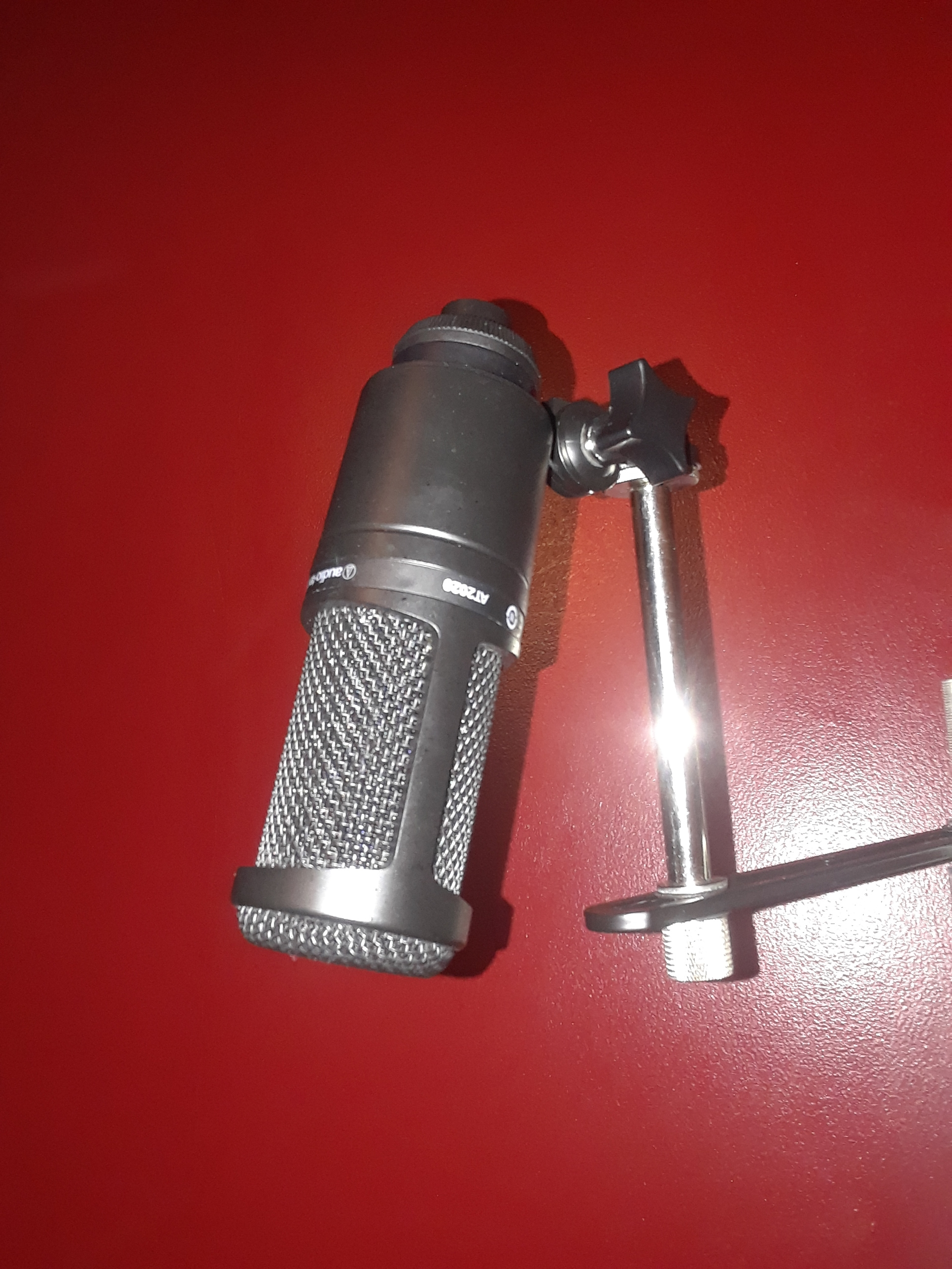

I attached an image of my mike in the configuration that I believe you explained, did I get it correctmic.webp?
I reached step 8 using Audacity. I attached an image of my work that includes a red arrow at the bottom left. The arrow is pointing at the -1.0 to 1.0 range window. I do not know what this window is called, or why it only ranges from -1 to 1. Seems to me that it should have a broader range like the top right playback level has so the user can easily see if wave peaks are not above -6db, without the need to play the track and watch the playback/master level. .....

RE: position. No that's 90 degrees wrong! Your mic is a side fire mic, it picks up sideways on the face with the audio technica label. Move the mic so it is horizontal, try with the opposite end to the xlr nearly on your forehead with the brand name on the bottom.
