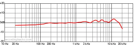

I am currently using a Rode NT1000 cardioid condenser mic for vocals. This is what I got when I googled it:
"NT1000 - Studio condenser, large diaphragm, cardioid A condenser microphone, it employs a 1-inch diaphragm with a fixed cardioid polar response, yielding 'ultra-low noise, wide dynamic range and high SPL capability'."

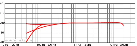

Shure SM81 for instrument, also line in pickup on guitar/

This will tend to accentuate the lows, but eq can compensate. If the mic has a high pass filter, engage it.

- while the NT1000 has significant bumps at 2Khz and above - you might try reversing the Microphones - NT1000 on Guitar and the SM81 on vocals.
