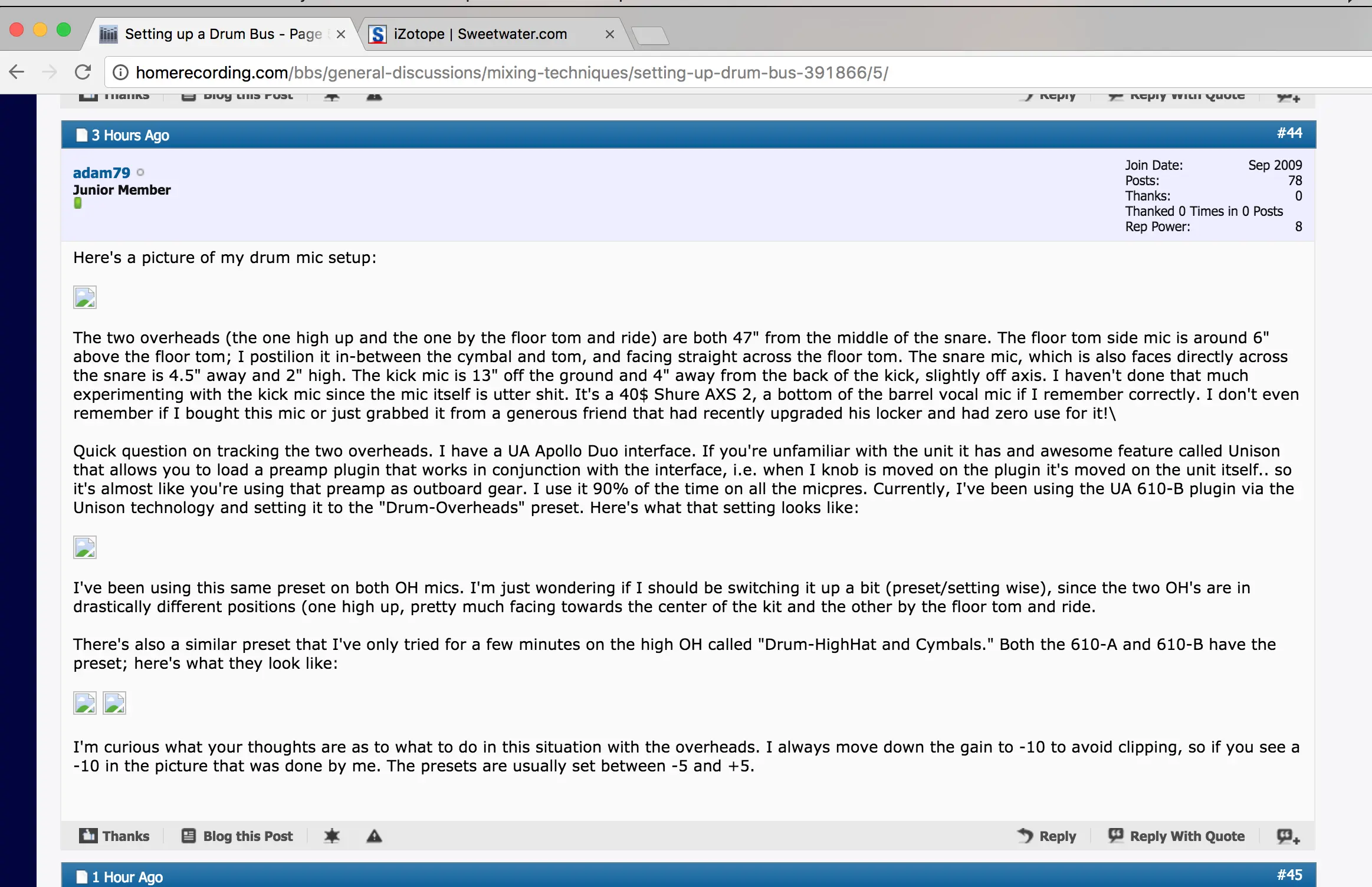

Here's a picture of my drum mic setup:
The two overheads (the one high up and the one by the floor tom and ride) are both 47" from the middle of the snare. The floor tom side mic is around 6" above the floor tom; I postilion it in-between the cymbal and tom, and facing straight across the floor tom. The snare mic, which is also faces directly across the snare is 4.5" away and 2" high. The kick mic is 13" off the ground and 4" away from the back of the kick, slightly off axis. I haven't done that much experimenting with the kick mic since the mic itself is utter shit. It's a 40$ Shure AXS 2, a bottom of the barrel vocal mic if I remember correctly. I don't even remember if I bought this mic or just grabbed it from a generous friend that had recently upgraded his locker and had zero use for it!\
Quick question on tracking the two overheads. I have a UA Apollo Duo interface. If you're unfamiliar with the unit it has and awesome feature called Unison that allows you to load a preamp plugin that works in conjunction with the interface, i.e. when I knob is moved on the plugin it's moved on the unit itself.. so it's almost like you're using that preamp as outboard gear. I use it 90% of the time on all the micpres. Currently, I've been using the UA 610-B plugin via the Unison technology and setting it to the "Drum-Overheads" preset. Here's what that setting looks like:
I've been using this same preset on both OH mics. I'm just wondering if I should be switching it up a bit (preset/setting wise), since the two OH's are in drastically different positions (one high up, pretty much facing towards the center of the kit and the other by the floor tom and ride.
There's also a similar preset that I've only tried for a few minutes on the high OH called "Drum-HighHat and Cymbals." Both the 610-A and 610-B have the preset; here's what they look like:
I'm curious what your thoughts are as to what to do in this situation with the overheads. I always move down the gain to -10 to avoid clipping, so if you see a -10 in the picture that was done by me. The presets are usually set between -5 and +5.

I can't see your pictures. This is whats showing up on my browser. I tried Firefox too...they're not showing up.
