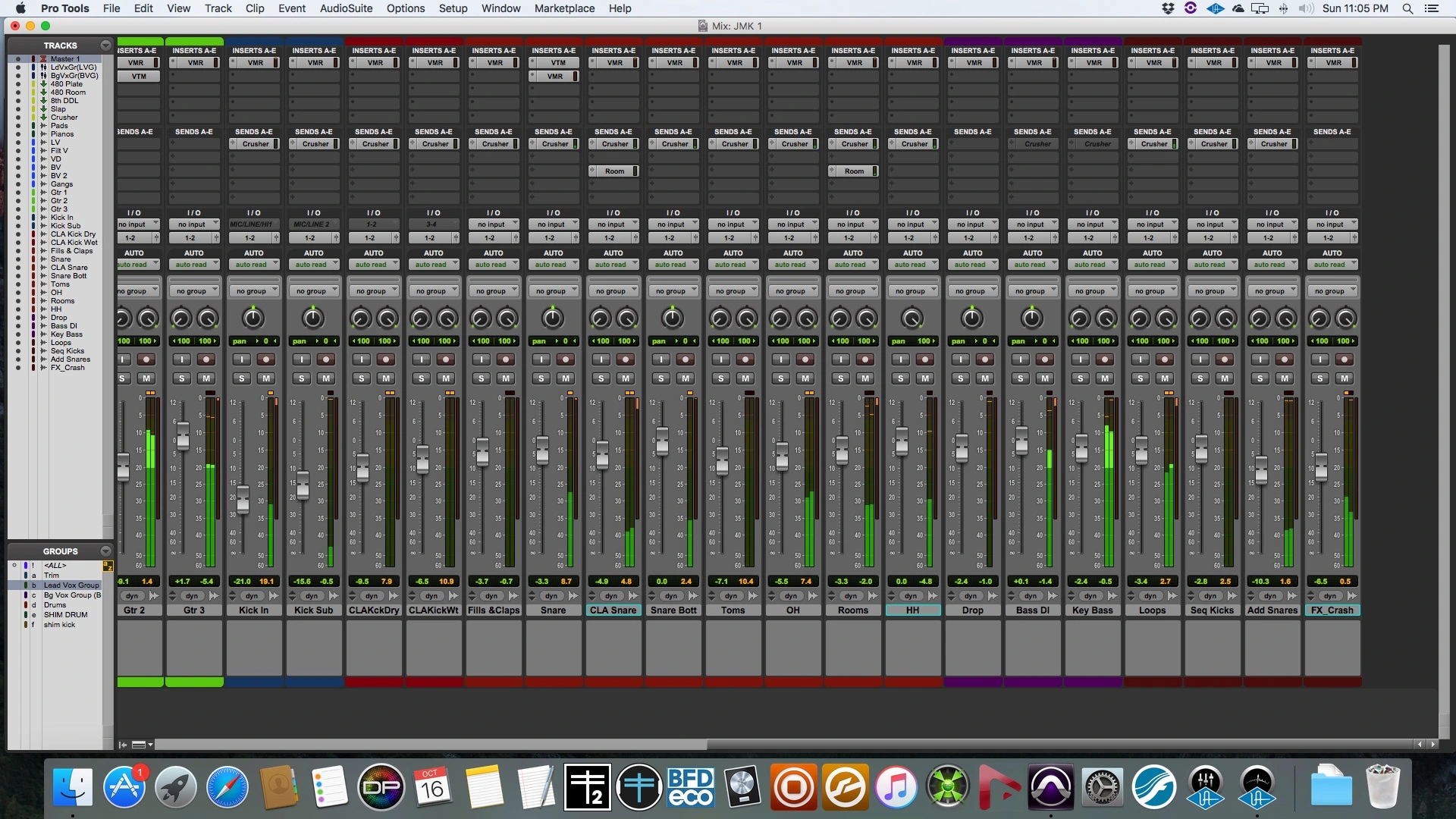

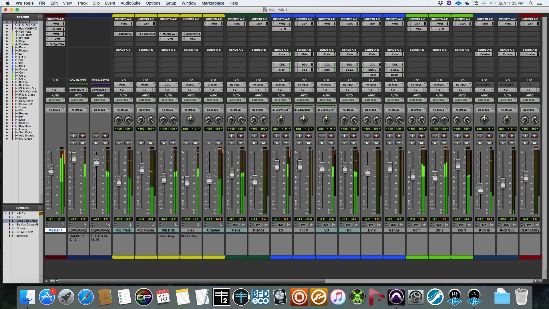

This is a very strait forward (easy to follow) example how this would be done in a pro environment. If you have any questions about the signal flow or routing, feel free to ask.
I'm going to post a video of this in a sec, if I can figure out how to do it.
The mp3 of the actual mix (JMK 1) is attached below the pictures.

Just for fun...here's a quick youtube video snapshot of the mix actually rolling :D
That sounded good, and btw, nice console.
:D
Thanks. That's actually just half of the console. I can't set the whole thing up because the rooms in the house aren't wide enough. I'm still waiting on the new studio to get built.
