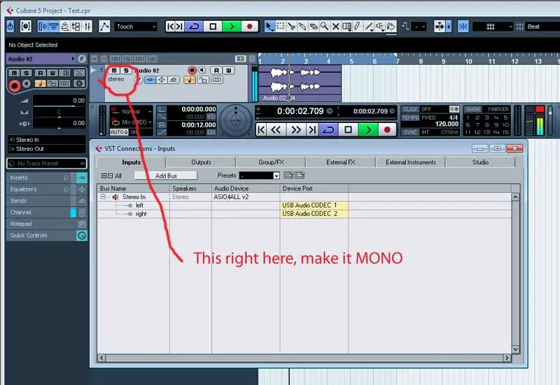

So, you want to get your mic'd recording (I'm assuming vocals) to come out both speakers when you play it back on the saffire. Record it as a mono track and it will come out both speakers.

I don't know why the Tascam split (splitted is not a word) your mono signal into 2 channels. I'm guessing it's the ASIO4All driver. To me, that's a very poor excuse as a way of doing business. Tascam should write drivers for their equipment. But nonetheless, your mono signal across 2 channels is still mono.
You can't get your mic to feed two channels on your Saffire. Just do as everyone has been telling you and record your mic to a mono track. If you want it stereo, then record you mic a second time to another mono track. Give teh same EXACT performance. The small differences and minute nuances will give a stereo effect. It's 2 different signals so that would make it stereo. But two different tracks.

It's a mono mic like most mics out there. For there to be stereo there has to be a difference between left and right, and with one mono mic there is no difference regardless of how many duplicate copies of the mono signal you record. Even your own screen shot shows no difference between left and right channels of the track, therefore it's a mono recording on a stereo track.
