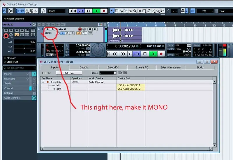

Now that's the problem. My Tascam US-100 has 1 xlr mic input and when i plug my mic into it, i get a stereo recording. Refer to the tascam US-100 image. You can see that it is set as USB Audio Codec 1 & 2. And when i tapped my mic you can see the left and right input volume go up.
It's still not stereo. One mic = MONO. It's just coming out both speakers, but still mono. I failed to write that in my last serious post.
In your DAW, create one MONO track and assign it to whatever channel your mic is plugged into. It will come out both speakers, but it is still mono. Both speakers are producing the very same signal. That is mono regardless of how many speakers it comes out.
SEEEE!!! YOU GUYS DO NOT GET IT! LOOK AT THIS IMAGE! THIS IS WITH MY TASCAM US-100!
That is clearly a stereo recording! I DID IT RIGHT NOW!

You don't get it... THAT's NOT STEREO!!!!!! IT'S MONO!!!! just coming out 2 channels - USB Audio Codec 1 and USB Audio Codec 2. But still MONO.
Maybe the reason it's assigned to both channels is because you're using ASIO4All, which is a band-aid at best. It's meant to allow built-in soundcards to be used as an ASIO driver to DAW's. It's basically a hacker's tool.
Just do what we've been telling you all along and you'll be fine. When you create a track in Cubase, it asks you if you want it to be Stereo or Mono, if you have one mic, then you select Mono. It can't be easier.
