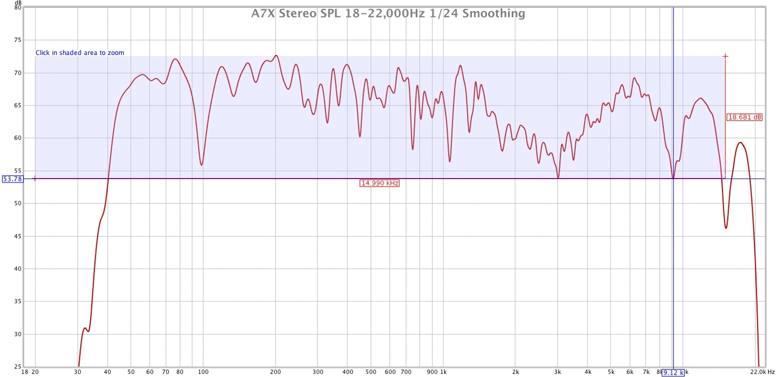

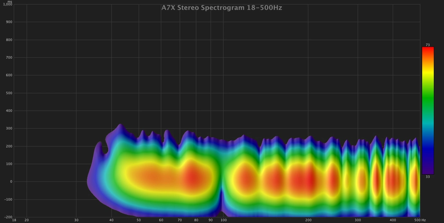

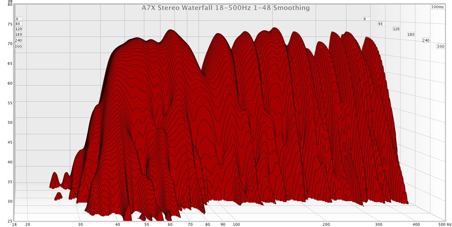

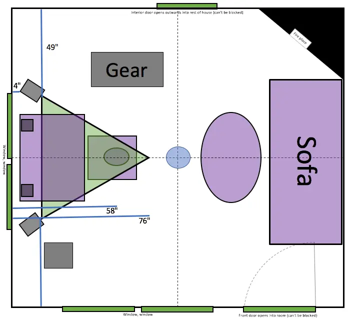

Update
UPDATE:
Completed:
• Repositioned broadband absorbers on front wall to be tight against wall
• Placed studio monitors per Soundman2020’s suggestion (i.e. 4” from back wall, 49” from sidewalls, acoustic axis placed at 50” height)
• Removed diffusion array from back wall
• Removed headboard from broadband absorber above former diffusion array position
• Replaced 3” 8 lb./ft^3 Roxul with 4” OC703 in rear wall broadband absorber and moved it down behind the sweetspot, just above sofa flush against wall
• Since I can’t put superchunk bass traps in left rear corner, I reused the two old bass traps in that location, removed diffusion grates and 6” of 8 lb/ft^3 and replaced with 8” of OC703. Still need to remove limp mass membranes on those two. Also plan to fit some OC703 scraps behind traps
• Took quick set of REW measurements (w/o sub)

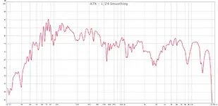

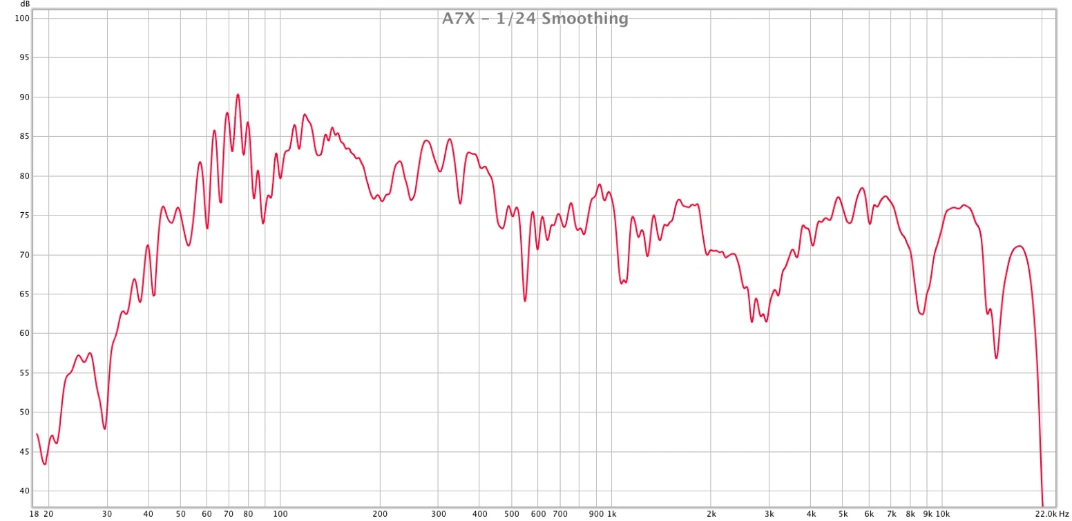

So would this be the "before" and "after" measurements?
Looking at all the different measurements in your first post...not sure if this would be the best one to compare to?
I'm also not sure if you're using the same levels in your measurements...seeing the difference between these two.
I would shoot for 80-82 dB SPL when you first calibrate your monitors.
Also...are you measuring one monitor at a time...Left and Right...or both at the same time?
It should be one monitor side at a time...and then you can average the two measurements.

So what do you think of your new setup and measurements?
Just looking at the graph....it almost looks like you now have more defined/deeper nulls/peaks, but I'm not sure if these two measurements were don't exactly the same way to make them a fair comparison.
