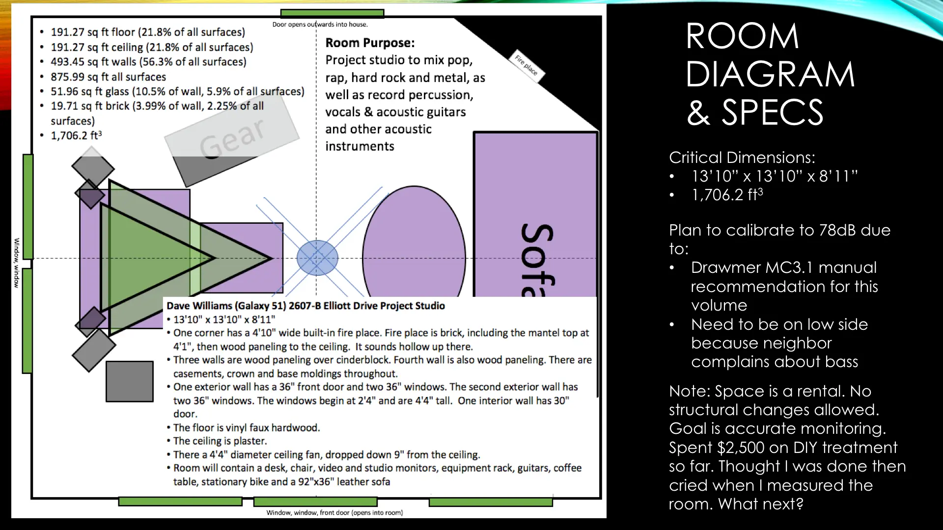

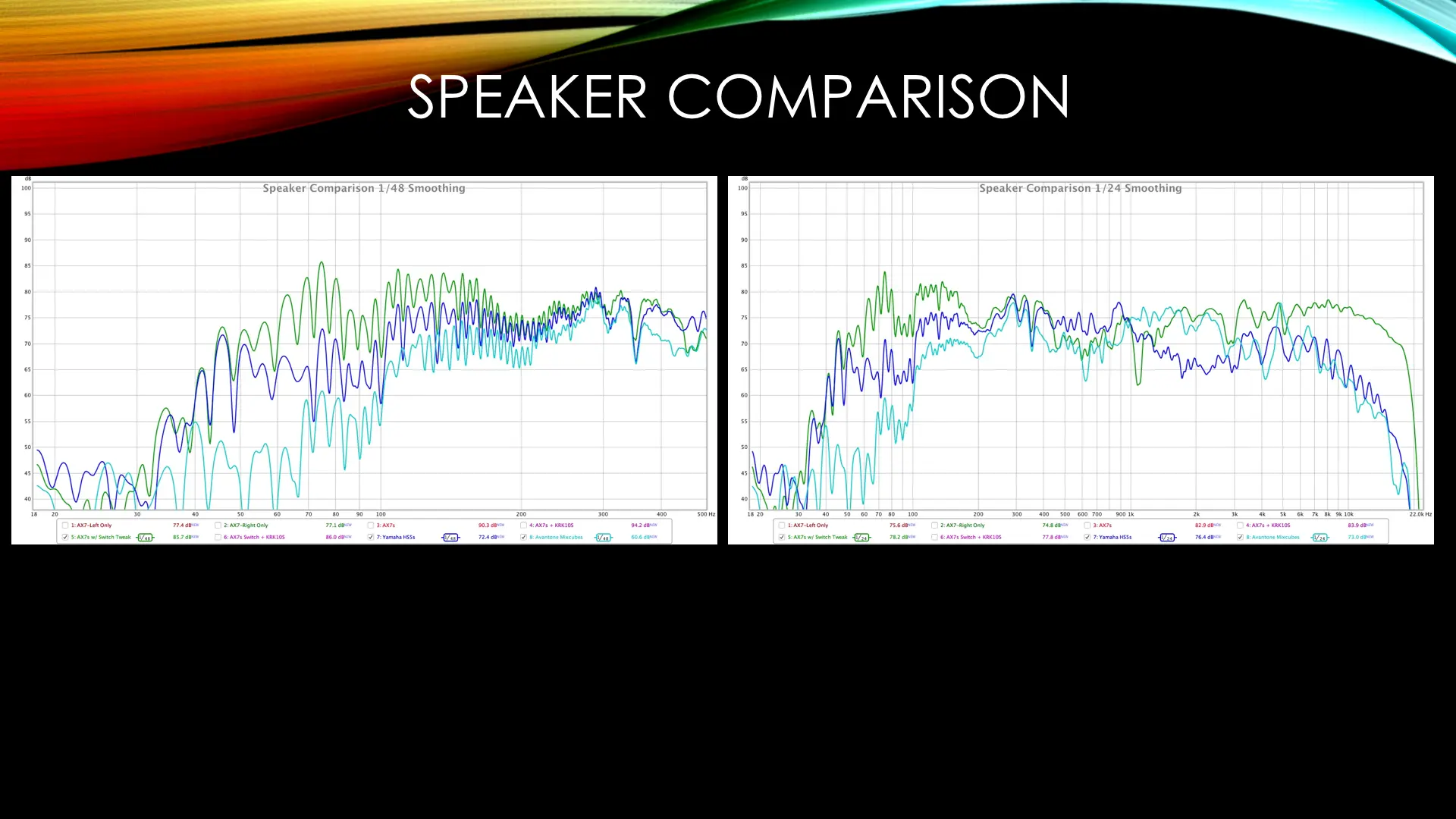

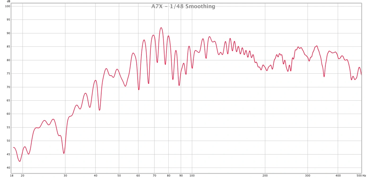

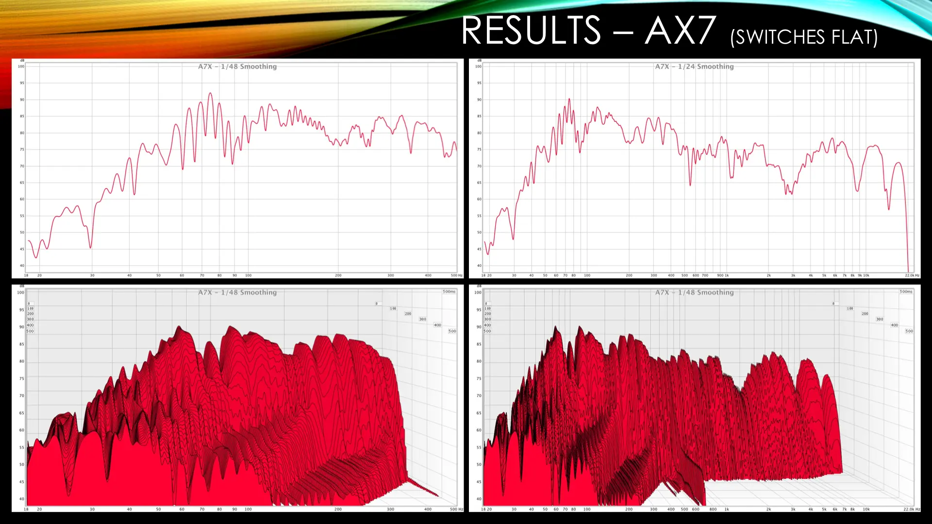

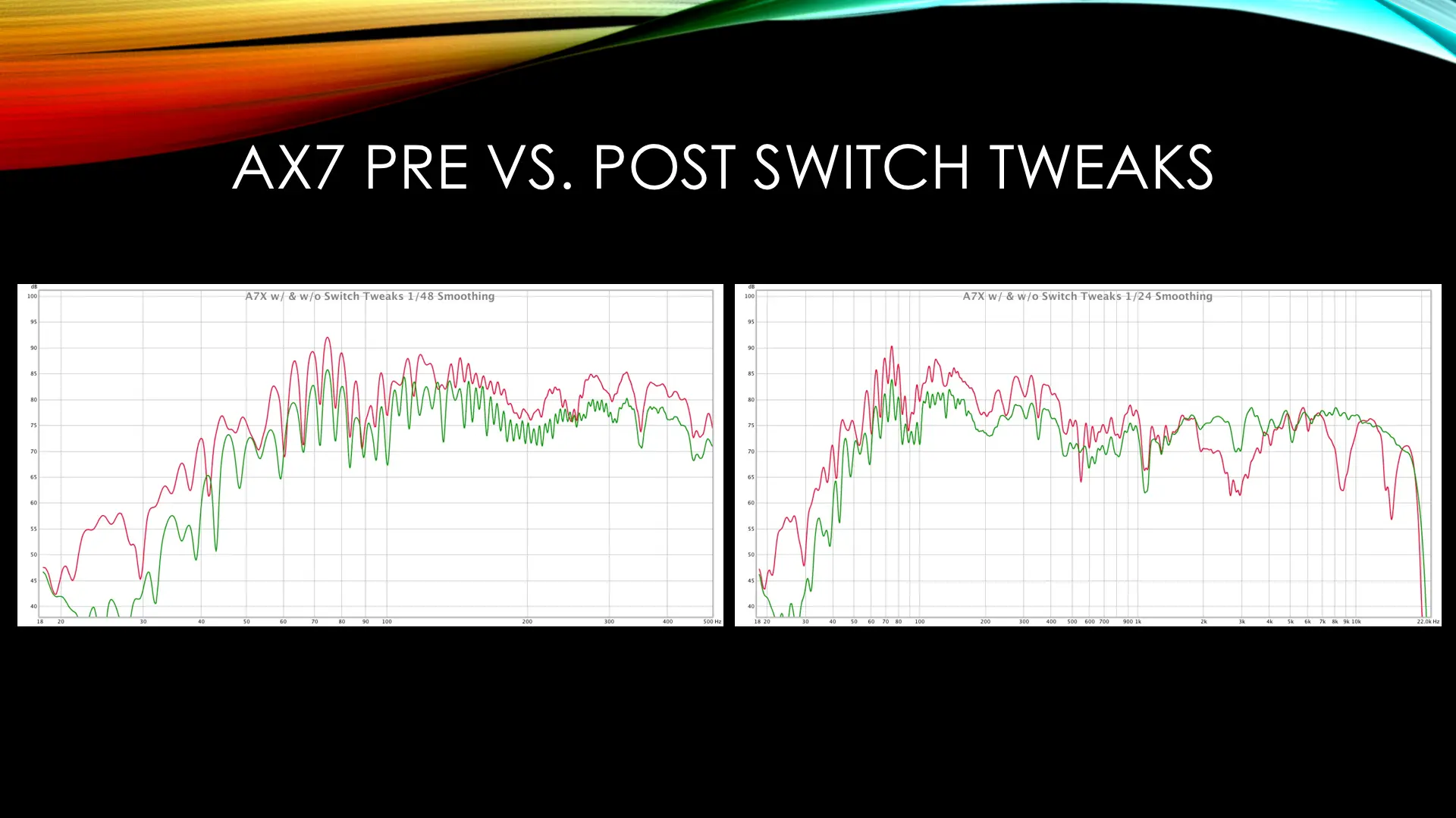

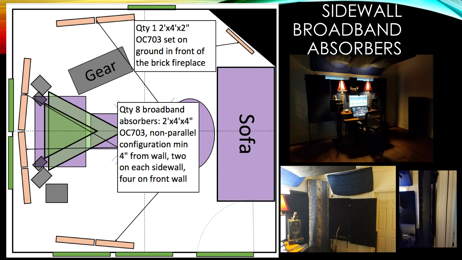

I posted this on John L Sayers Recording Studio Acoustics forum and got a wonderful response (as in the analysis was wonderful, the feedback was quite painful but it is what it is). I am also seeking other people's option so I am grateful to anyone that can offer (an educated) opinion.
I have been a guitar player and hobbyist producer for years, but I really want to be able to produce broadcast quality results of the songs I make for me and others, I guess we can say clients, in my own project studio. At long last, I have some really good, for me anyway, equipment built around a MBP, a UA Apollo with a couple of quad satellites, and a UA 4-710D. I also have a quite decent (I think) monitoring set-up with a Drawmer MC3.1, Adam AX7s, Yamaha HS5s, Avantone MixCubes, and a KRK 10S v2 sub (which I only use for spot checks or blowing the doors off). I run my speakers full range and the sub has a dedicated channel from the Drawmer. I have the cross-over set to 60Hz. What I am seeking now is the most accurate monitoring I can achieve within my constraints.

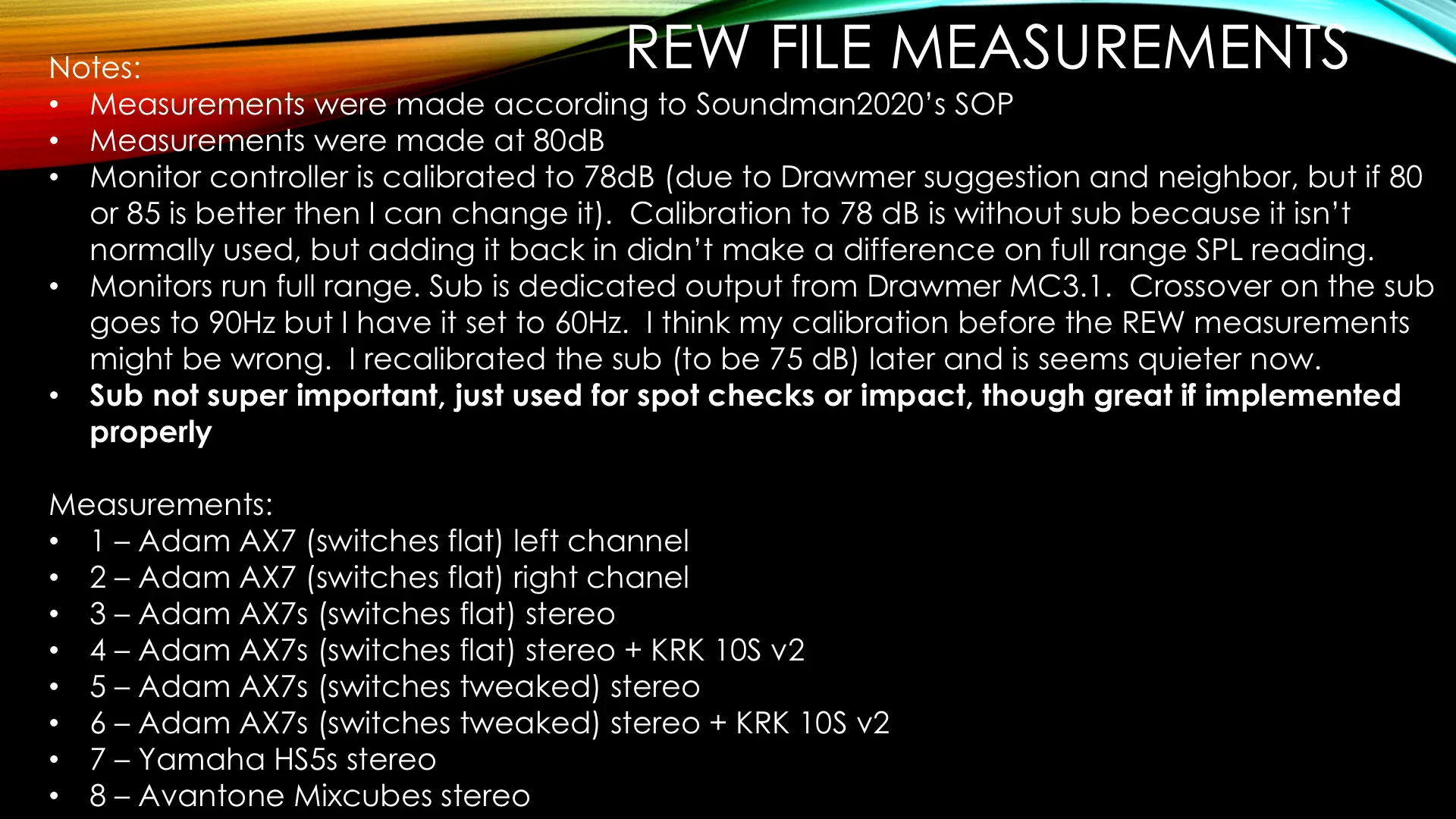

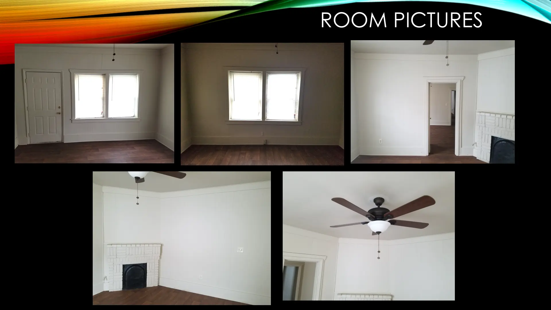

I rented a small duplex and have a 13'10"x13'10"x8'9" room with a hard floor (all of the details are in the subsequent slides). Clearly there are limitations with this small, somewhat cubic room. Also, as a renter, I can't make any structural changes. I spent a long time researching and planning the Acoustic Treatment, and ran the plans by some folks who said they looked good. I spent about $2,500, and a huge number of hours, designing, constructing and installing the treatment. When I took the REW measurements, I was quite bummed at the results. I’m seeking feedback on the design and results and any recommendations for improvements. Thanks in advance to anyone that can help me out.
Here is a link to full res slides, selected full res pics and the REW measurements. OK, I guess I can't post a link yet. I'll post a couple of full res.

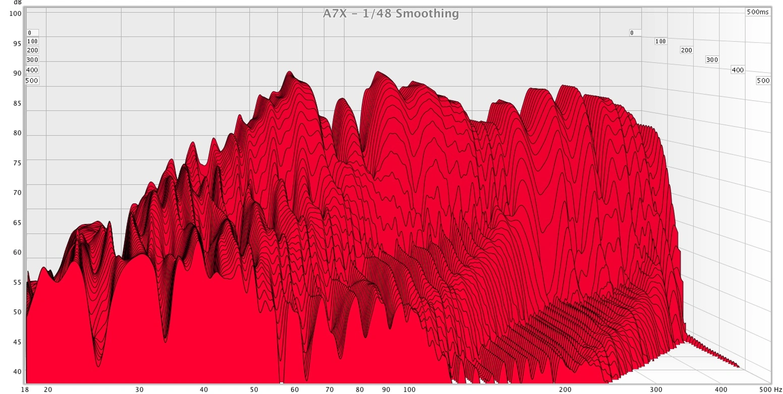

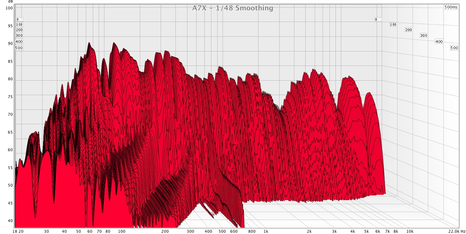

Loads of data - but what does it sound like that is 'wrong'?
Your question, is the answer. "but what does it sound like that is 'wrong"?. The OPs situation, is drastically reduced by what is called "Modes". There is some very hellish math behind his problem. When he plays his audio in the room, there are many frequencies that are wiped clean, this is do to the room size and that is where the "Modes" come into play.
Therefore, even if he had $20,000 dollar monitors, he will never hear the audio as it was recorded. He would be better off, putting on a set of high dollar cans to mix and then sub out the mastering. Since that is not his objective, he is pretty well screwed. You can't mix or master, what you can't hear. This is where the dead freqs come into play. All he will ever get is false examples of the audio he is playing. Please keep in mind that my reply is just the Readers Digest version on this subject.

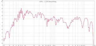

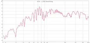

I don't see any measurements before you applied all that treatment....?
You should have done them first so you have some kind of reference to compare against once you start adding treatment.

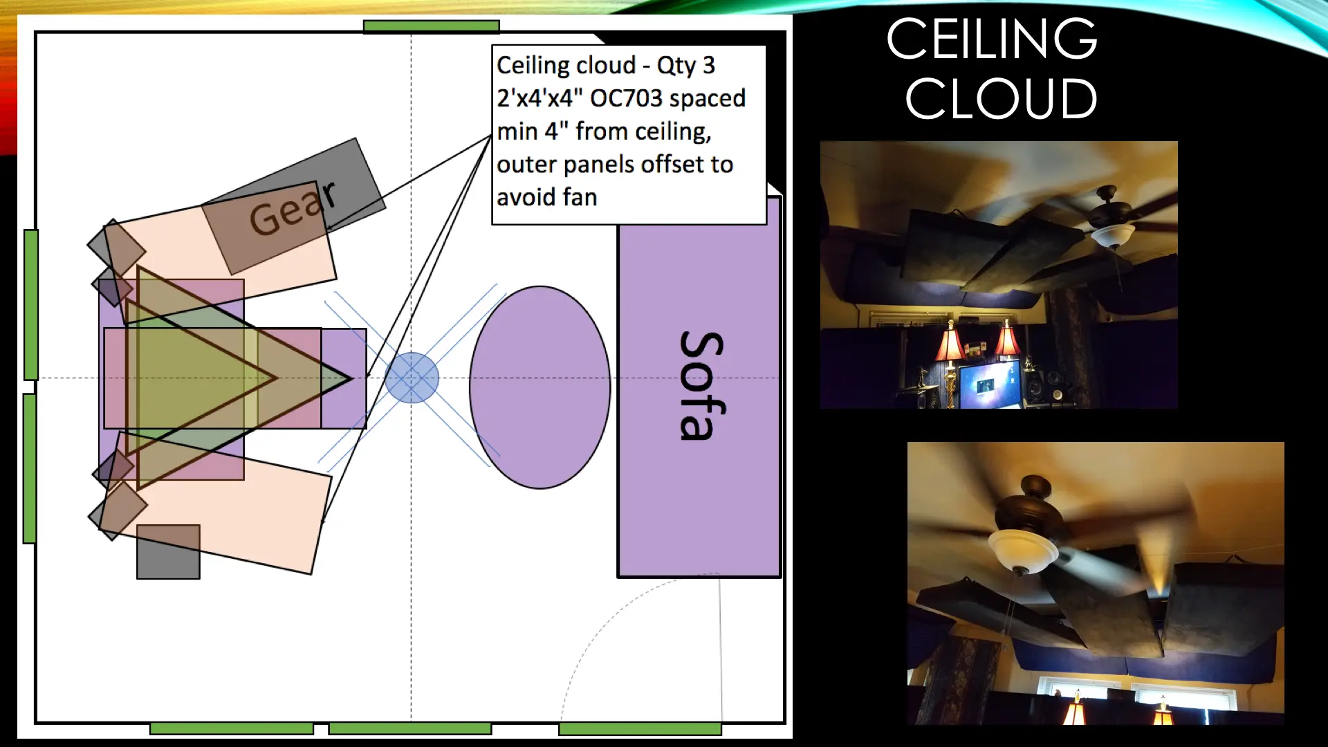

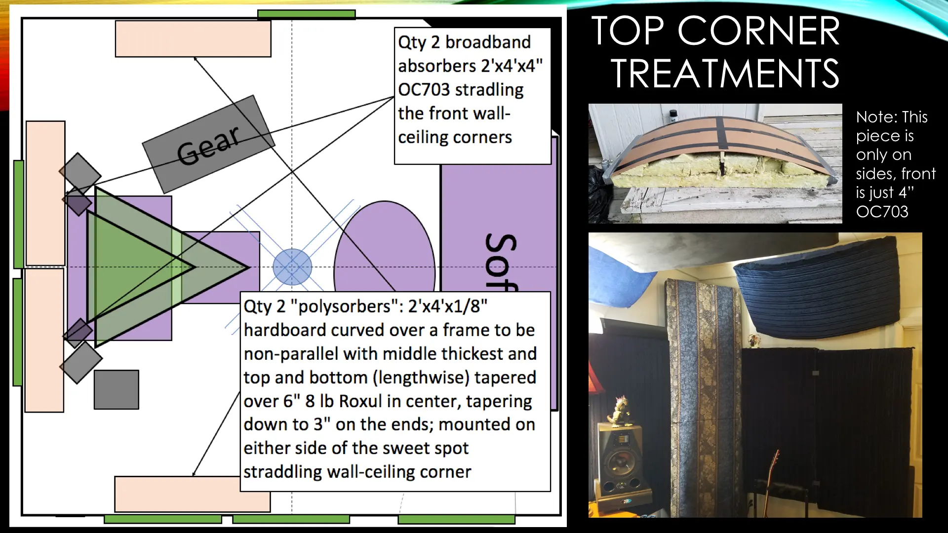

I also think you need more on the ceiling....or drop a rug on the floor.

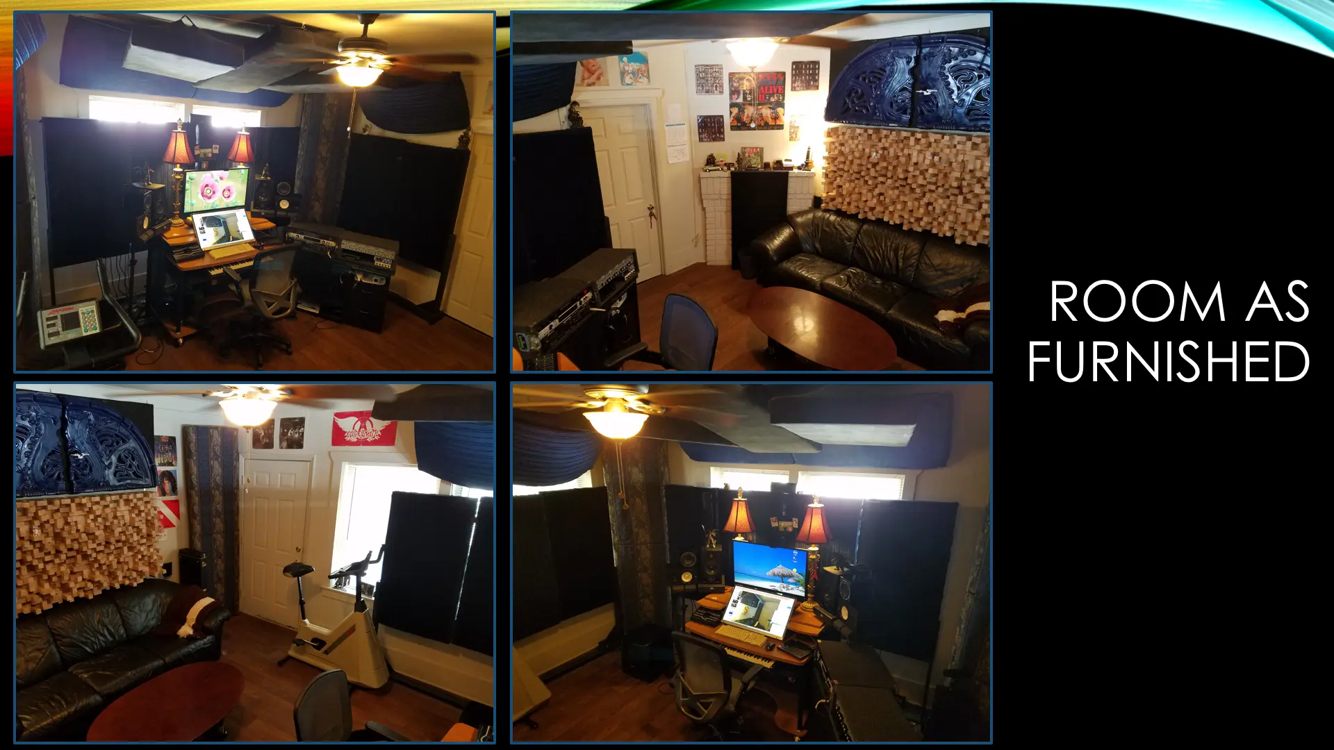

I would have turned it around, and put the mix position on the side where the fireplace is.

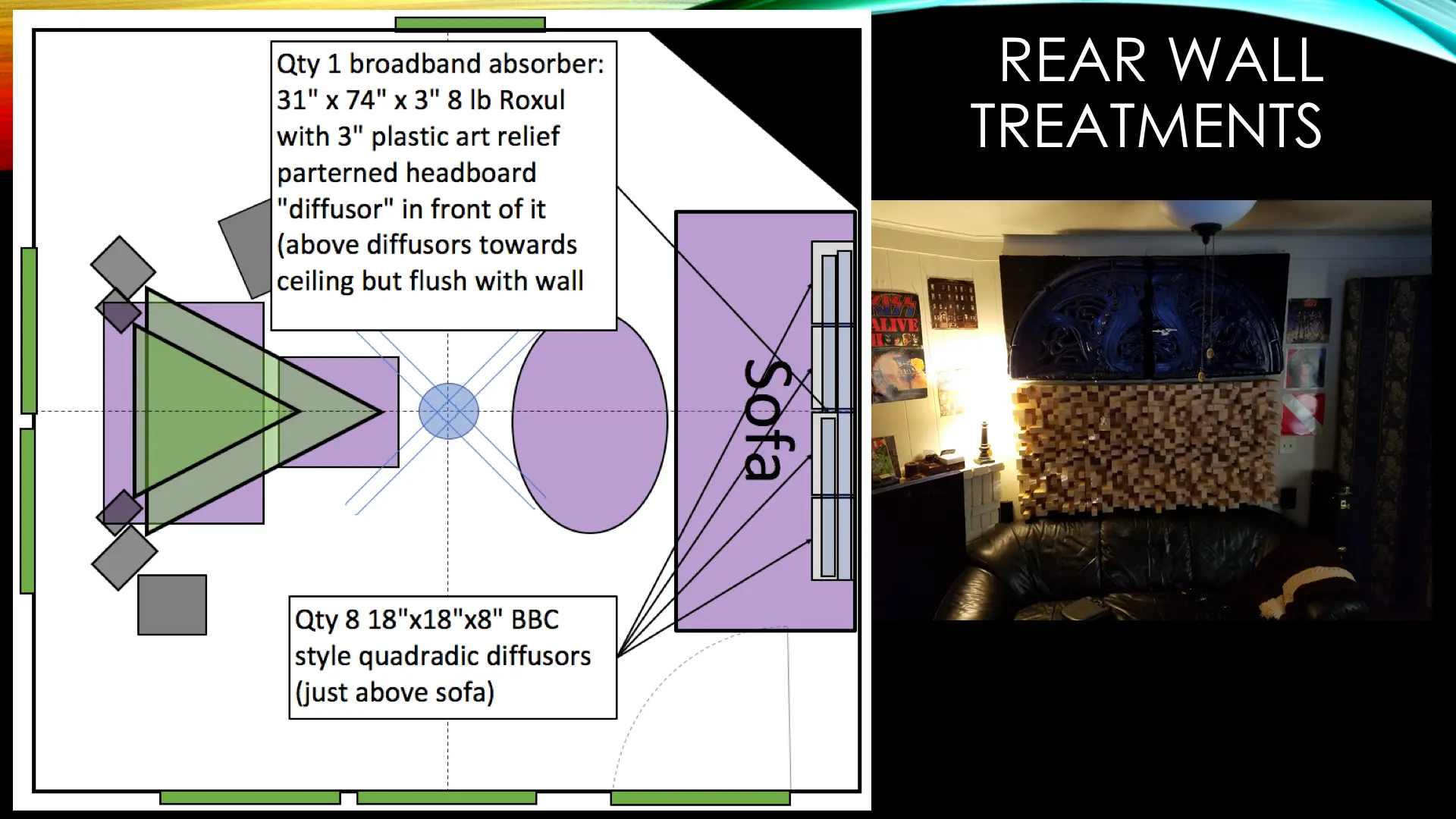

I would also have more trapping at the back wall, behind you...you have most of it on the front wall, behind the monitors.
Finally...if anyone expects to see flat responses post-treatment...:D...you're only fooling yourself.
You can run measurements even in some better studios, and you will see a lot of up/down points.
You will not be able to remove it all...without a ground-up studio build and pro design...BUT...that doesn't mean you have to mix with headphones, which bring their own issues, no matter how expensive they are.

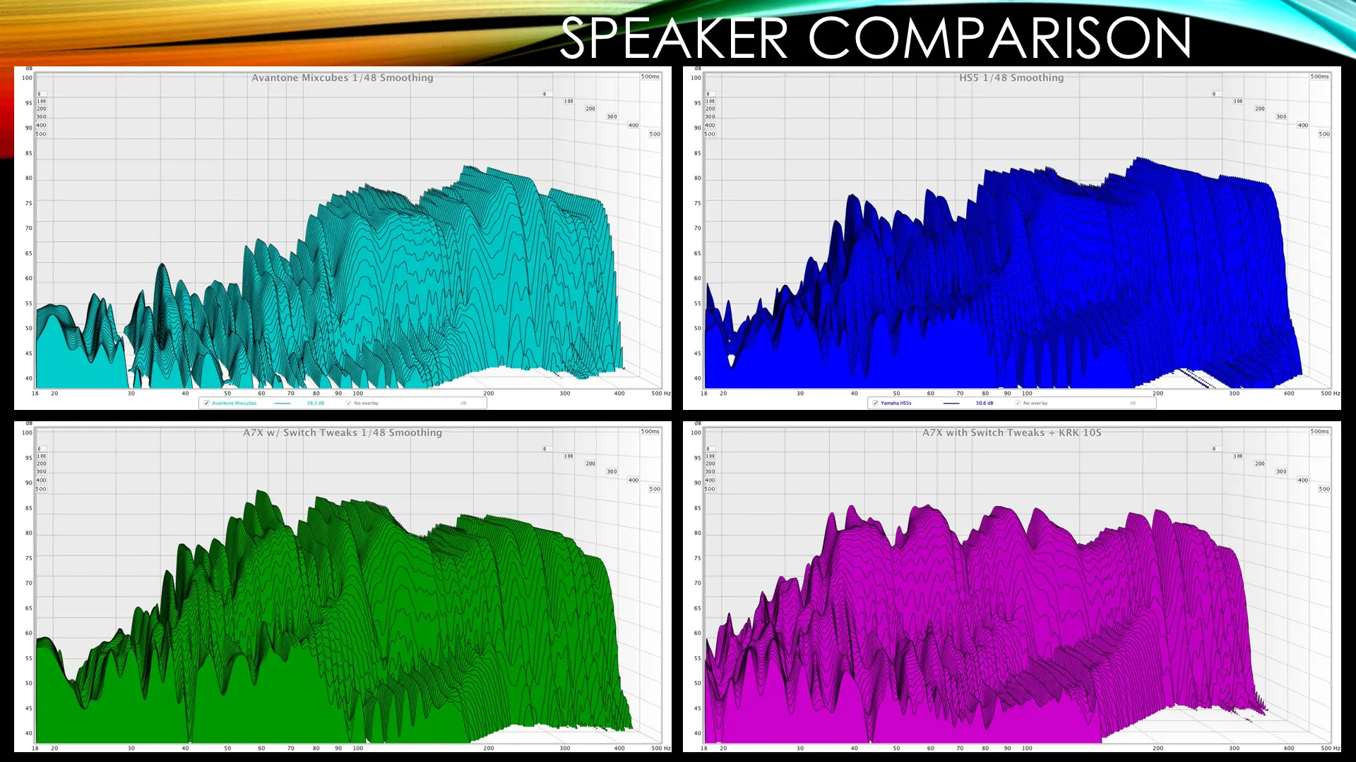

They key is translation...not waterfall renders and response curves. Those are there for you to get some idea what you have, and as you apply treatment, what changes...but in the end, if you can get a mix that translates well elsewhere, that's the important thing.

If you look at the pics the OP supplied, you will see all the information as well as the dimensions. Your are correct about doing this before you really knew what you are doing. But then again, my 20/20 hindsight is as good as any one elses. Regardless of what he does, he will never get professional results for monitoring. Its just math, not my opinion.

Yes, it is true. I didn't measure the room response before I started. I assumed that if I applied some "basic principles" the result would be reasonable given the practical constraints of the room. That was Soundman2020's instruction...remove everything in the room except the speakers and measure the room. It is also true that I used a Behringer ECM8000 and Radio Shack SPL meter to do the test which they don't advise on that forum.

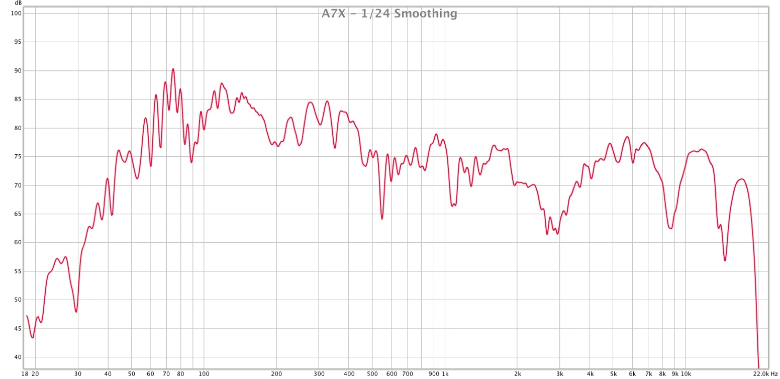

If your room is artificially cutting 300hz to 400hz, and 800hz to 900hz, then as you listen and if you have trained your ear, you will be inclined to maybe boost those areas. Well, now it sounds great to you and if someone else listens to your audio in a room other than where you mixed the audio, those freqs are going to jump off the page at them. It was my last sentence that I could not wrap my head around. My line of thinking was, "no duh, everyone will be listening in a different room and when they plug in their ear buds, the room is taken out of the equation completely". This process is really just to help you get the flattest response that can be achieved to avoid your room/ears playing tricks on you.
Doing it before you applied any treatment would have not benefited you whatsoever. In fact, it would have probably driven you crazy. I have the same mic and meter you do and I took my advice from the people who developed the program, not soundmans. I nicknamed him "Chewy" due to the fact that every time we conversed, that's what he did to my 6.
I actually have Sennheiser HD650's and AKG K702's so I have some excellent headphones. But that does take a lot of the fun out of it, plus I find them fatiguing after a while.
I hear ya Brother, but all is not lost. I have a friend who runs sound over in DC for all their big shin digs and I was talking about your situation as well as my own, since we are both really in the same boat. (Boat = Bust Out Another Thousand". This is what he recommended and I hope I can explain it to you, like he did for me. Just so you know, I have about a tenth of the experience he does but I felt much better after he said he uses the same mic you and I own.
By doing the test you did, you should have the frequencies that are effected by your room. Simply build your custom eq to either cut or boost them, depending on your data. As you are mixing, place that eq on your master track. When you do your play back, listen through your mons and than do the same thing using your cans. Then turn the eq on and off as you listen, and see if you can tell the difference between the two.
Since 99% of his gigs are live, he said the first thing he does is run the same test you did for every venue. Then he will build his eq according to the test results and then transfers it over to his mixer as well. He did say that this process will not give you 100% "Pro" results, but he did assure me that it will provide a much better mix, then if you did nothing at all. I hope this makes sense to you and honestly, I still have many questions concerning this whole process as well. I am simply explaining what little bit of knowledge that was given to me.
I agree that setting up on one of the walls with the fireplace would have been better - right now the back of the room is extremely assymmetrical. Also didn't say anything about a ceiling cloud.

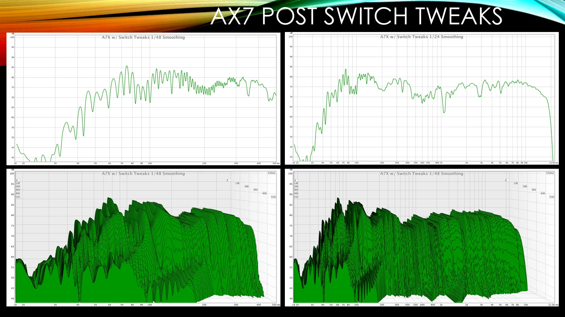

Look at slide #4.
That would block the doors.

I don't disagree that the less deep peaks/nulls your room has, the better...my point is that no one listens to music like that.
When you do a measurement, you're running a frequency sweep of individual frequencies, basically one at a time.
So of course, the measurement is made of those individual frequencies during the sweep, and you end up with the plot showing the nulls and peaks.
No one hears music in that manner, and no one really makes mixing decisions in that manner. We hear everything at the same time. IOW...when we listen to music, we don't really hear individual frequencies or zoom in on them unless the nulls/peaks really stick out. That's why I said you should focus on the big nulls/peaks...but trying to attain some kind of flat room response before you feel the space is valid for mixing, will be probably a never-ending quest.
Look for the deep/wide nulls/peaks...the lesser stuff is either masked or balanced out by the adjoining frequency bands pulling in the opposite direction, and for the smaller stuff, your hearing "fills in the blanks" to a degree.
I'm just saying that you treat to a point, and then you learn the room. That's what they do even in the bigger, "pro" studios. Once you get to a good translation stage...then the room response is no longer a concern.
It's like the pros who insisted on using crappy Yamaha NS10 monitors...they learned them, and after that, the shitty frequency response of the NS10 monitors didn't matter any more.
I'm really sorry guys, but I see so many people chasing their tales, especially using ease in venues. They wander around waving their mics, making odd noises and producing wonderful graphs, waterfall plots and determine that this wrong, that is wrong and to cure it we need to do this, and that, and usually spend money. Many are very old listed buildings and then the people come in, and the acoustics change and suddenly get hugely better. The Victorian architects didn't have prediction and measurement software, just ears and experience.
What I meant with my glib comment about what does it sound like is that what it sounds like often argues with what it looks like!
Does the room sound dull or bright, obviously heavy at the bottom or missing the bottom totally - does it sound just dull, or have peculiar nodes where the sound changes with just a bit of ear movement. I always listen to every space I work in, and my ears tell me what it's likely to need to tame it. If you see a small room with parallel walls and surfaces that are hard you know it's going to sound boxy - I looked at all those wonderful plots and just thought that I had no idea what it sounds like. I cannot (what is the audio version of visualise?) imagine what it sounds from those. Confused? Yep, unbalanced, unfocussed, weird stereo image as the response clearly changes with frequency - but I have no idea if I could live with it.
