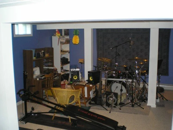

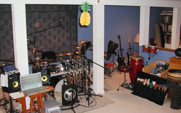

So, while I'm home from college for the summers, I pretty much have the basement to myself for recording. I have my drum set and all of my other instruments and recording gear down there. I have a setup right now that works but apparently is quite prone to frequency nodes. I was informed by another forum member that it seems as if I am in a null spot. Keep in mind, I'm completely new to this concept.
I can't really do anything as far as permanent sound treatment goes but I'm hoping to get some advice on the best way to setup my mixing setup as well as do a bit of sound treatment to at least diminish the effect of these frequency nodes.
I've attached several pictures of my basment space.
Any suggestions that will help me improve things are appreciated. I'm willing to do research, take steps, test things. As most people, I don't have much of a budget, so any improvised methods are greatly appreciated.
Thanks for any help you can provide!

That's a nice space. I would probably take the drums from inside that area with the pillars and put them more central facing down the length of the room, and make a 'control area' at the other end. Though those pillars may be handy for sectioning off areas and creating makeshift booth that can be taken down relatively quickly. You should make yourself some bass traps and gobo's they are fairly easy to make and pretty cheap. They will definitely help you control the reflections of the room.

Okay, cool. I'm looking at some stands right now and will probably be investing. I was considering putting a bass trap in the far left corner (to the left of the drums) and moving my monitors and whatnot over there. Would mixing in the corner (stil a couple of feet from either wall) be a big "no no?"

get em up and spread out. as is you might as well be using a boombox for monitoring.

Your tweeters should be at ear level so unless you really slouch raise them! and moving them apart should help too.
Thanks for putting the snaps up. Nice set up. All the suugestions thus far are on the money so I won't add anything. I like the bass drumm mic set up - I've read a lot about it &, thanks to you, have now seen it. Creativity & tangental thinking is important.
