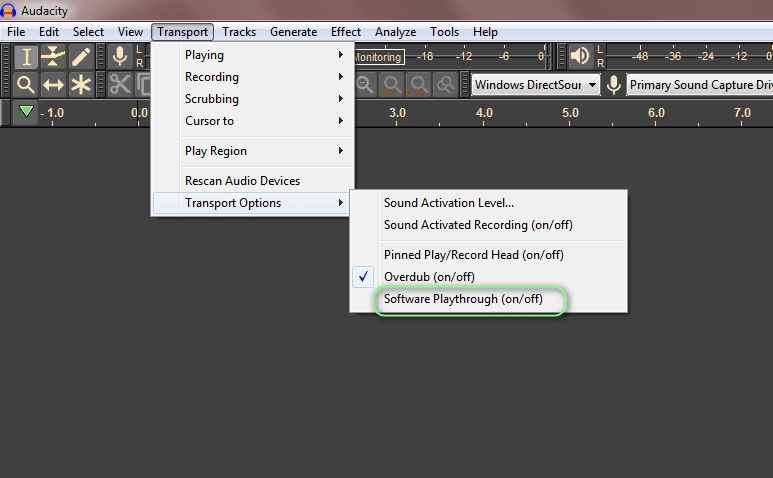

Experiencing latency(?)/echo/half a second delay, in recording from my scarlet to audacity for very basic voice over track. Have tweaked all pertinent knobs, please assist.

When Direct Monitoring is set to ON, ensure that your recording software is not set to route its input
(what you are currently recording) to its output. If it is, you will hear yourself “twice”, with one signal
audibly delayed as an echo.
Audacity can be set to route the input to the output from what I can recall. "Software Playthrough" I think it is and should be unchecked, but try unchecking 'Overdub' also if that is selected.
