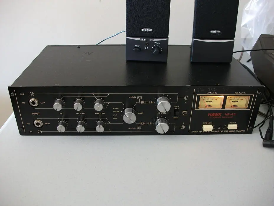

BTW, here's a photo (for those who like this sorta thing :D ). This was before I cleaned it up a bit. If you want more let me know and I'll post 'em.

Hey,
That looks pretty cool. It may be a ground loop, Does the power cord have two or three prongs. You could get a "hum eliminator" from Ebtech, to try out, that transformer isolates the input/output. Those are around $50-70 give or take, but it's worth having when you can't solve a problem otherwise. (I just followed Beck's link though and looks like the Behringer is about $40 or so)
It looks older, so caps ont eh PSU might be an issue too. I think we've all ruled out the minor voltage difference.
Yes I like that photo kind of thing!!!

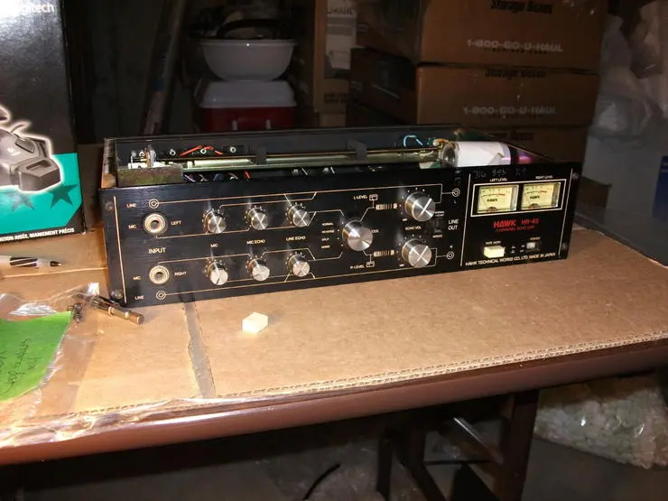

Well, then I'm including a few more just for you. :D ........ ;)

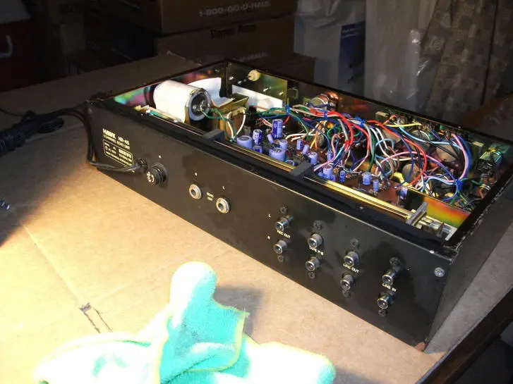

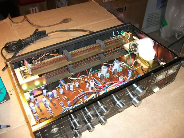

Thanks! It's a two prong cord. Yup, will def consider the hum eliminator but also take into consideration the PSU caps tho...... See that large capacitor on the right? The original owner said his tech added it to reduce hum, as he said the stock power supply was "under powered". Not sure what he meant or did but that's what he said.
Yup, not worried about the voltage issue anymore.
The unit itself is as common as winter in July. Hardly any info on it. It's built real well tho. All metal, even the knobs. Real VU meters. Lots of features, even a mic preamp. Never seen a spring verb like this. Hard to date it but looks late 70's to early 80's.

Interesting about that psu mod. The trafo looks decent enough, not sure what he meant by "underpowered."
Looks like the circuit board on the right is a pretty conventional power supply, you might see what it is putting out (maybe +/1 12 v ??) and consider replacing the psu, plenty of room in that box, or at least swapping it out and see if it makes a difference.
